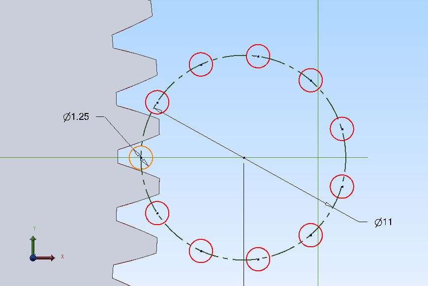

      Another question about gears. Will a lantern pinion work with a spur gear? If so, what would be an appropriate diameter for the pins in an 11 tooth lantern gear to mesh with a 147 tooth spur gear – module 1? I assume the pins would be on a pcd of 11 mm.

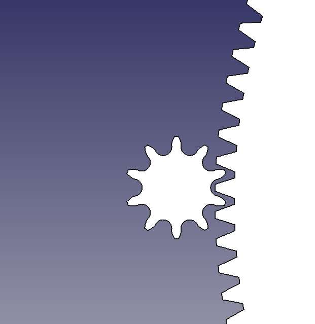

            Drawing the gears in CAD to see the mesh suggests the answer is yes, only just, and might not be good enough. (To save time the example is drawn with a spur gear.  Readers should imagine the 10 toothed gear’s teeth replaced with round pins.  This is only an example.)
            Screenshot from 2025-03-24 07-39-49

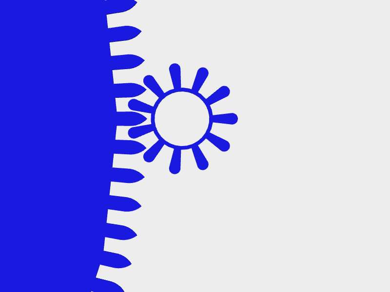

            John Haine
              @johnhaine32865
              download
              Here’s another image from this website: https://hessmer.org/gears/CycloidalGearBuilder.html for cycloidal gears.
              Generated for your specific parameters.  You can see that the max width of the pinion teeth must be a bit less than a third of the circumferential pitch which is 3.14 mm, so a bit less than 1 mm.
              This is a useful site – you can download the profiles as dxf so they can be imported into CAM to generate g-code – I used CamBam.

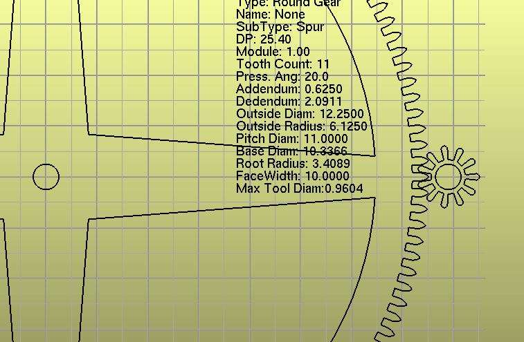

              #790249
                I don’t have a licence for Gearotic so can’t import the file but using one created in the site linked to by John above and overlaying the data from Gearotic I get  apin of 1.25mm on 11mm PCD
                Take the OD and PCD from Gearotic
                lantern 2
                And draw them (orange) over the top of the DXF from Hessmer(red)
                lantern 1
                Hopefully the OP’s requirement is drive in one direction as there looks to be a lot of backlash – gaps in the Hessmer one whereas Gearotic has no noticable gaps, though Gearotic does Epicycloidal

                                      Addressing the original question, It looks like a similar 1.25mm dia pin would work with a spur gear.
                                      spur lantern
                                      #790387

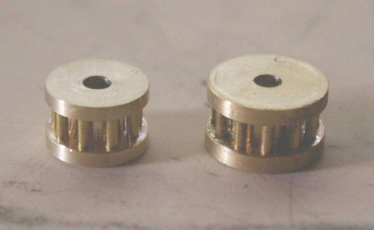

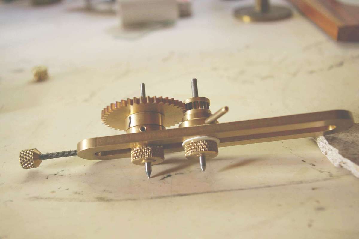

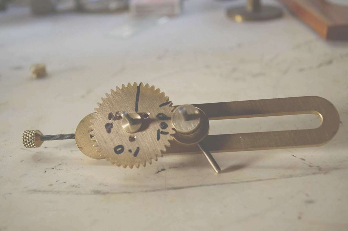

                                                  #795475
                                                  Alan Charleston
                                                    @alancharleston78882
                                                    Hi,

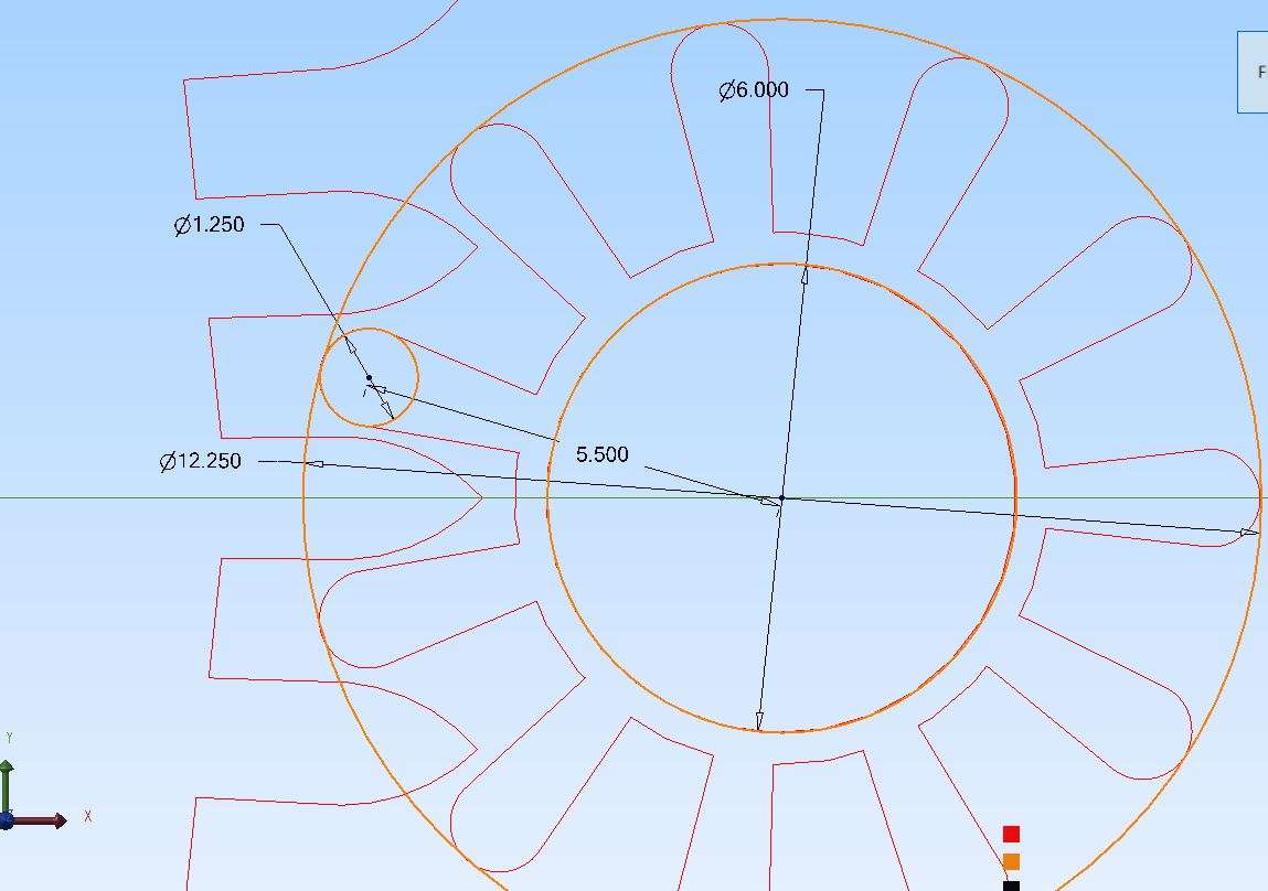

                                                    I’ve finally got round to making a couple of lantern pinions to see if they will mesh with standard spur gears. I started with an 11 pin pinion. The pcd of the pins for an 11 tooth 1 module pinion is 11mm. As the addendum on a module1 gear is 1 mm. I made the diameter of the centre of the spool 8.5mm which allows 0.25mm clearance for the tip of the gear. Jason recommended a 1.25mm pin diameter but the closest I had was some 1.4mm diameter brass rod (wire?) so i used that. I installed the pinion and a 42 tooth spur gear into my depthing tool and reduced the distance between them until they just started to bind then backed off slightly. They meshed very well and rotated smoothly. The distance between the pinion and the gear ended up within 0.1mm from the theoretical value of 26.5mm. An 11 tooth pinion is only 1 tooth less than the smallest gear that can be cut using a standard set of cutters, so I then made a 9 pin lantern pinion with similar results.
                                                    It seems therefore that lantern pinions can be used in conjunction with standard spur gears.
                                                    Regards,
                                                    Alan C.Lantern5Lantern6Lantern7
