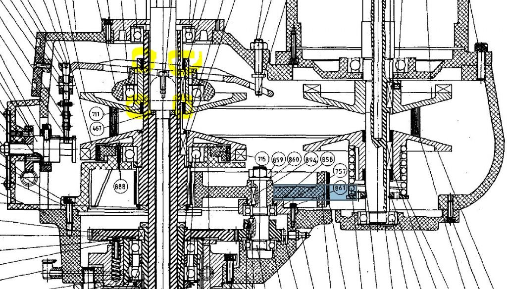

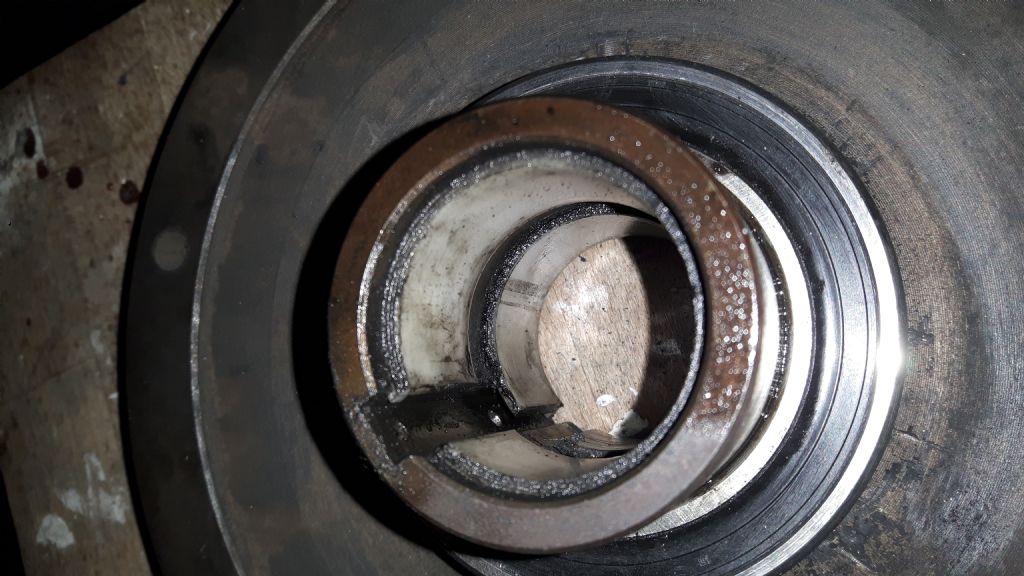

        I've dismantled the head of my Pinacle Excel turret Mill, which is another clone of a varispeed KRV2000 to locate the source of the steadily growing noises within.
        As expected I find that the bushes in the spindle sliding pulley are wornout and there is a small "scuff" on the shaft opposite the keyway. There are two split "plastic" bushes 39mm od, 35mm bore and a plastic key. The motor sliding pulley and key seem fine

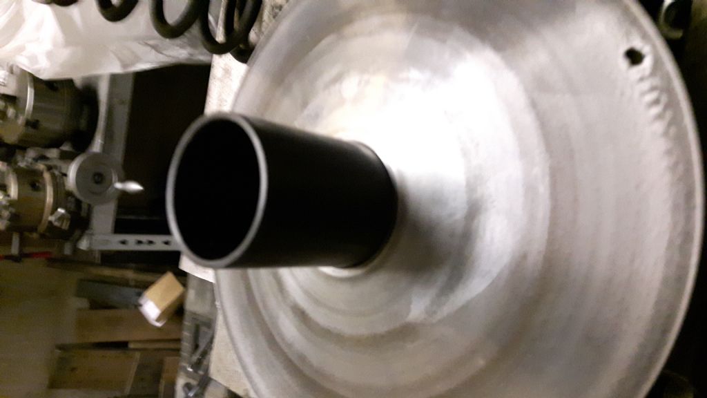

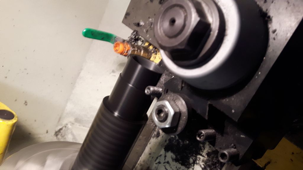

                        I've put it all back together last night, and she runs again, smileymuch smoother and heaps quieter… I also got a maybe another 1000 rpm by fitting a new belt; the old one was worn to 34mm high as opposed to 38mm…
                        I bought a piece of 2" acetal from ebay, and used a very positive rake CCGT 09T304 NF25 tool to cut the acetal, it was surprisingly easy to machine and get a great finish; though as Clive said you have to wait a few seconds for it to cool down before final measuring. Made both bushes from a 6" length + one scrap one which I broke when sawing out the keyway.Keys were a couple of bits of Brass as that's what the manufacters now supply.. All glued together with loctite 638 after several de-greasings
                        It had the advantage that I could make the bushes and keys to the current size of the shafts,and longer to spanover the "scuff" on the pulley shaft; i was worried that fitting manufacturers bushes to the worn shafts would lead to accelerated failure of the new bushes.
                        I gained some experience in working with acetal and probably spent a day making/fitting bushes and keys; the rest was another day or two strip down, cleaning and lubricating the whole machine.
