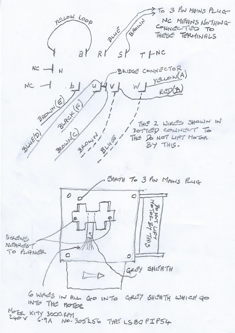

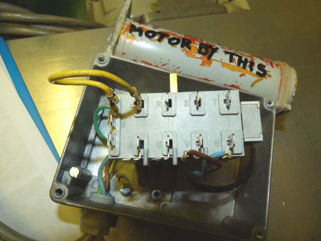

      I’ve just got around to having another look at changing the switch on the Kity Machine.
      I’ve stripped the switch down a little further but I’m still not sure what the wires connect to inside the motor case or how they should connect to a DOL starter with overload protection.
      I’ve lettered the wires so if all else fails at least I can connect them back onto the existing switch and continue to use it as original.

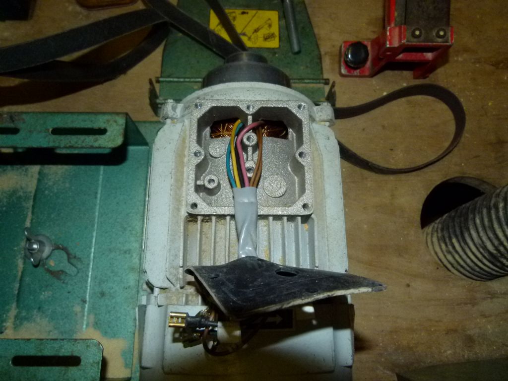

      There are six wires going into the motor casing, namely the
      Yellow (A)
      Red (B)
      Brown (C)
      Blue (D)
      Brown (E)
      Black (F)
      As shown on my sketch.
      Does anyone have any ideas on how the wires should be connected to a DOL starter working off the pictures and the wiring sketch?
      Thanks to anyone who can help

              Clive are you happy to try things ? I realise that some dont like high voltage messing about.
              But if you can try this and report back
              remove the switch completely
              connect the earth from the plug to the motor
              connect the live (brown) to red(b) and the brown going to the capacitor (dont lift by this)
              connect the neutral (blue) to blue (d) black (f) and brown (c)
              connect the blue from the capacitor to yellow (a)
              insulate the brown (e) not sure what this does as yet
              then try plugging in the motor should run
              report back if it does or doesnt
              Ian

                    the original switch (a unistop ) is a strange one (isnt everything french) and as standard it has a NVR function built in which is why Clive wants to change it so he can start and stop the motor and spinning blades remotely
                    Theres internal wiring in it to the a and b terminals and where the yellow loop wire is
                    Clive it will blow the fuse or trip mcb/rcd if theres a major fault
                    but just plug it in for a few seconds to see if it starts first
                    Edited By Ian Parkin on 28/01/2020 19:22:28

                                  When switched of does your machine stop quickly or slow down slowly.
                                  Puzzle 6 wires going into the motor 2 May be Start windings Centrifugal changes this to Run windings .
                                  Further 2 May reverse the motor rotation when switched of to act as brake to stop motor.
                                  If we knew the Ohms readings on these Possible 3 sets of windings if theyare the case lots of questions and answers may start to make some sence.
                                  Yes a Scematic wireing diagram would provide all of the answers , at the moment we are all trying to find the correct answer.

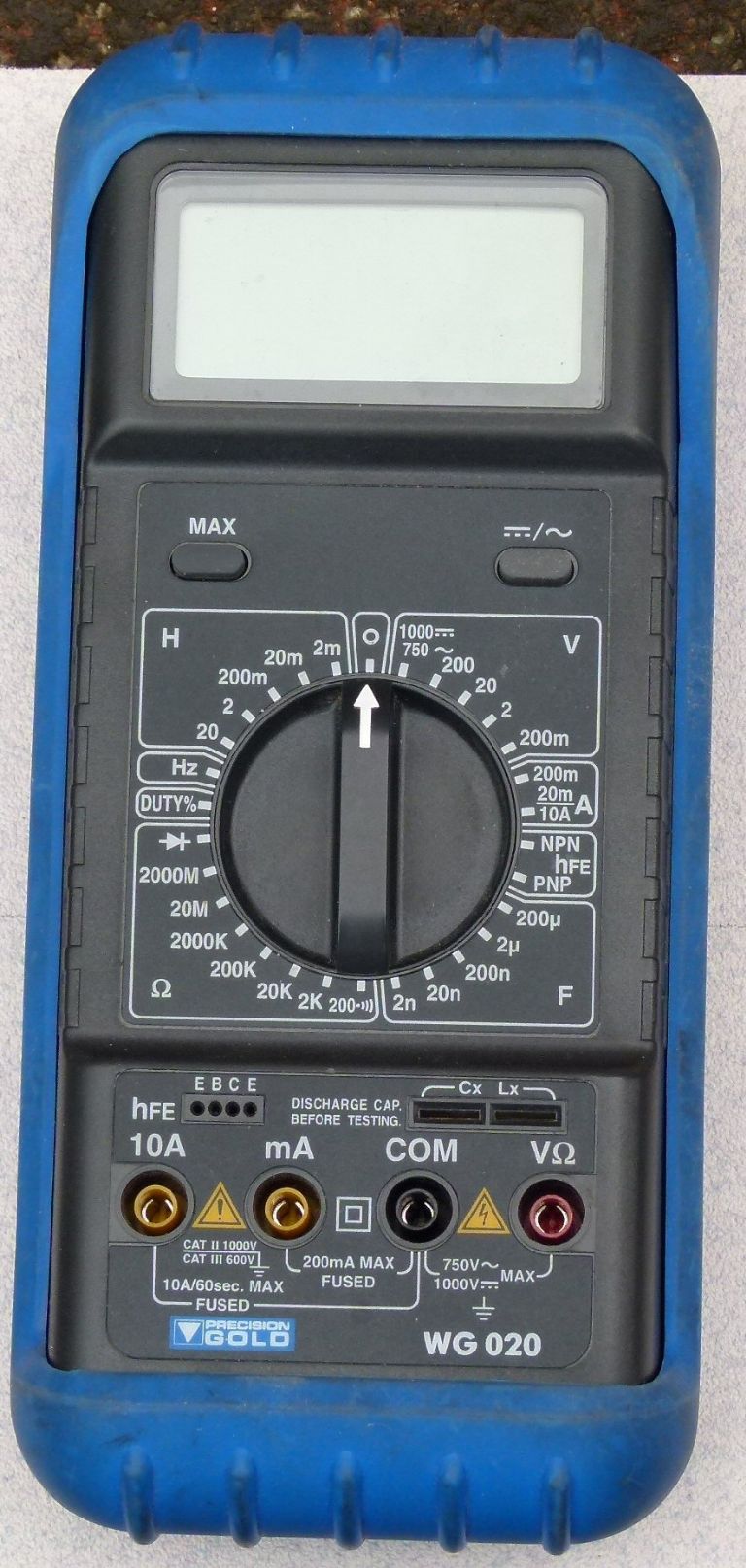

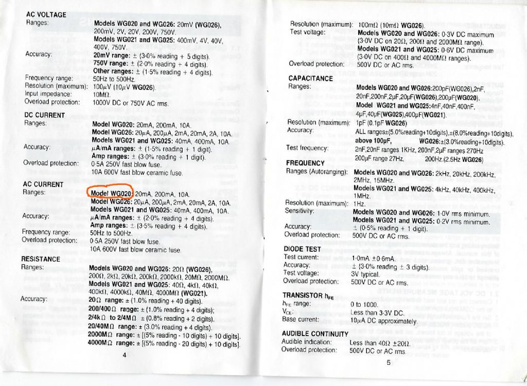

                                        No, I don’t hear a click from the capacitor now but when the old switch was connected to the motor yes there was a click after switch off.
                                        I do have a multimeter but have to admit I’ve only used it for doing bits of continuity checks on the car.
                                        I’ve included a picture of it to give you an idea of what it’s like.
                                        If I do have to do tests on the wires is there any better way of joining them together because at the moment, I haven’t cut the spade connectors off and they are only held together with electrical tape so not exactly the tightest of connections.
                                        I left the spades on just in case I end up having refit the old switch.

                                            I think you will need a clamp type meter to read the current as its likely to be drawing perhaps 30 amps on start up for 1/2 a second
                                            I was at a place of work yesterday and the owner was complaining that his saw bench was blowing fuses when cold
                                            on checking my meter was showing readings of 50-60 amps for an instant before settling to 11 amps so not surprising it was blowing 13 amp fuses.. so i wired it to a 16amp plug and put a socket direct to fuse board with a 20 amp mcb
                                            anyway back to your problem clive
                                            The click i was wanting you to listen for was from the motor itself not the capacitor..
                                            the click you heard with the original switch was probably the coil in the switch dropping out.
                                            If you cant lay your hands on a ac ammeter i dont really know what to suggest.
