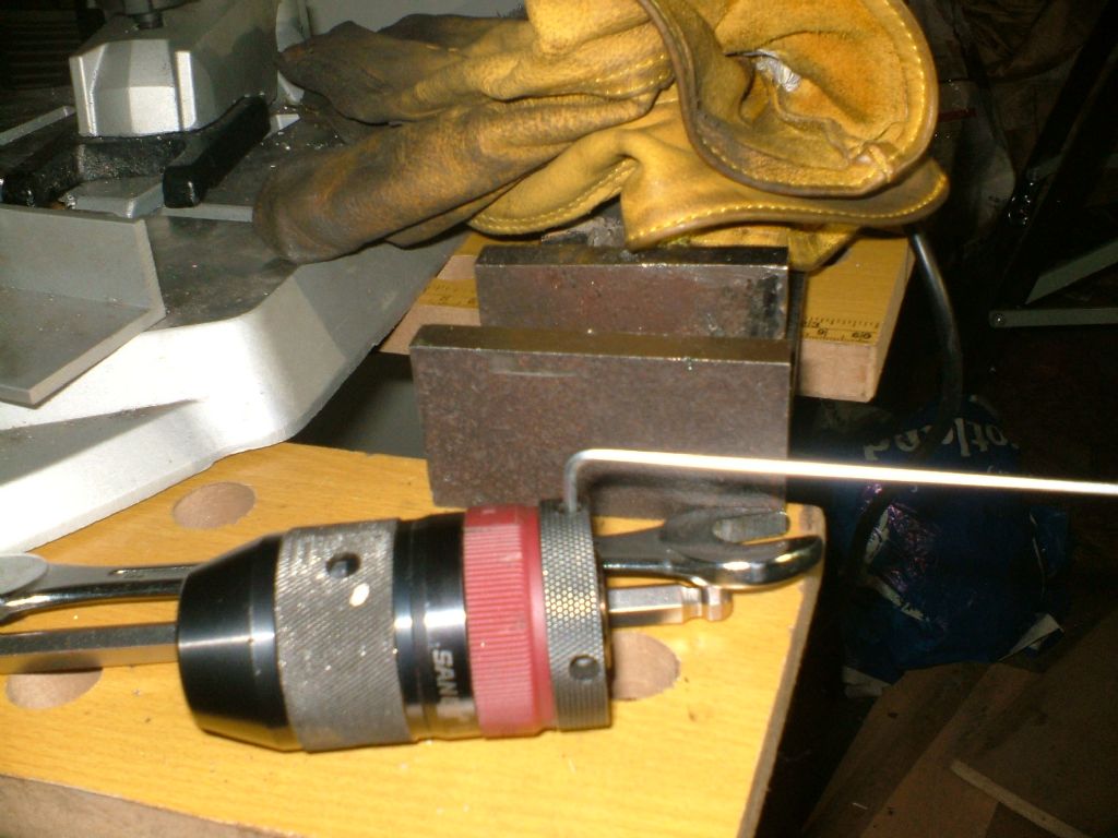

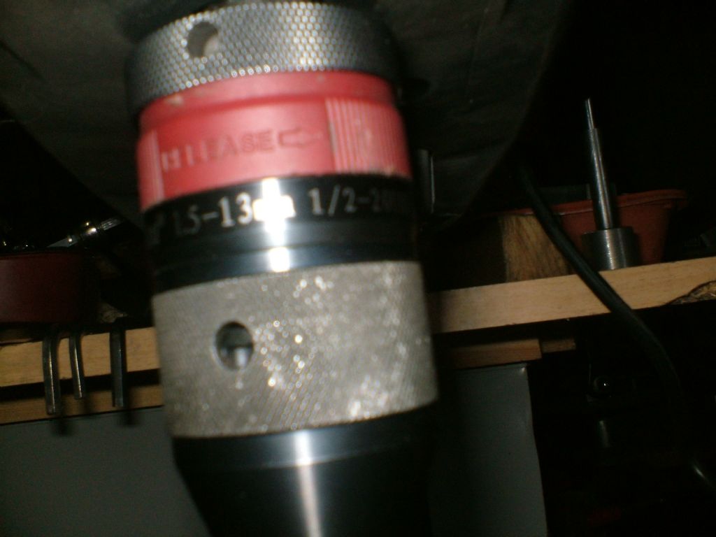

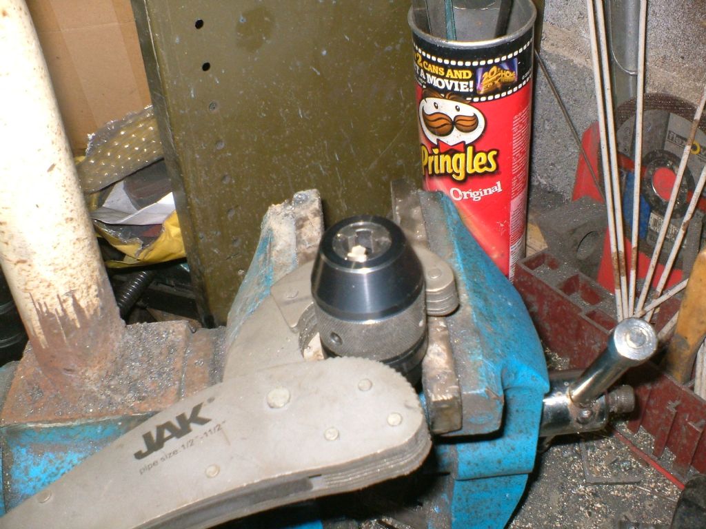

      I have a cheapo drill with quite a nice keyless chuck but it has a lot of runout (which some are mistakenly calling bearing issues) so I decided to take a peek
      If you haven't done one before they can be a bit of a mystery, a proper rohm will set you back 100+ but these chinese knock offs are probably made for a fraction of the cost

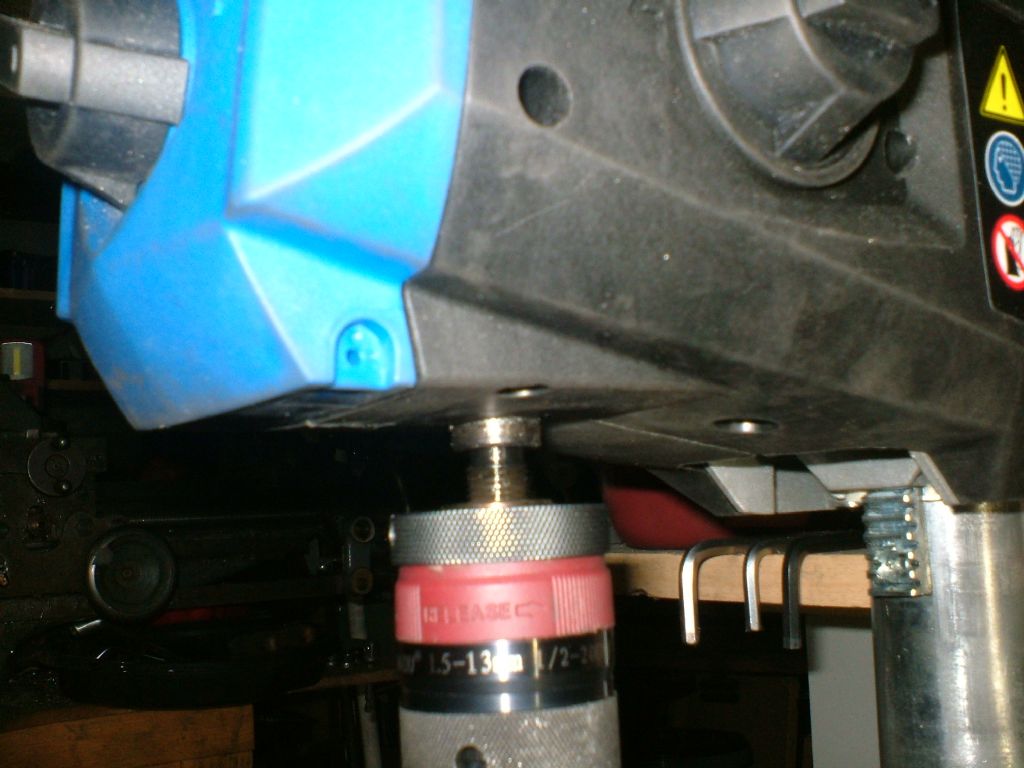

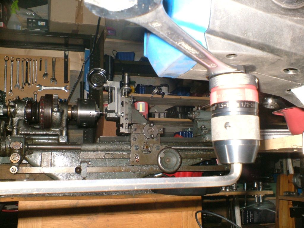

      They screw on with a right hand thread and can be unscrewed as below
      You need quite a thin spanner to get at the drill spindle

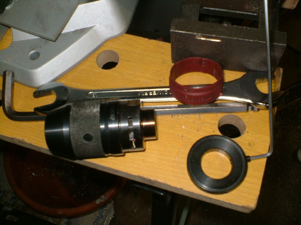

      Then do the back collar, a hex grub screw in this case
      and the plastic bit pops off with encouragement

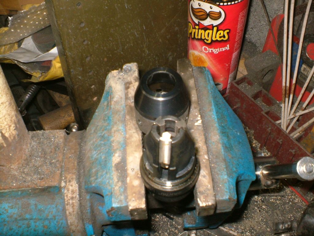

      Getting the hood off can only be done one way, with the hood UP
      I tried with the hood in the vice and the vice pressure basically locks the hood to the main body
      So this way only

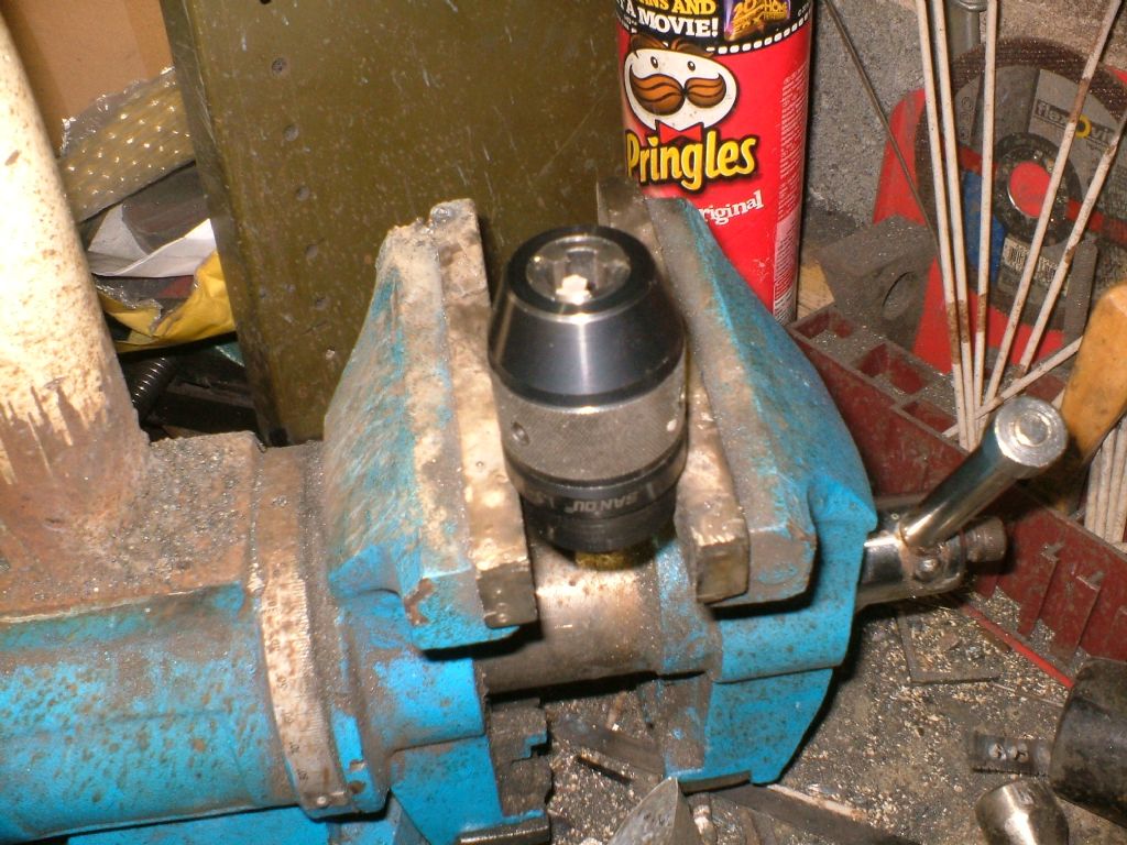

      There were flats already on the rear body so it went into the vice
      and something for the hood
      and it cracked straight off, some loctite had been used during assembly

          The rest of it is pulls apart with your fingers over a clean towel
          There should be at least 25 loose bearings, mine had 23 and the jaw support cage is hard plastic

            Please sir (unrelated question) what is the lathe visible in the second picture? I have a Pools '38 Special that is very similar in appearance that someone gave me a lifetime ago (in pieces) which I rebuilt on the firms time & capable of punching well above its weight to this day (read many years later) came with faceplate,4" 4 jaw & all its change gears, I only learned recently that it was the only one supplied with a countershaft by them

              Posted by robjon44 on 21/03/2021 10:49:18:
              BobH
              In Ady's absence I can tell you its a Drummond M-Type of late 1920s to1930s or so vintage. Myford took over making them for the WD in about 1940 and fitted the V belt pulleys seen on Ady's. Looks like it might even be the coveted long bed version but cant quite see because of that drill getting in the way in the pic.sure Ady will be along to tell you more.

                It's a shortbed M series and my workshop pal
