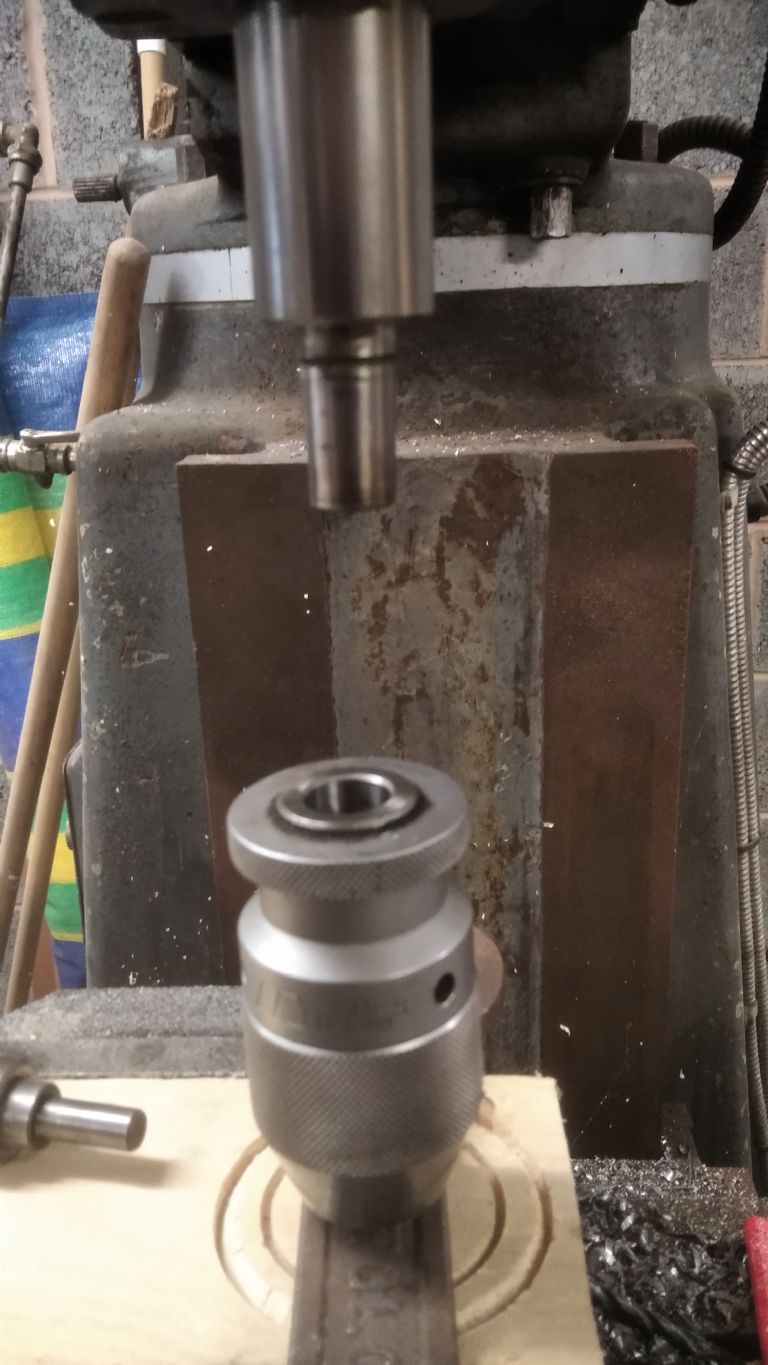

      How do you reliably reattach a keyless chuck to its adaptor taper?
      It came apart and doesn't firm up using pressure from the quill on a millting machine. I could use a fly-press but wondering if I'm missing something?
      Any ideas?

          Warm the chuck up with an electric hot air gun, until it's uncomfortable to hold, make sure both surfaces on properly clean, put a block of wood on the drill table, with the Jaws wound all the way back out the way, do this before you start, use the quill handle to press it together, not excessively.
          Edit, when I say warm, direct the heat down the inner taper.

            First check the tapers mate fully, no burrs or dirt. To fit I always separate the adaptor, place it in the female part and strike it on the wood bench so that the mass of the chuck travels down onto the taper.

              The best thing I can do is clean the tapers with IPA or acetone and heat the chuck up in the oven to 50-90C. Then bring the two together again.
              If that doesn't work it's the freezer for the adaptor too!

                      I first gave everything a good clean. I left the chuck in an oven ~100C and the adaptor (a combination of a MT30 to Morse taper to the chuck taper) in a freezer for a couple of hours.
                      Held them in pace with a flypress and allowed the temperature to normalise.
                      I can't see them coming apart very quickly and have just used it successfully.
