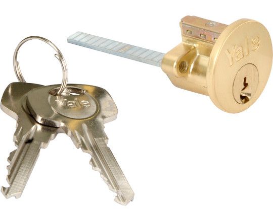

          Why not just buy a new cylinder and keys. If the keys are that worn the cylinder probably is just as worn.
          £10.00 or thereabouts plenty of places on-line, this pic from ToolStation
          (Of course I am assuming it is the type illustrated and not a mortice lock! In fact a new mortice lock is only £25 from ScrewFix, why compromise on security. )

                It may be a lever lock, but to me looks more like a pin-type cylinder lock.
                If so, there are two basic types.
                In the first, as I think this is, when the key is inserted fully in the cylinder whose tail operates the bolt, each tooth and gap moves a pair of pins in a radial hole, to align the unconnected joint between them with the internal surfaces of the lock body and cylinder, allowing the latter to rotate with the key. The pin ends are rounded or chamfered to ease them across the edge of the hole.
                When the key is withdrawn, a spring above each pin pair returns the pins so one of each pair straddles the boundary, keying (in a shaft and wheel sense) the cylinder rigidly to the body.
                If I am right about the lock type here, examining the flat along the top of the lock may reveal the pressed-in sealing plugs that retain each spring and pin pair.

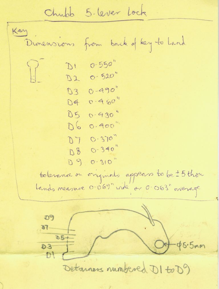

                                      I found my 1958 copy of the Encyclopaedia of Locksand Builders Hardware Published by Josiah Parkes & Sons Ltd, Union Works, Willenhall, England, and this is how to do it! I don't think I break any copyright laws by pasting a small section for private use, if I do, mods please delete it!key1.jpgkey2.jpg
                                      #519060
                                      Georgineer
                                        @georgineer
                                        I worked on Chubb 5-lever locks for a local, and very large, church in the 1980s. I still have my technical notes somewhere, but from recollection there were seven different levers available (I don't think they're actually called levers) and they differed by 0.015" from each other. I can dig the notes out if anybody thinks it would be helpful. I agree with what has been said about cleaning the lock and lubricating it with powdered graphite. If it has seen this much use, it deserves some love and attention. The Chubb lock also has a rotating part that you actually insert the key in, and these wear badly and let the key drop. I found that replacing that part would bring several troublesome keys back into operation.
                                        Because I had so many locks and keys to deal with I made a Perspex cover plate for the lock body, which allowed me to see in detail where problems lay within.
                                        George B.

                                                  Georgineer
                                                    @georgineer
                                                    Posted by Michael Gilligan on 11/01/2021 12:36:40:
                                                    Posted by Georgineer on 11/01/2021 11:07:15:
                                                    […]Yes please, George yes
                                                    Here you are, Michael. They were my working notes, not intended for others to understand, but I think they contain the information you want.
                                                    There were nine different detainers (not seven as I misremembered), each with a notch in the leading edge. They were called D1 to D9 by Chubb, so I was able to purchase them by that name. I didn't take any measurements off the detainers as they were mainly used as supplied. When I needed to add a notch for a master key, I laid the appropriate detainer on top, marked the new notch and filed it out.  The hole was probably designed as 7/32".
                                                    The key measurements were taken from new or known good ones. My comments about the lands may need explaining a bit. The key has nine lands for the five detainers – one in the middle and four outwards in each direction, so the key can operate the lock from either side. The average width of these is 0.063", which gives a nominal key width of 0.567". Where a land is cut deeper than its neighbours it needs to have a bit more width to prevent adjoining detainers from snagging , so the width I measured for the deepest lands was 0.069", the extra 6 thou being taken equally from its taller neighbours. Not easy to explain in words – I hope it's clear.
                                                    It was quite an installation – sixteen different locks, thirty-plus keyholders for the entrance door, and two levels of master key all to be maintained and kept track of. Fortunately I knew the locksmith well, and he trusted me to cut my own keys on his key-cutter!
