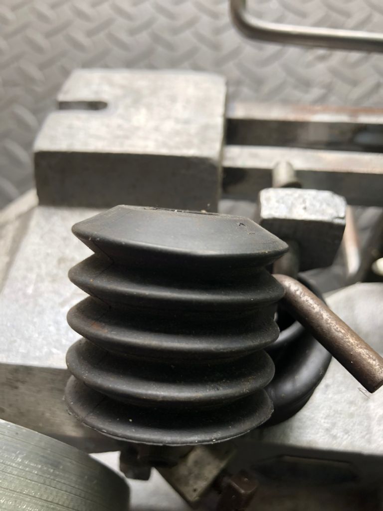

      A Kennedy hacksaw in need of some TLC has found it's way into my possession recently! I've read the threads I've found on here as it needs a replacement spring and damper adjusting rod.
      My question for other owners is where they've found suitable replacements for the rubber gaiter? The closest I've found are for generic motorbike shocks; they all seem to be quite long and don't have the narrow neck, which I assume helps keep the oil in the pot.
      Thanks

          Jamie, odd you should post that, mine split last week.
          Rather than motorcycle fork gaiters, I was thinking car steering arm gaiters or maybe car shock absorber gaiters.
          Some of the latter fit over the chrome piston rod at one end, rather than the larger washer.

            The gaiters from car steering racks would be suitable.

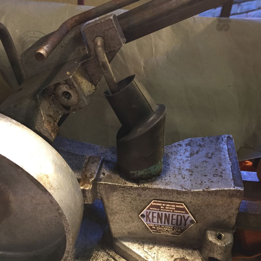

                        The gaiter can go over the tube though most photos do not show one. It doesn't fully seal as there are 2 rods going through it
                        You can use car engine oil, just half fill the tube, that works on my 90.

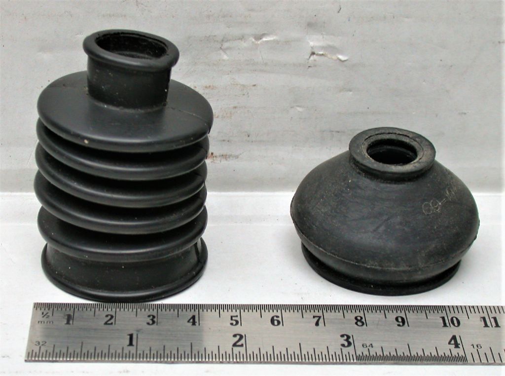

                          img_0399.jpgPhoto's of gaiter fitted to saw and spare one I found, img_0398.jpg which would be suitable, is from a clutch slave cylinder.

                                      Pic of gaiter I have used as a replacement on Kennedy No 6 hacksaw. The one on the left is the original, (someone seems to have cut the top off Chris' one.) The one on the right is a track rod end boot, which I got from a car accessory shop.
                                      I don't think the gaiter needs to be a concertina type, as its main function is to keep muck out of the damper pot, and the top of the original was not secured to the rods that pass through it, so the boot will do this and can be secured to the top of the oil pot with thin wire if you don't have a skinny "Jubilee" clip.

                                          Whilst cleaning up the saw I had a brainwave about the gaiter – a section of cycle inner tube should do the job until something better turns up. I knew there was a reason I hung onto those old punctured tubes!

                                            Good idea Jamie . One of the more unusual drive belts I have seen on a Kennedy was made of two sections of inner tube put together contrarily and stretched over the pulleys. But this time the tube was from a truck. It worked well enough.
