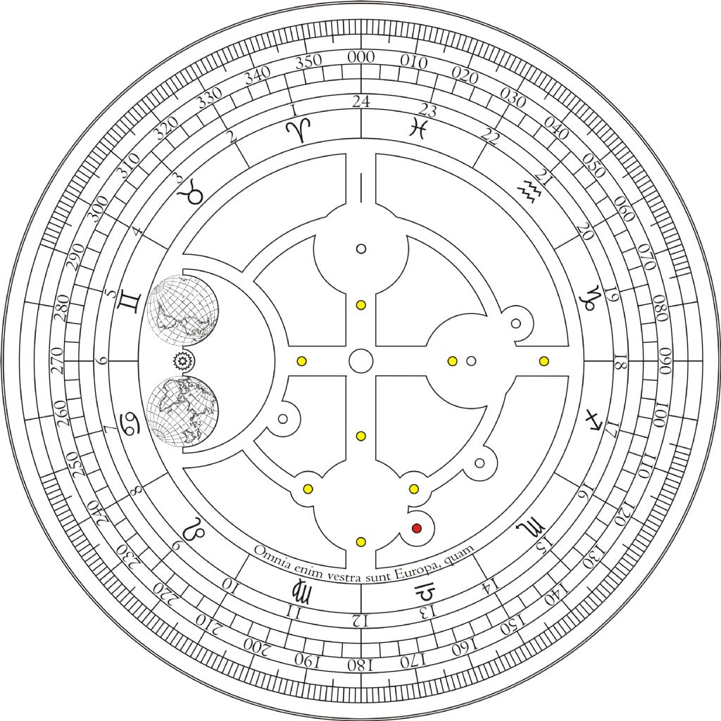

                I'm getting a bit nervous, that I've bitten off more than I can chew.
                Adding 15 more gears will give me four sub dials underneath the Jovilabe proper Jupiter rotation, lunar phase, sidereal time and UTC all to high levels of accuracy.
                The down side is (1) will the torque required burst it? and (2) this is about twice as complex as the Antikythera mechanism… gulp!
