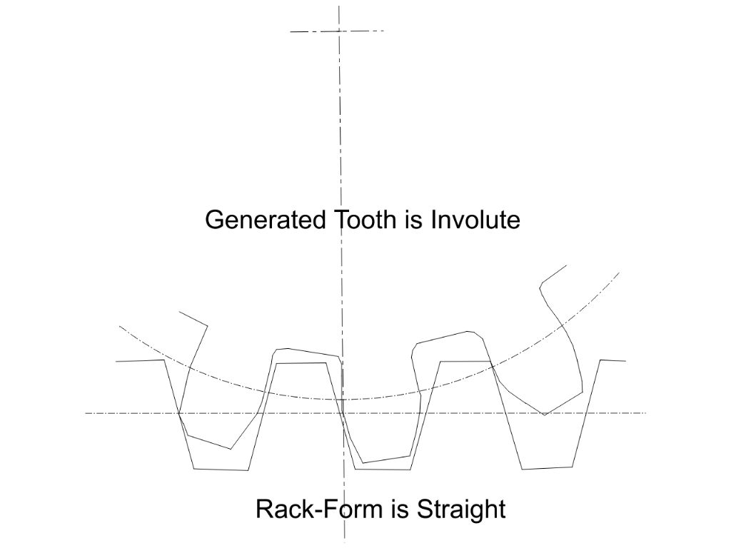

            Like Michael I'm having trouble understanding the detail of how the blank and rack-form cutter are moved to cut gears.
            I've got a 1950 book with a section on making gear wheels. It describes three 'formed-cutter' methods and three 'generating methods' for doing the job.
            As an aside, the book highlights the advantages of involute gears, which there is both a method for making them with a fast, continuous process well suited for mass production, and also another method (generation) that can cut the highly accurate tooth forms necessary for precision work. The book says that it is much more difficult, if not impossible, to generate cycloidal teeth. I mention this because I've not come across such a clear explanation for the dominance of involute system before.
            Anyway, the rack-form method looks to me like a variation of the "Sunderland gear-shaper" method in which a rack is driven sideways across the blank. At the top of the blank the cutter cuts to the full depth of the tooth, whilst at the sides it shapes part of the tooth form on the flanks.
            The bit I don't understand, and I think it's related to Michael's question, is my book stating "Between each cutting stroke of the tool the relative positions of the blank and the tool are changed to correspond to a small amount of rolling of the one pitch surface on the other." (This is different from periodically indexing the blank though 1 pitch so as to cut teeth around the full circumference of the blank, which is clear enough.) The movement is also different from the action of a hob-cutter, where the hob and blank both rotate. Unlike a rack, the hob is in the form of a screw.
            Hopefully a few photos with a short explanation might sort me out!
            Thanks,

              NO, because it's a rack form it just cuts a series of tooth spaces at a time, the blank rotates and each space gets between three and seven cuts, so each tooth has a series of facets. Anything at 20 or more teeth is perfectly servicable, certainly in small sizes.
              #259014
                Posted by SillyOldDuffer on 03/10/2016 12:44:15:
                Exactly like your rack, except its a circular cutter, no spiral.
                You can see in your picture that each pass will make three cuts on the gear
                Turn the gear by half a tooth and move the rack by half a tooth-spacing and you get another, different, three cuts. Make more and more cuts at slightly different settings and the shape rapidly approaches a true involute.
                All these are cut with just one pass, made with a 'rack' tooth at centre height to get a full depth space. The gears work fine so frankly I couldn't be bothered to take another set of cuts and double the chance of a cock-up.

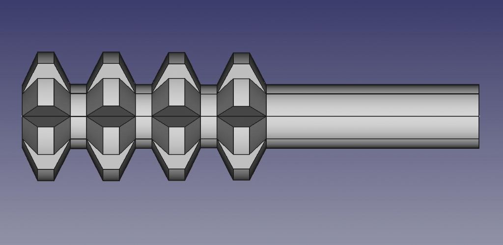

                  That makes sense. " Make more and more cuts at slightly different settings and the shape rapidly approaches a true involute."
                  Now I've 'got it', I've realised that it must be fairly obvious in practice to see what needs to be tweaked to improve the shape of the teeth, if anything.

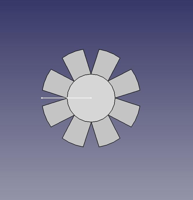

                  What does the rack cutter look like? Something as simple as this perhaps?  If I'm understanding correctly your earlier "Made out of silver steel using a simple cutter ground to the right angle on the end and then reduced to give the right shape, then cut a series of grooves."
                  Side View
                  Front View
                  If it's that easy I might give it a try!
                  Thanks,
                  Edited By SillyOldDuffer on 03/10/2016 15:51:32
                  Edited By SillyOldDuffer on 03/10/2016 15:58:14
                  #259026
                    Petty much, except only six flutes cut with the corner of an end mill to give a bit of front rake, and a rather fatter cutting section.
                    #259030
                      Many thanks Neil, specially for the fatter cutting section hint. You've saved me the 'fun' of discovering that a thin version of the rack will most likely bend.
                      Cheers,
                      #259040
                        Don't make it too fat, or you will get fed up of having to wind the work completely clear before rotating the blank
                        I went for 5/8" 1/2" would probably be OK although less allowance for resharpening.

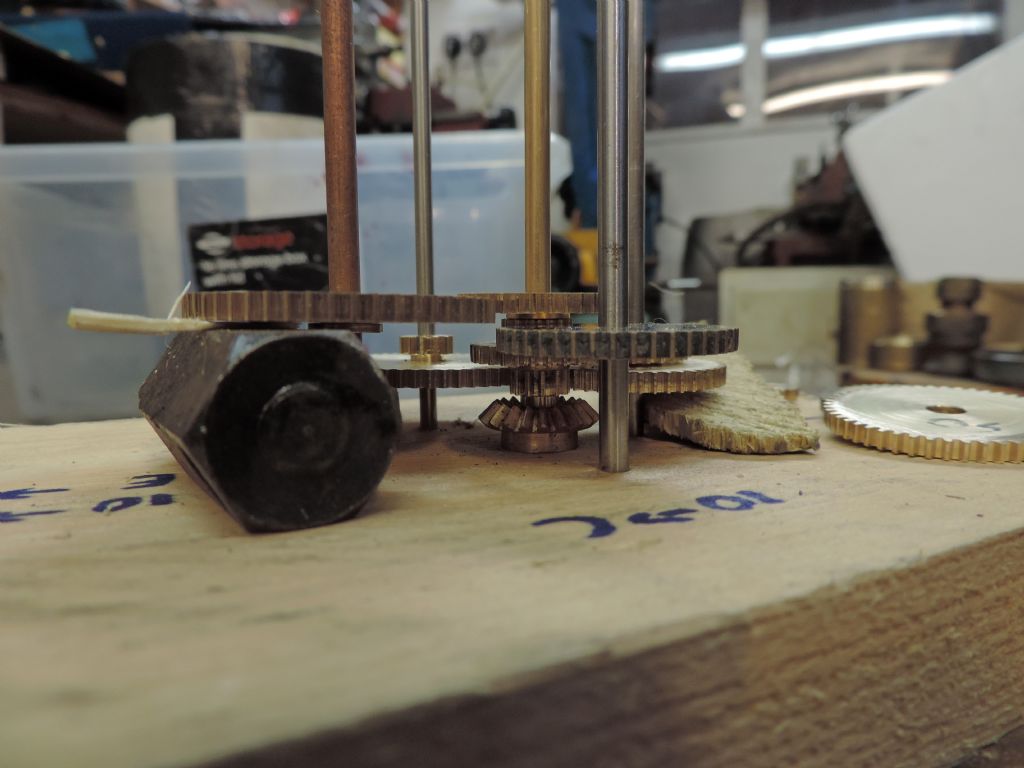

                        #260160

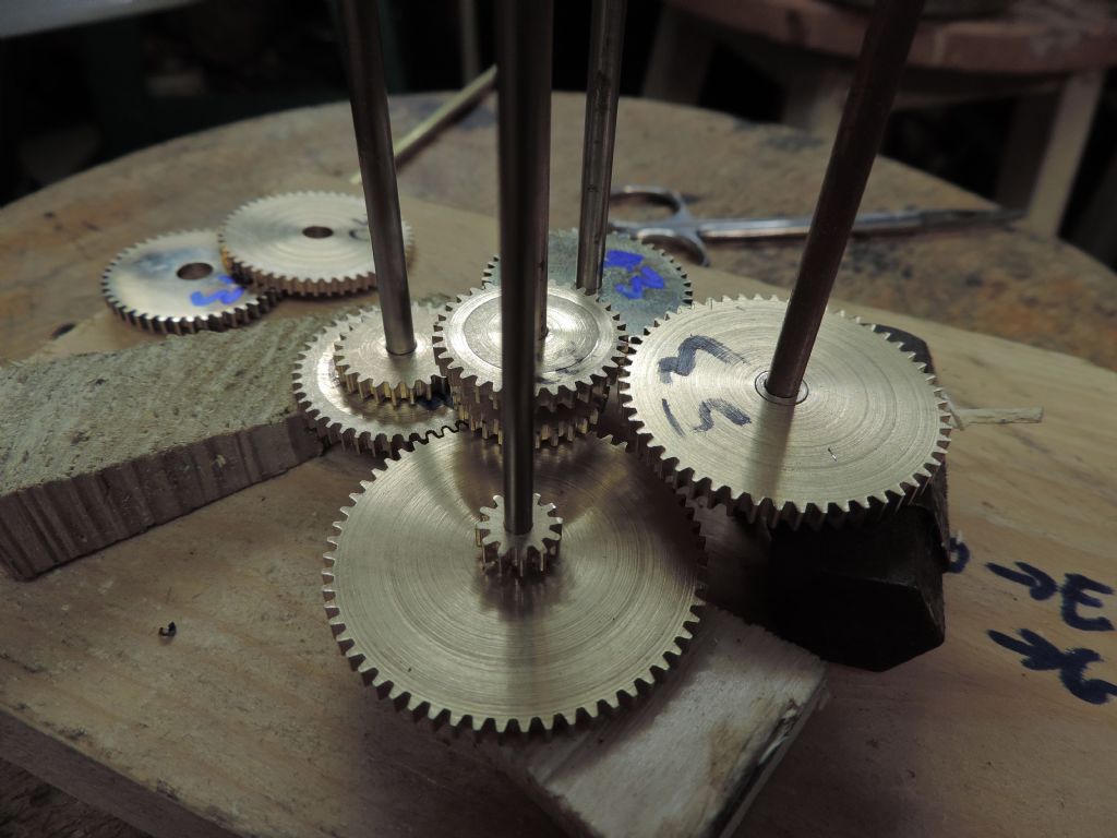

                          I think I have cut all the gears now, except the great big 344-tooth gear and two 30-tooth idlers for Callisto, so its drive can get around the 53-tooth gears for Ganymede and Europa (I'm driving Callisto from Io not Ganymede, don't ask why, I don't know – it just worked out like that).
                          I've done a quick mock up of the 'lower stage' – discovered I can drive two gears from the same 12T pinion BUT their spindles will need to be on opposite sides of the central spindle so the driven gears don't clash. Lots more spindles to add, mostly for the 'jupiter orbit' drive (six gears five pairs at 5:1 and one at 17:57) but also the Calisto idler.
                          This isn't for gear spacing, although it helps 'prove' the gear pairs, just to confirm the order and spot any clashes.
                          Obviously some spacers will be needed, not least for the bevel gear that receives the main drive from the stepper.
                          Well, it;'s more fun than brain training and probably twice as effective
                          Next – the upper level

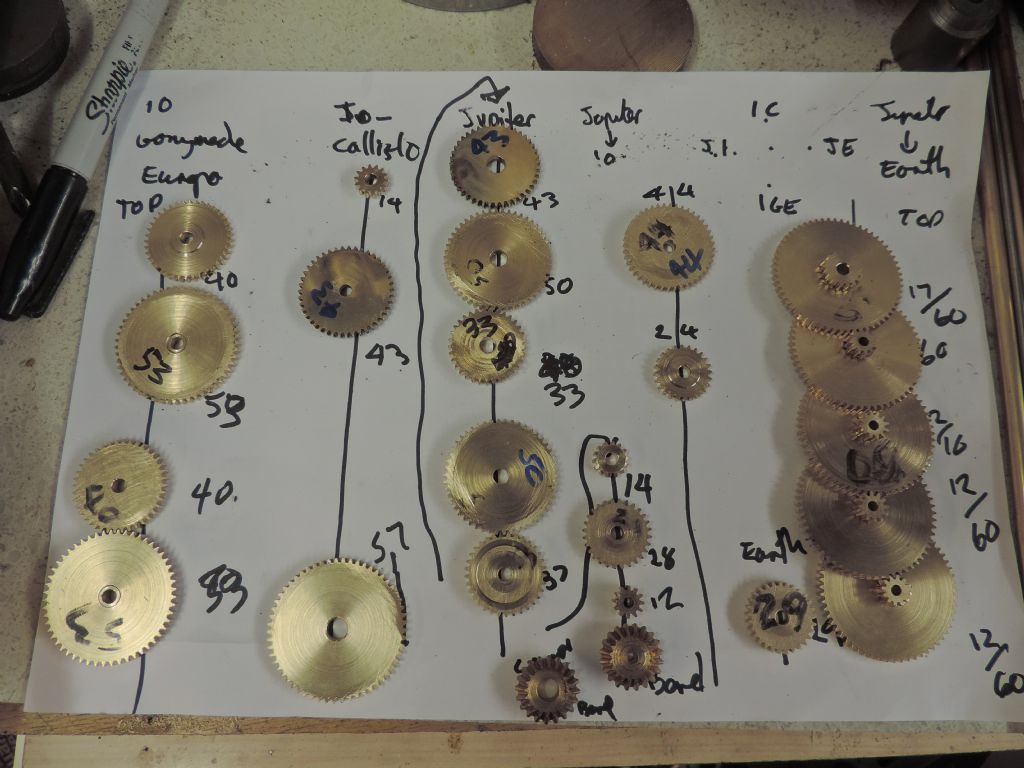

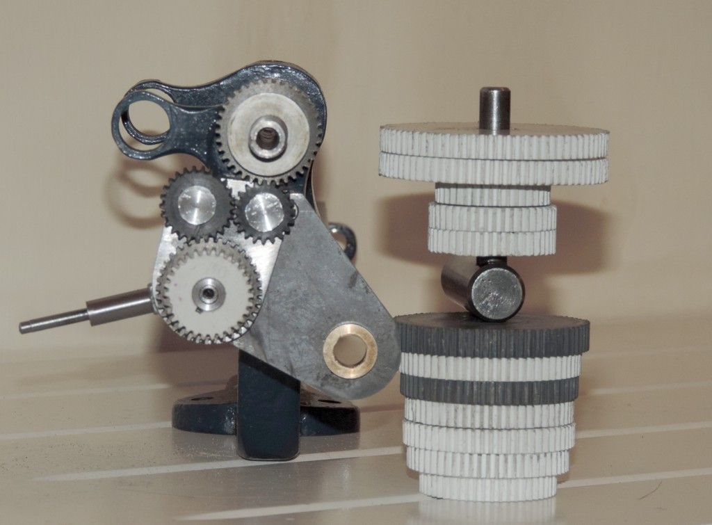

                                A few more photos,
                                First for Dave, a view of the cutter and gear making setup:
                                The results of several evenings and weekends:
                                All indexed according to the spindle and their place in the stack!
                                Two pics of a trial assembly, a few gears flop as they are on the wrong size spindle, and some spindles are too long. No spindles for the train of 12/60 gears or the bevel drive and, of course, no 344 tooth gear yet*.
                                Of course, Mr Stoopid has bought a big bit of CZ108 instead of compo… methinks I may be looking at etching rather than engraving for the dial! Bucket of ferric sir?
                                #260742

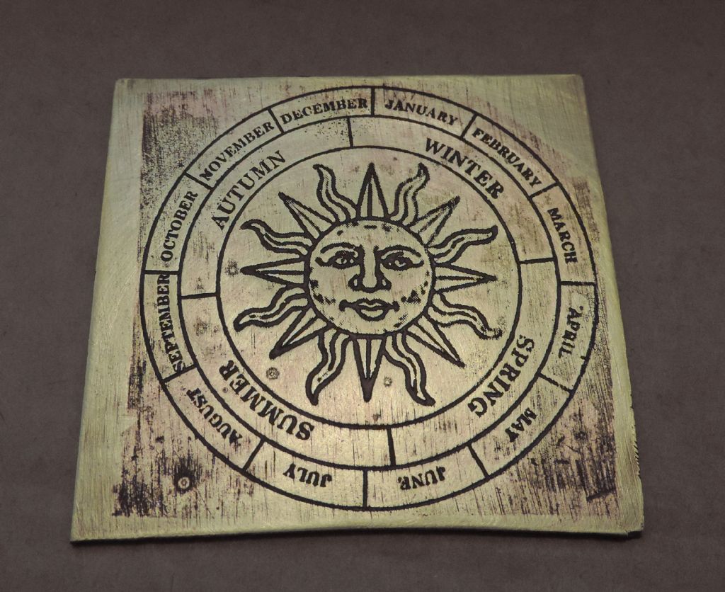

                                                    Rather than diving in with the big top plate, I thought I'd refresh my etching skills on a smaller sample – a circular calendar disk that will support the 'earth' and perhaps a small sun globe. This will fit on the mechanism that operates the pointer that shows where Jupiter is in the sky. As it will rotate once a year, it seems daft not to enhance it this way. So, a 60mm disk with twelve months around the outside then a ring with the four seasons (offset by 22 degrees to start them at the solstice/equinoxes, none of the 1 March nionsense). In the middle a nice mediaeval sun swiped off the net.
                                                    First exposure was too long and the developer too strong. A few tweaks, a recoat with resist and it looked OK after a test etch, so taped all the bare brass up and into the ferric… can take four hours or more and the ferric is getting tired. I will pull it out later and finish off tomorrow. Fresh ferric has been ordered but I think I may need fresh resist spray too.
                                                    The challenge for the big wheel is that the artwork will be over two sheets that will need perfect register. I will also have to expose in sunlight as far too big for the box – or maybe support it six inches or more above the box and have an extended exposure time.
                                                    #261216
                                                      Well, this is the result. The outer circle is 60mm across, the lettering is 1.5mm high.
                                                      Now the dilemma, do I accept an 'antiqued' finish of strive for a flawless etch that I am almost certain to be unable to achieve?
