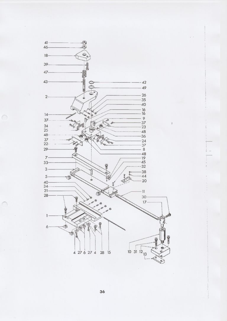

                                            If anyone's still having trouble getting their head around the layout of this attachment, here's an 'exploded' diagram (from the Emco V13 manual) of the device that inspired Jock.
                                            Note that Emco chose rollers, rather than Jock's slippers, to follow the 'sine bar'. One roller is mounted on an eccentric pin (9) for clearance adjustment.
                                            I am local to Jock and know him well and really must visit him again soon. If more questions appear here, I'll get answers directly from him and post them – hopefully within a fortnight or so.
                                            Hope this helps.

                                                Thanks Kiwi bloke for the GA, the roller design is interesting & worthy of further consideration.
