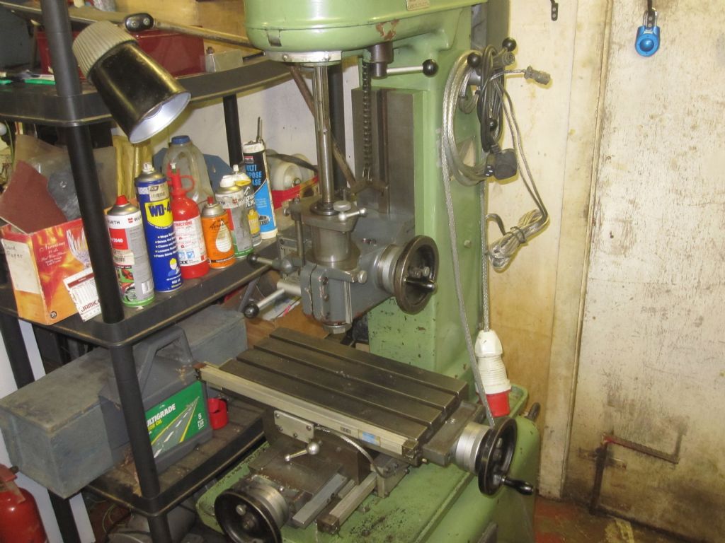

                                        Just had delivery of this beautiful Downham mini borer machine from a very nice Rob in Norfolk. Full set of collets and 2 axis DRO. Compared to the huge Beaver Ive just sold this is a much more suitable machine for me. to make clock and lock parts on. My intention is to CNC convert it which the beaver was just overwhelming to do. This only took four big men to get out of a van. The beaver needed a 2ton crane on a lorry. First impressions are very good. Once on the workshop floor two of us could manouver it by hand. Hoover motor. will have to see if its 400V or 220 as only have 220 3PH but its a foot mount not flange so should be easy to change. happy .
                                        as delivered day 1

                                          Very nice machine. Now I see what the Myford VMB was based on.

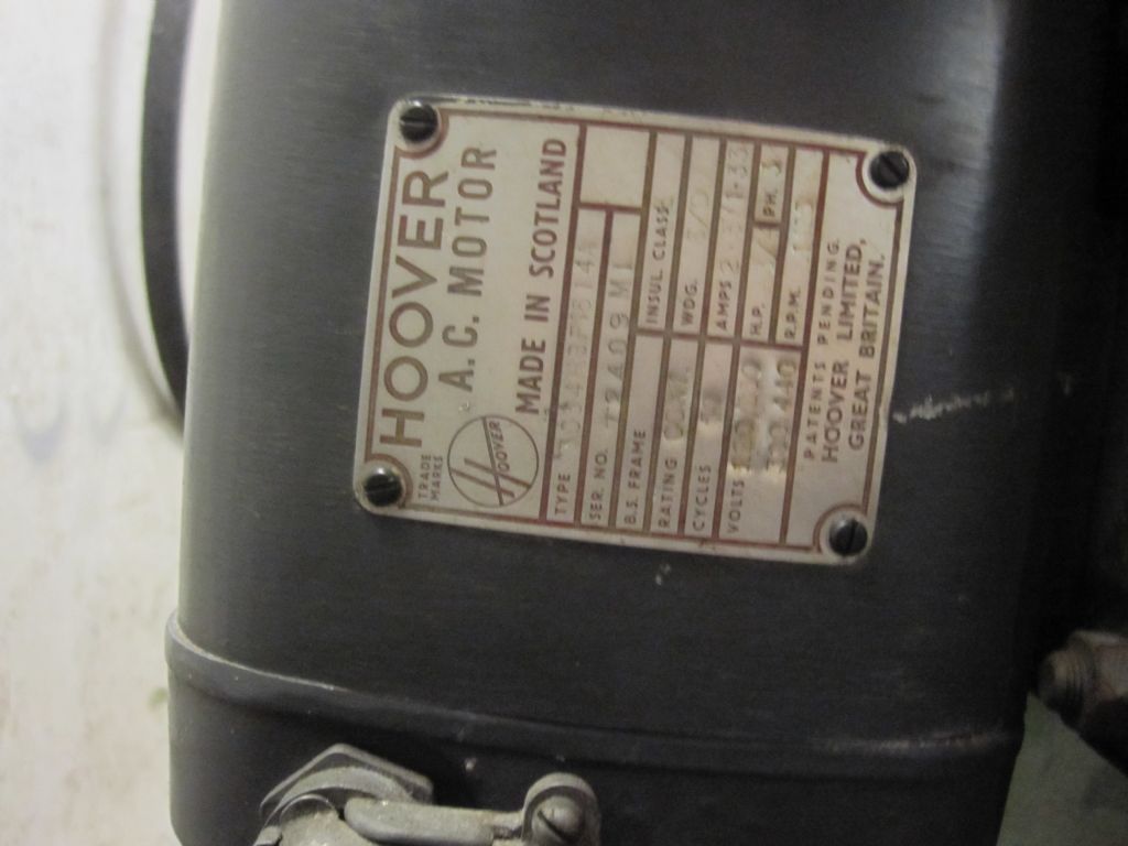

                                          A 400v 3 phase motor is just one that is delta connected to a 220 volt per phase supply.
                                          #346521
                                          Bob McDougall
                                            @bobmcdougall63250
                                            The Downham Hoover motor was stamped as 220/440 and sure enough under a very dust filled plate probably never removed on the motor were six terminals. It had been run on 440 3PH.
                                            Downham motor

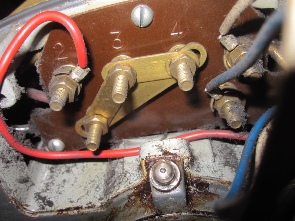

                                            The origional 440V star configuration 1-3-4 as the centre, 2,5,6 as the 3 phase.
                                            440V connections

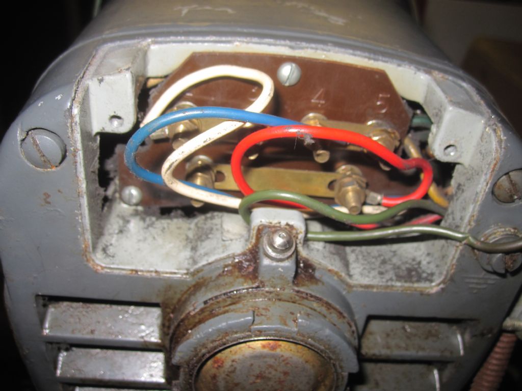

                                            The new 220V delta configuration. 1-6, 2-3, 4-5. with the 3 phase on 2,5,6 or could be any of the three bars.
                                            220V connections

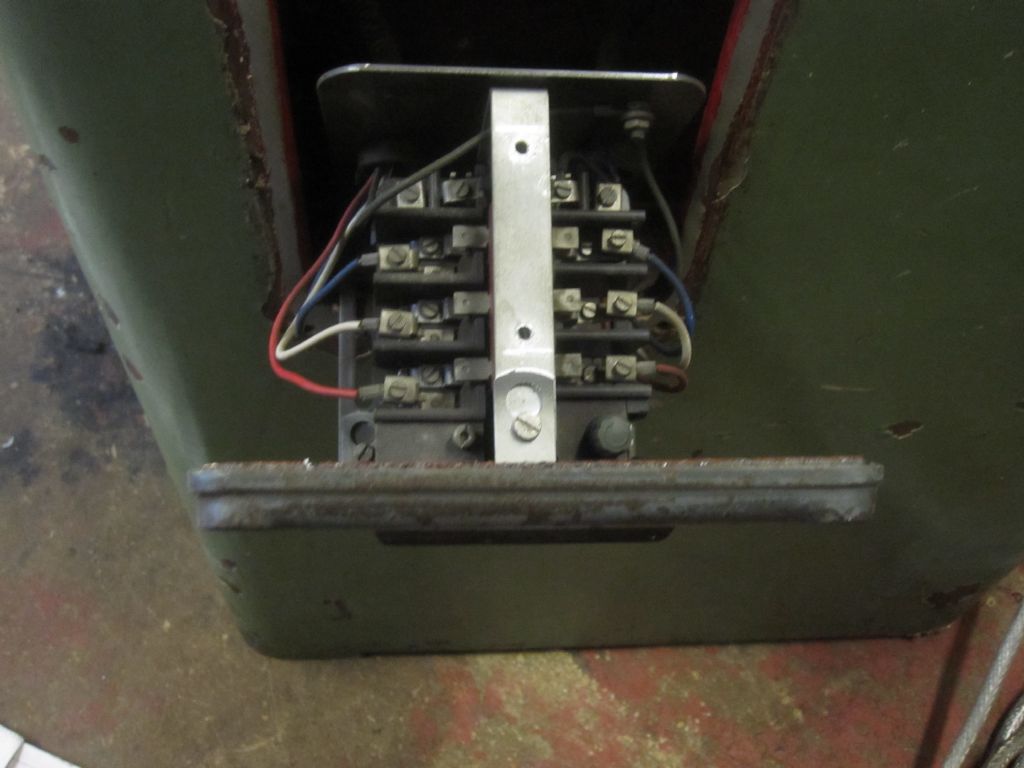

                                            Next problem the 240V lamp was on a transformer so I just disconnected it from the rear terminal box. next problem the side on/off switch was a solenoid overload current trip but was a 440v solenoid so just buzzed at 220. 440V current breaker
                                            So I just jumped the blue-blue, white-white, red-red, the inverter handles overload currents so this is not needed.

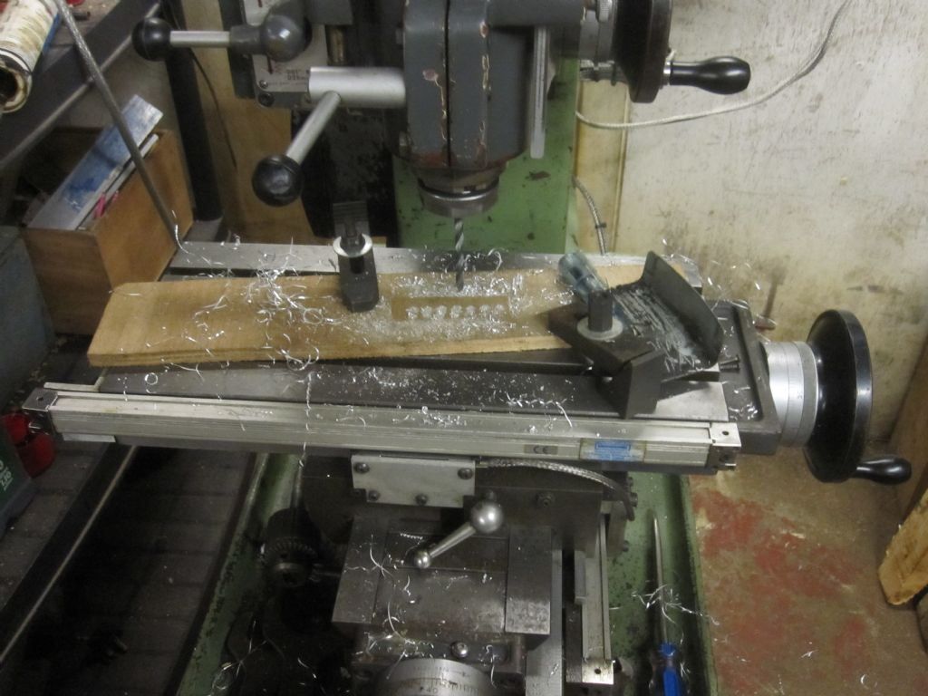

                                            AND I was cutting metal !
                                            downham borer drilling
                                            Yes I will use as centre drill when Im less excited.

                                                    Interesting motor/spindle pulley arrangement. Does the motor slide up and down, as I can't see what the top 2 pulley grooves on the intermediate pulley do.

                                                      The photo of the Hoover 3 phase is useful but I can't see the model details clearly. Looking at both the NEMA and IEC specs I can't find an exact match to the mounting plate. I'm wondering if the motor mount was something specific to the UK.
