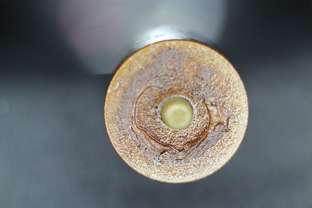

          Memory's a funny thing. John's description of his fun and games with hydrogen reminded me of a school lesson where we punched a small hole in the base of a largish tin can and discarded the lid. The can was inverted and a thumb placed over the hole. Then the can was filled with hydrogen and placed bottom down on a laboratory tripod. With a lighted match at the ready thumbs were removed and the gas lit at the small hole. It was difficult to see the flame I remember. Anyway after 30 seconds or so enough air mixed with the hydrogen to cause a very satisfying bang. Most of the cans hit the ceiling which was about 15 feet up. Teenage boys, hydrogen, naked flames, no safety gear of any kind – what could possibly go wrong?
          Anyway, the real purpose of this post is to ask advice about pistons!

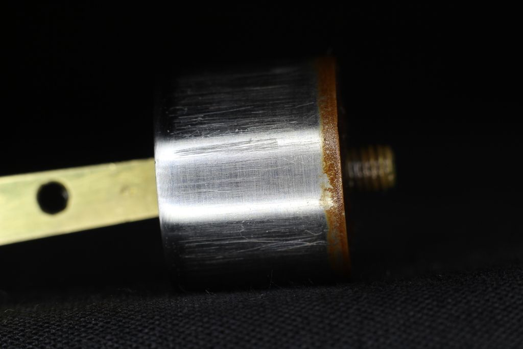

          I've decided to replace the EN1B piston in the pictures with one made from graphite but would like to know if anybody recognises what's going wrong here and how to fix it.
          First problem is the orange pitting on the piston head in the picture. (The flaky ring is the innocent remains of some silicone. The blurry yellow thing in the centre is the out-of focus brass thread of the connecting rod clevis fork that lives inside the piston. )
          My guess is that it's due to moist air causing alternating condensation and evaporation as the engine operates. But it seems very severe for an engine that works on hot air, usually only about 90C. It might be something coming off the RTV sealant but if so it's odourless. Any suggestions please?
          Second problem is that the steel piston (13mm dia by 10mm long) is being scratched by the brass (or possibly bronze) cylinder. The two were carefully polished to a tight fit and then lapped together.
          In operation the brass cylinder seems to retain its polish whilst the piston gets scratched: it takes 30-40 minutes to get into the state shown in the picture. The worst scratch is shown. The very fine scratch lines running around the circumference of the piston were made with 2500 grit emery paper used to touch up the piston after an earlier run. These lines weren't evident on the piston when it was new – it had a better polish. I followed the advice to run the engine without lubrication.
          I'd be very grateful for suggestions as to what is causing this. I think the piston and cylinder are being made the usual way but am I doing something silly?
          Thanks,
          #234218
            When the hard metal is worn by the soft one it means bits of metal or grit are embedded in the soft metal. You may not have cleaned up well enough after using an abrasive at an earlier stage.
            #234270

              If you lapped the bronze cylinder, some of the grit may have embedded it's self in the bronze. I have one engine with a brass, and another with bronze cylinders, and I have kept away from lapping or honing these cylinders for this reason. I believe that you can use a grinding medium called Timesaver and over come the problem, there is a grade for bronze I think.

                The corrosion is strange. The RTV gives of acetic acid which I believe is one of the things that has been used as a rust remover – vinegar. Never tried it and have my doubts but one problem with rust removal is how quickly it can crop up again if not oiled pretty quickly.
                Vinegar can be used to clean brass – that was suggested on the brass burners on a stove we used to have. it's very effective but takes a while.

                    Thanks again chaps, I think Neil and Ian S C are correct. Good news as I might not have twigged to it and might have been a dirty boy again. I distinctly remember washing the piston carefully, but don't recall doing the same to the cylinder – it may only have got a wipe through with some tissue. Attention to detail is not one of my strong points.
                    This afternoon I re-polished both cylinder and piston and this time carefully washed both of them. Interestingly the first wash of the cylinder (in paraffin) didn't get all the grit out. A second wash did and then I rinsed and polished both with unperfumed Nail Varnish Remover, which is slightly diluted Acetone. I shall try the engine again tomorrow.
                    Never heard of Jojoba Oil before, might be worth a try. Using Sperm Whale Oil would ruin my green credentials even if I could catch one! Sewing Machine Oil is good stuff though.

                            I've been interrupted by domestics again! After re-polishing and carefully cleaning both cylinder and piston I reassembled the engine and it went an absolute treat with no oil. Unfortunately after 35 minutes it began to scrape again before literally grinding to a halt in about 10 minutes.
                            Inspecting the piston revealed a new coat of rust on the head and the first 1mm of the piston body. A careful sniff of the hot engine revealed a trace of vinegar.
                            I now think I had two problems: grit causing severe scratching coupled with rust that gradually gums up the piston whilst attacking the fine polish of the cylinder.
                            Careful cleaning seems to have stopped the scratching but not the corrosion. A Q-tip wiped around the cylinder after a run comes out an unhealthy greeny/brown/yellow colour. The source of the vinegar can only be the RTV Instant Gasket I used to seal the engine. It is still curing. I suppose it cures much faster in a full-size engine where there is much more heat. Also, any acetic acid vapour that gets inside the works of a much larger machine will be swept away before it can do any damage.
                            I'm going to leave the engine with the piston out warming on a radiator over the weekend. I hope that will finish the cure. Though the graphite has been delivered I probably won't have time to make and fit a graphite piston until next week.
