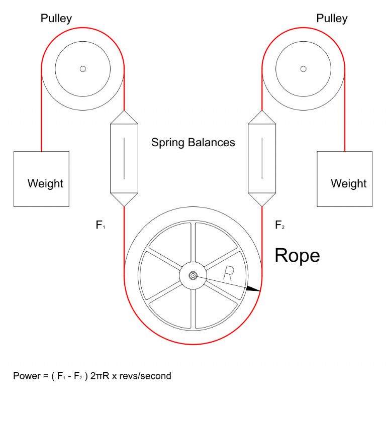

                              Sorry about the crudity of the drawing, but the apparatus would be something like this:
                              I optimistically guess that the main problem would be friction in the bearings of the second wheel. As Ian says it doesn't take much to stop these little engines dead.

                                The problem with anything attached to the flywheel.. as in shafts or bands.. is that you need the starting flickover to overcome that and then allow it to resettle to a steady state. The additional energy stored in any spring system will work against you and that energy will vary with the power of your initiating flick. … Why I suggested the magnets as a non-contact method. And why i decided against things like fan blades or vanes…
                                If you can find a way of coupling after the flywheel has reached steady state then you overcome that.

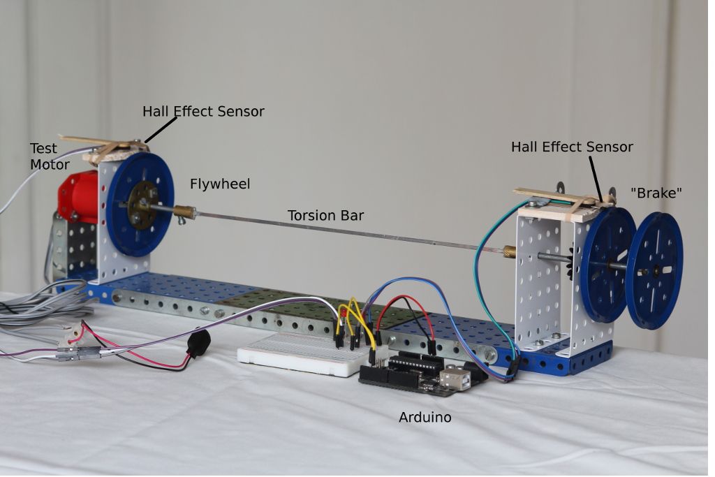

                                        After various unexpected delays I was finally able to complete a "proof of concept" dynamometer made out of Meccano and use it today to get a reasonable result from a test Meccano electric motor.
                                        The electric motor is considerably more powerful than a Coffee Cup Stirling engine but I think I'm on the right track: it does seem possible to make a sensitive dynamometer using the torsion bar principle. (The technique is normally used at the other end of the power range to measure the beefy Shaft Horse Power delivered by a ship's engine.)
                                        Here's the set-up:
                                        The Arduino measures the angular displacement between the flywheel and the brake as well as the rpm of the motor. The connecting cable isn't shown but in operation data is sent to a PC for analysis through the Arduino's USB port.
                                        The torsion bar is calibrated by attaching a horizontal balanced arm across the brake wheel and measuring how far it is deflected by slowly adding known weights to a bag suspended from the end of the arm. I got this nice straight line graph for Torque = mass x distance.
                                        With the Arduino switched on and the PC collecting data, I laid a weighted nylon cord across the end pulley of the brake. Work is done by the motor in trying to lift the weight and in the brake's "bearings". (There's a lot of friction because Meccano doesn't have proper bearings.)
                                        The work twists the torsion bar and because the Arduino can detect how much the brake is out of phase with the flywheel, I can determine how much the torsion bar is twisting.
                                        After loading the data into a spreadsheet, I crunched about 100 readings to find the average deflection at average rpm. It was 1.8 degrees of twist at 365 rpm. From the calibration graph this corresponds to a torque of 0.00678 kg/m
                                        And: Power = Torque * 2 pi * N / 60 (where N is rpm)

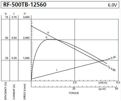

                                        If I got the calculation right (oh dear!), the measured output is about 0.25W
                                        As the input to the motor was about 1W (1.75V at 550mA), we have a motor efficiency of about 25%. This is in the right ball park for a small DC motor. Below is a graph of Torgue, Efficiency, Volts and Amps as provided by the maker of a real motor. It seems that 25% efficiency isn't unusual.

                                          Neat piece of work Dave. Maybe a plastic shaft might get the sensitivity up. I'll tuck your ideas away in case I ever feel the need for one.

                                            If you need to reduce the torsional stifness; maybe try a flat strip instead of round … The extreme version being the Torsional pendulum in a 400 day clock … You could try strips of GRP or Carbon Fibre, for example.
                                            Keep at it … You're on to a winner!

                                              Michael's suggestion of using plastic strip in the Mk2 dynamometer feels right too. I have some strip that might do if only I can find it. I have to get the engine working reliably before making a start on that though.
