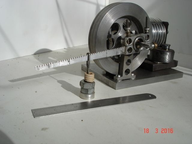

                          Here is one of my flame gulpers with a brake on it, the weight is 1 oz, sorry no video, belted up to a small electric motor as a generator it will power a small transistor radio.

                            What a beauty Ian, I wish you had a video of her running. I like the way you have set up the brake.

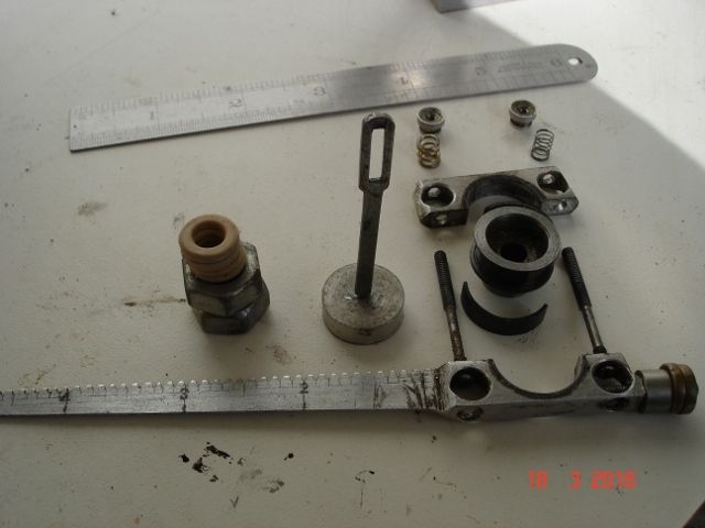

                              Here's the brake arm broken down. The weight hanger is .5 oz. The shims between the brake and the drum are cut from the plastic piston ring from a car shock absorber (I cut those open for the steel, and ready made cylinders for my hot air motors).

                                Thank you very much for the photo Ian, appreciated mate.
