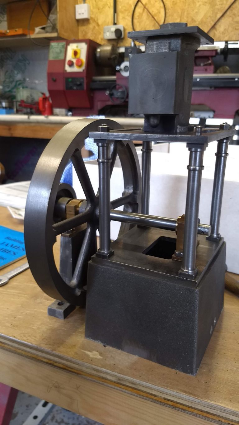

      After too many years languishing under the bench, I finally pulled out my James Coombes build.
      I had intended to build "to plan", unlike my Victoria, which I made substantial modifications to.
      I was pleased to find I'd made much more progress than I remembered, but I hadn't stuck to plan! I'd never liked the table columns, it didn't seem right to transition the round columns to a square platform. Just me being a bit OCD, so I turned them from square bar, so I could create a square plinth top and bottom. I'm pleased with how they look, but it has created a fitting problem – the valve gear bearing blocks screw directly on to the threaded posts that secure the columns. Any misalignment in the thread axis is corrected by rotating the column.
      I need to fix that first, before I progress.
      Any ideas welcome!

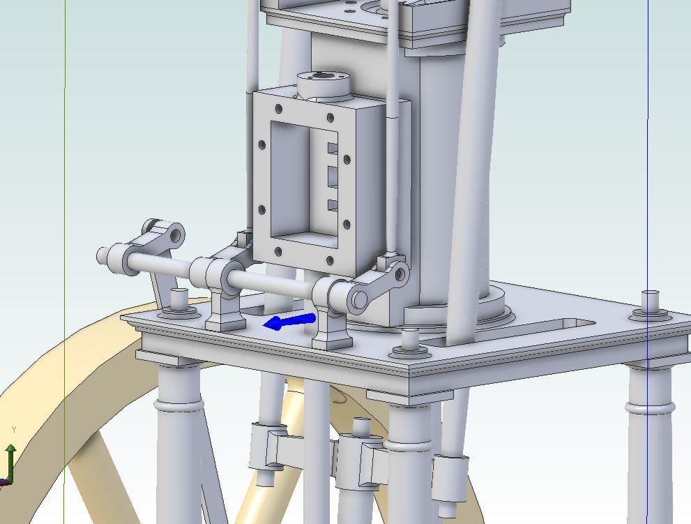

              #623344
                Coming back to the original question, if you have not got over it by now than moving the supports to another position is also an option and one that I have gone for on my much modified JC.
                I'll be doing my conrods in the next week or two if you have any questions Wayne, the short one and the yoke were completed last weekend I'm not soldering as per the Stuart design but bolting together.
