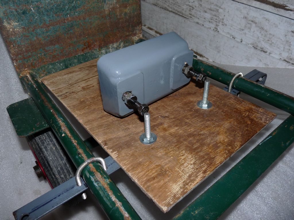

              A quick tip for all those who are rushing out to buy a Myford …
              I moved the lathe [no stand] up my drive, safely and comfortably; by removing the Tailstock, Compound Slide, and the Motor & Countershaft … then sliding it along on two of these hop-ups "bucket brigade" style.
              [each hop-up was topped with a sheet of Stirling Board, to protect the Aluminium and allow the lathe to slide]
              Yes, I'm a wimp: I can't carry a Myford in my arms crying

                Hi Michael,
                That's clever, I made an attachment to my sack truck to swap the ML7 and Super 7 around – more in the album. A couple of nuts and all was safe. By combining the two methods I think the hop-ups would have allowed me to load the sack truck unaided.
