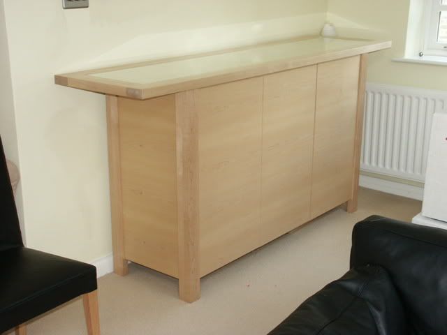

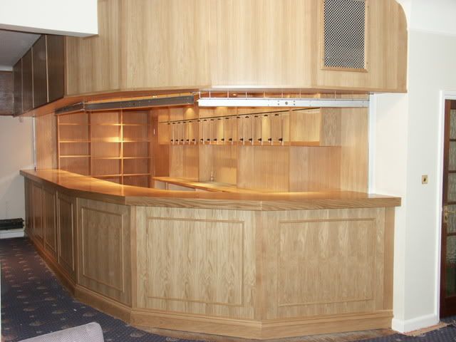

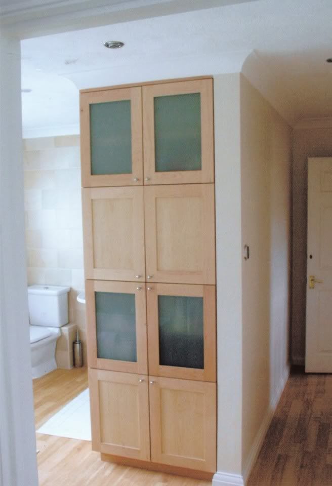

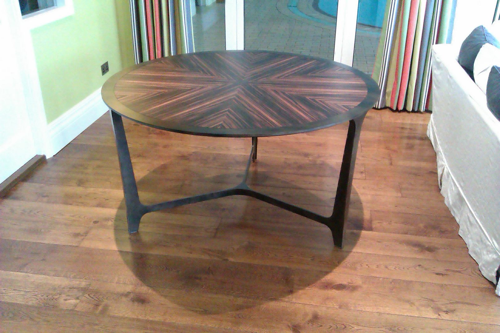

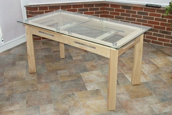

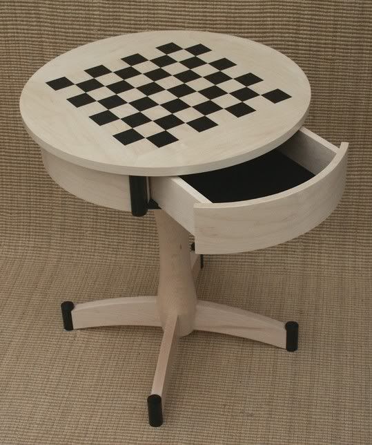

                  As Mark says the first raises the grain so needs flatting back down and the second less so.
                  I have used waterbased fllor varnish for years, originally “Aquacote” as suggested by one of the authors in Furniture & Cabinet making mag then when that disappeared I went to Smith & Rogers version or Bona. I have also used Dulux Diamond varnish. Paint is all waterbased these days too which I get on with OK.
                  For flat surfaces I tend to use a paint pad rather than a brush as it does not produce as many small bubbles in the surface. As it is not as viscous as the old poly varish you can’t slap it on and expect it not to run so if you can lay the item flat do so.
                  As for oil I now use the Osmo rather than Rustins. But the waterbase I find better on light woods like maple as it does not alter the colour
                  Few jobs, first is the Dulux diamond others Aquacote or S&R, last Bona Mega
