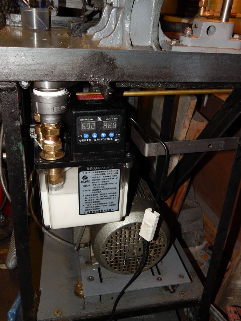

                        On a slightly different tack, since it was mentioned, Don't rely on a water based cutting fluid not causing rust because it has an inhibitor. An inhibitor is not a preventer so splashed need sorting out immediately. Although some amateurs do use flood cooling occasionally mostly it is not necessary and only used to wash away bulk chips with a bigger lathe. Often a small brush putting on a little neat oil is best.

                            Posted by Martin Newbold on 12/05/2018 11:37:03:
                            MY pum p is working well and can spray cutting fluid everywhere and redecorate my tools luckily i understand it has an anti rust agent in it Its not only white at christmas lol
                            Now that you have used up one life with your wobbly chuck and started spraying coolant everywhere you may want to take a second look at your wiring arrangements.
                            Would hate for things or you to go up in a puff of smoke. smile o
