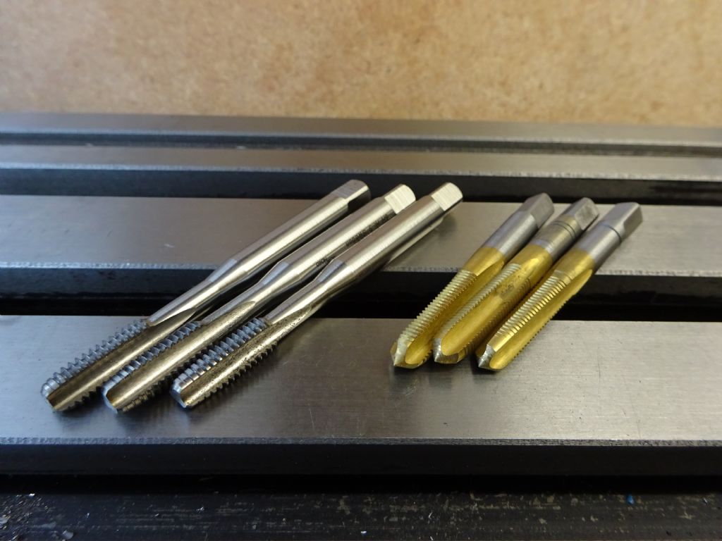

            #369977
              Sounds like you bought a set of sequential taps, do they have grooves cut around the shanks like the set on the right in this photo?
              Edited By JasonB on 01/09/2018 20:04:08

                I think they're worth keeping.
                Ordinary ISO529 'taper, second, bottom' hand-taps aren't recommended for threads deeper than 1.5 times tap diameter. Instead serial taps, defined by DIN352, use three taps of gradually increasing size to thread deep holes or alloys that risk breaking an ordinary tap. The down side is having to run all three taps to finish a thread..
                Presto sell DIN352 taps as well as ISO529.

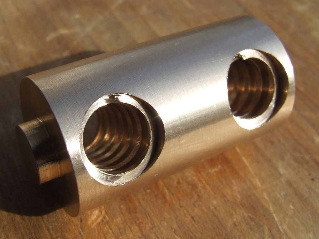

                                        Posted by Andrew Johnston on 02/09/2018 08:45:00:
                                        I've never used, or felt the need for, serial taps, with the exception of some home made taps for a square thread:
                                        Those are adorable, do they work?

                                          Anonymous
                                            Posted by Robin on 02/09/2018 20:57:48:
                                            Of course! smile
                                            The threaded embryo nuts:
                                            And the finished nuts with the brake shafts:
                                            The square threads are 0.5" OD and 8tpi.
