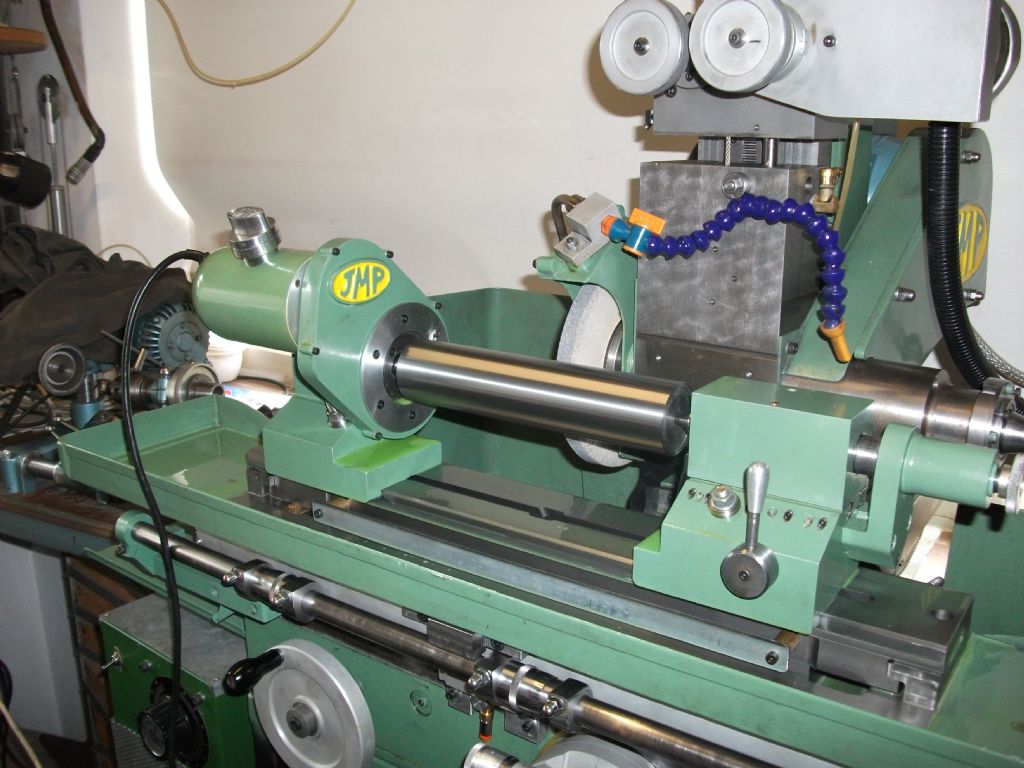

            #568720
            John P
              @johnp77052
              "Is it possible to machine a lathe more accurate than the one you machine it on If so, how?"
              I suppose the question here is posed incorrectly and perhaps should be.
              Is it possible to produce a machine that will produce more accurate work
              that the machine 's that it was made on.
              If that is so then it is here is one
              This cylindrical grinder was made in just that way ,the cylindrical square here
              held between centres is within 1 um along the entire length and stands
              square on a surface plate to within the thickness of 1 um clock gauge
              indicator needle in any 4 places around the diameter.
              As for the how, ME have had the construction article for the last 7+ years
              or so if they haven't lost it again.

                                        Posted by John P on 28/10/2021 21:25:18:
                                        I am not sure what you mean by incorrect. I posed a recursive question deliberately because AFAIK there are some parts of a lathe that can only be made by a lathe and I wondered how that can be. I take your point though, so for the sake of argument let's say the thought experiment is about how some tools are recursive in nature, and that being so, how accuracy comes about.
