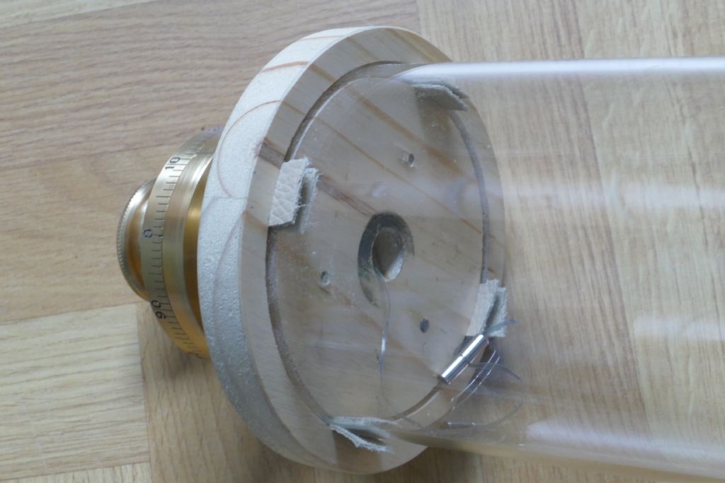

      I'm looking to buy a cheap hobby CNC machine to cut circles in wood to make lids for glass container candles. I like the idea of having the flexibility of changing and improving the design with engraving later down the line but for now I just need to cut a decent circle and maybe rout out a lip.
      I need to be able to bang them out fairly quickly with space for two at a time and be able to send the design from my pc in the Lounge to the CNC in the garage either remotely or via USB stick.
      I don't mind having to do a quick sand down of the edges but I want to be able to do 50 in a day without a long cutting time or preparation past the initial setup.
      The lids would be either MDF or pine 20 ml thick with diameter of 100 ml. I was looking at something like the 3018 or anything around the £200 to £300 mark. I wonder if this would be strong enough and fast enough for my requirements? How long might it take to cut this circle and what power input rating motor would cope with my wood thickness?

          The speed of turning out parts will depend on a number of factors. The standard spindle as supplied is (I believe) 3000 rpm. This will limit how fast the part can be traversed without overloading the motor because at high speeds the tool may be trying to take a larger bite than it can cope with. For example if you wanted each edge of a 2 flute cutter to cut 0.01mm per edge on each pass you would need a feed rate of about 60mm/minute. For a 100mm diameter circle with a circumference of 314mm (100 x pi) it would take 314/60 = 5.25 minutes plus tool change time and lead in/lead out. If you used a single flute cutter double the time. If you need to do a number of passes due to depth or width being more than the spindle and cutter can cope with then multiply the time by the number of passes. Bigger diameter means more time, smaller diameter means less time. You may need to speed up or slow down the feed rate to suit different materials. The numbers above are just rough approximations but should give some idea of the time a part may take. Adding a lip will need a further time as will tool changes (unless you can do all the grooves first then all the lips later to save on tool changes). I have recently done a groove in some pine for a glass tube to fit in. I set it up at 30mm/minute but can't remember if I upped the feed rate once I had the cutting process going. I don't do a lot with wood so I probably went at it a bit cautiously at first, I use Mach3 so may have gone up to 90mm/min (300% is max allowed).
          The groove is Ø5mm tube is Ø104mm with a wall thickness of 3mm and may be cemented in or left as it is at the moment with leather wedging it. The outside diameter was also CNC cut from a roughly square workpiece. The centre is marked because I stopped the process after cutting the centre out to add a central clamp and remove the outer edge clamps. This may be sanded off at some point. Can you tell I am doing it for someone who hasn't completed the design yet?

            Hole saws would do this, quickly and also do the groove, in 2 operations. Much cheaper and faster. Or rotary table and small mill. Noel

                    I doubt anything 'hobby' will do 50 a day 100mm diameter and 20mm depth to be honest. Hole cutter and some sort of lathe fixture to tidy up the edges would be my starting point.
                    I cut some large gear wheels for a friend in 6mm MDF in sets of three sizes, the largest being 100mm. 15 wheels was 5 set ups and really tedious. I would have struggled with 20mm thick MDF, the machining time would have gone up 3x or so. I used a Sieg KX1, which was fine for the small quantity of thin wheels, if a bit tedious. I have the 3018T engraver from Amazon and it's certainly not got the guts to do that sort of work (it struggles to remove copper cladding from PCB with a 3mm cutter) even though the table size is a bit more amenable. I paid about £180 for the 3018.

                        A standard router mounted in a table would be quicker. At 20mm thick routing out on a cnc in one pass on a cheap CNC I would say is a no go. Quicker to rough saw on a band saw and rout the shape with a template.

                                I have no experience of these mini routers, but I am doubtful that they would have enough power to do what you are suggesting, up to 50 times a day. In industry today, I expect they would be produced on automatic lathes, or CNC routers. In the past they would probably be produced using an overhead router, such as a Wadkin LS. Using appropriate jigs. (Used mine today, only to cut plastic tho!)
                                Handheld woodworking routers run at around 20,000 rpm, and are rated at around 1000-2000 watts. I use a 2000 watt router, with ½ inch cutter, ½ inch depth of cut to rout softwood staircase strings. In hardwood ¼ inch depth of cut is more comfortable. The downside of routers are noise and dust. The dust goes everywhere, as Frances said, and the high pitched noise, annoys everyone.
                                As HowardT said, a handheld router inverted in a table, and suitable jigs would do what you want, Bandsawing first will save a lot of strain and dust, and will mean you only need one pass around the outside. Both MDF and softwood will leave you a sanding challenge.
                                Using real wood, will mean routing against the grain, in two of the four quarters, leaving a rough finish, the less close grained your timber, the worse it will be. Sanding the edges of MDF is tricky, as the fibre ends tend to flick back and forth as you sand, it's a bit like sanding the bristles on a scrubbing brush!!
                                Turning the blanks on a lathe, would allow for sanding the edges at the same time.
                                You also have to work out how to hold your blank, whatever machine you use, as you are machining through 360 degrees, clamps are a nuisance. You can use a couple of wood screws, if the holes don't matter, otherwise you are into vacuum chucks, and more expense.
