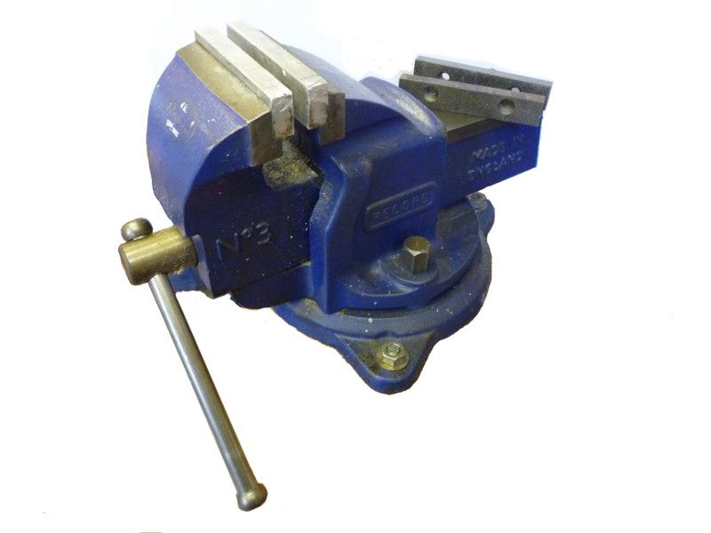

                                  I have had this Record swivel base vice for over 40 years. Fitted with aluminium jaws early in it's life.
                                  I can truly say that I have never used the swivel function and that the circular base can get in the way of holding some jobs!

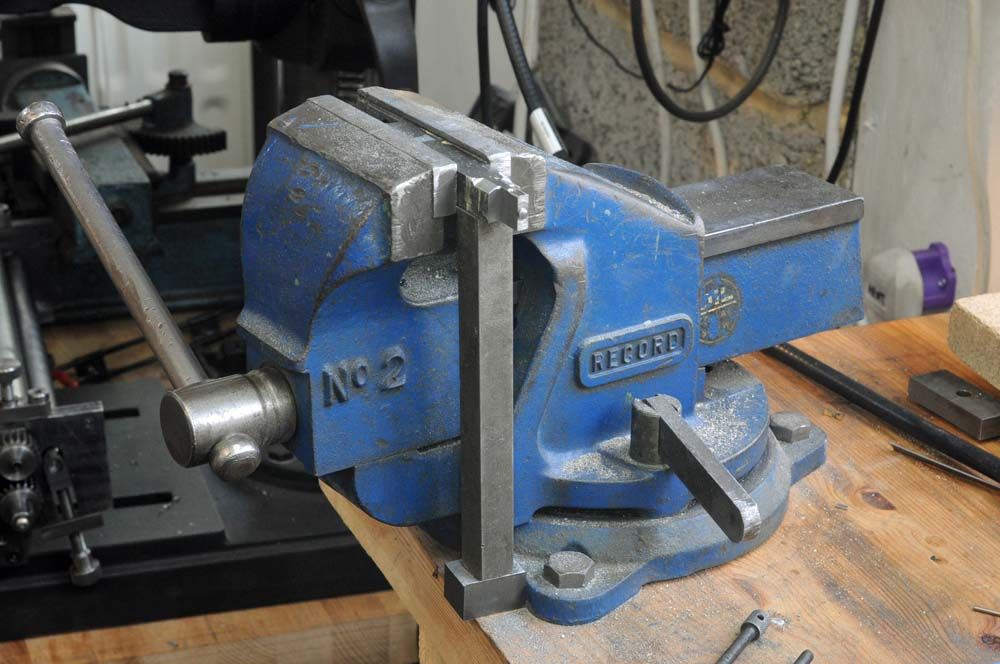

                                              I swivel my vice all the time. I guess it partly depends where and how the vice is mounted. Today I needed to support this riveting dolly and since the vice is mounted so that a long bar can be held downwards in front of the bench, a small amount of rotation was required to bring the support bar on to the bench:
                                              Rod

                                                  Well the beastie arrived today, what a lump!
                                                  First job was to dismantle it it for de greasing – everything was covered in grease and where it was required it didn't look particularly clean, as in not cleaned before application.
                                                  All cleaned up and de burred where required, graphite grease applied to leadscrew and nut and it now works to my satisfaction.
                                                  As suggested it stands a good inch taller than my old one so will not be increasing it further by adding a swivel base I shall just make it able to rotate by about 30 degree although that has to be confirmed before I start drilling fixing holes.
                                                  Alan
