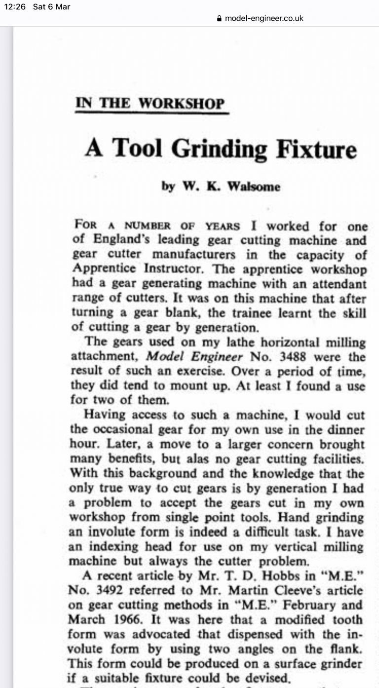

      I came across this article on the forum’s archive:
      The technique looks refreshingly simple … but how good an approximation can two angles be to an involute curve ?
      Just wondering … Has anyone tried this ?
      and are the referenced articles by Messers Hobbs And Cleeve also available ?
      Ref. **LINK**
      https://www.model-engineer.co.uk/wp-content/uploads/sites/4/documents/me-3503-2.pdf

            I have a spreadsheet that calculates the error between a circular approximation to an involute (such as the button method) and the true involute. It is easy to then optimise the parameters of the circular fit to minimise the maximum error (which for this sort of thing is probably better than LS). It could easily be modified to do the same for a straight line approximation. I can't help thinking that there will be a horrible glitch as the corners of the straight lines "roll" past each other. Could you post some more details please Michael? I don't have access to the digital archives.

              The linked article is the design for the cutter-holder, for its grinding.
              We really need know what Mr. Hobbs and Mr. Cleeves (weren't they polite in those days?) described, but I wonder if it is based on the industrial process of gear-shaping?
              Here, the cutter is of involute-rack form, so with straight-sided teeth, reciprocated across the blank at the same time as the blank is rotated and traversed with respect to the rack, under the control of appropriate gearing. After each pass, the blank is indexed to cut the next space – the adjoining cutter teeth trimming the previous and starting the next.
              This generates involute teeth of the same DP and pressure-angle as the rack; approximated mainly by the traverse / rotation increments; and I think the finished wheels are sometimes lapped together. Its advantage is of not limiting teeth-numbers by cutter.
              In another version, the shaper-cutter is a formed as a gear with the appropriate clearances; and it and the blank (on its dividing-plate) are rotated with each other by suitable change-wheels. I don't know if each of such cutters can generate only a set range of teeth numbers.
              It can be done on a shaper with a single-tooth, straight-sided cutter, but very much more slowly; and potentially less accurately. However, I gather a few model-engineers have obtained good results by it. It might be feasible to make a sort of insert-tooth rack in which the individual teeth are gauge-plate bars set side-by-side in a holder.
              It look as if Messrs. Hobbs, Cleeve and Walsome used the same basic principle but with a revolving single-acting cutter, and it would indeed be interesting to see if their technique is worth re-visiting, though the set-up is half-way to being a gear-hobbing machine.
              Mr. Walsome suggests a surface-grinder for forming the cutter, but one could equally use a tool-&-cutter grinder.
              Or one could do as many engineering companies do nowadays.. buy standard "blank" gears and machine the bores and faces to suit. One might not gain Gold Medal though…

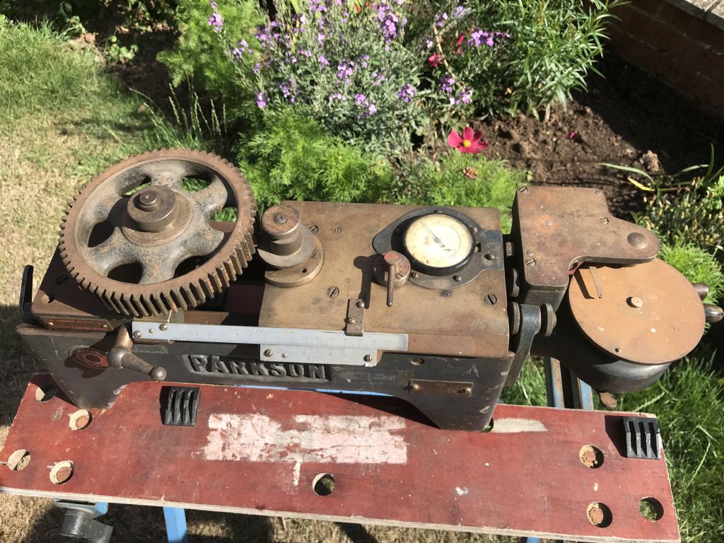

              Oily Rag
                @oilyrag
                Yet another job for this wonderful machine! Load te gears then set the gear centres and wind the handle. Tooth to tooth deviations are recorded on the pressure paper by the stylus. Came out of a skip!
                Will do both external and internal gears.
                I wonder if the Mr W.K Walsome worked for Parkson, which were I believe an associate company of Sunderland Gear?
                Martin

                        Thanks for the ME link Michael, so he seems to have one angle above the pitch line and another below, with a "corner" on the pitch circle itself. I guess that would pretty quickly wear to a curve! Given that the circular arc approximation is so easy to make I wonder why one would bother with this? Anyway I'll add it to the todo list for when I pick up that gear project again…

                              As Andrew says, this grinding jig approximates the involute to two straight lines; it would be interesting to see how the form works on the Parkson gear rolling tester in Martin's photo, above. That brings back memories of my time in the Inspection Department at the above firm
