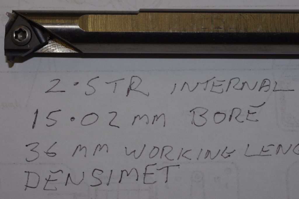

                          Just to show you what is possible with an unaltered 2.5 TR size 16 insert. The tool will pass through a 15.02mm bore and this one cancut 36mm length of thread._igp3006.jpg

                            It is often done to sacrifice one tool for smaller shorter work. At 36mm of a working length is starting to really be pushing the boundaries of diameter to length ratio, as the support material under the insert is where it is the thinnest. I have a Mitsubishi bar that I modified to get to 45mm deep and really it should have been a carbide bar, as the tool does chatter more than I like to see in a thread form. Sadly there was no tap readily available for the thread being made on the repair. So both parts were screw cut. Swarf or chip evacuation is the biggest problem when the bar to bore gets very close. So just have to watch the depths of cut or volume of material being removed. Some materials make fine chips and they can be lodged between the bar and the minor diameter. So coolant or a vacuum cleaner running with a nozzle very near by does hlep.

                              Posted by old mart on 30/07/2022 17:27:37:
                              Edited By old mart on 30/07/2022 17:28:24
                              That is an interesting insert holder with a single angled slice removed to provide the insert socket. Much easier to make than the usual type.
                              Doug

                                Posted by Douglas Johnston on 30/07/2022 23:23:21:
                                It is good for a one off but if we were to look at it from a strictly engineerng point of view, it has some shortcomings.
                                In a standard holder, the X-Y (plan) location of the insert is assured by the two shoulders on the holder. The screw pushing the insert against the flat seat assures location in the Z direction. In the one shown the screw is doing more than one thing.
                                This is not meant as a criticism of a good solution to a tricky problem, more as an example to make the brain cells work – the insert has six degrees of freedom, so what is the easiest (cheapest) way to fully- but not over- constrain it?

                                  The screw in my shop made holder is displaced about 0.005" from the centre of the insert. This holds it tightly against the shoulder. With a close fit in the bore, it is essential to blow away the chips after every pass. The material the bar is made of is not steel.
