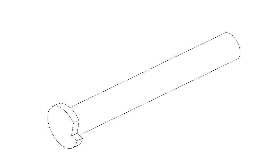

      I'd like to / desperately need to, cut an internal groove in a 10-16mm bore to place a circlip in, without the tool costing close to a weeks wages !
      Grinding my own isn't going to happen.
      I've spent all night on Google & can only get it down to £40'ish, surely some of you have been there before & sourced this cheaper. I need to cut 50+ of these.
      I have a CNC mill fitted with a collett chuck.

                            #311260
                              Get a bit of silver steel, about 1/4" in diameter.
                              Turn a length of it down to about 4mm.
                              Part or cut off leaving a disc on the end full diameter and as thick as you want the groove.
                              File away a 90-degree notch in the disc, looking at the big end, make the bottom horizontal part of the notch at 3 o'clock on the right. This will be your cutting edge.
                              Harden and temper.
                              Hold in the toolpost according to what you have and your ingenuity, like a boring bar.
                              Cut your groove.
                              I know this works because I have done it.
                              #311262
                                Here you go, compared to the inserted bit boring bars, it's embarrassingly simple, but it's all you need and works in smaller holes.
                                #311263
                                  Obviously on the CNC mill, you will need file the disc down all round the circumference to create relief and move the tool in a gradually increasing spiral to cut the groove.
                                  Much harder to do than on a lathe, but should work equally well.

                                  Tony Pratt 1
                                    @tonypratt1
                                    Neil's got my vote or can you use a woodruff key cutter, difficult to say without exact dimensionswink

                                            Use a tiny woodruff keyway cutter. If necessary you can grind off the extra teeth and cutter body to just leave the one cutting tooth.
                                            Or use a carbide insert for cutting small internal square threads, mounted on a small boring bar. Probably cost you the same as the proper internal grooving tool though. That's the price you pay for not grinding your own. It's all time vs money.
