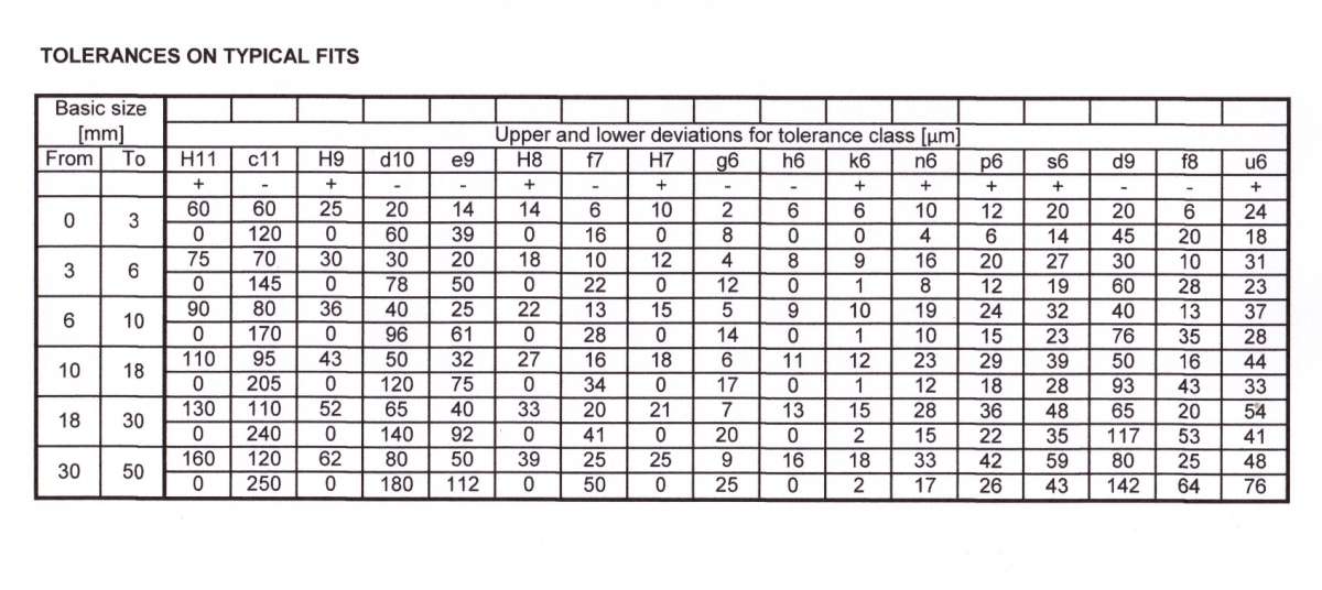

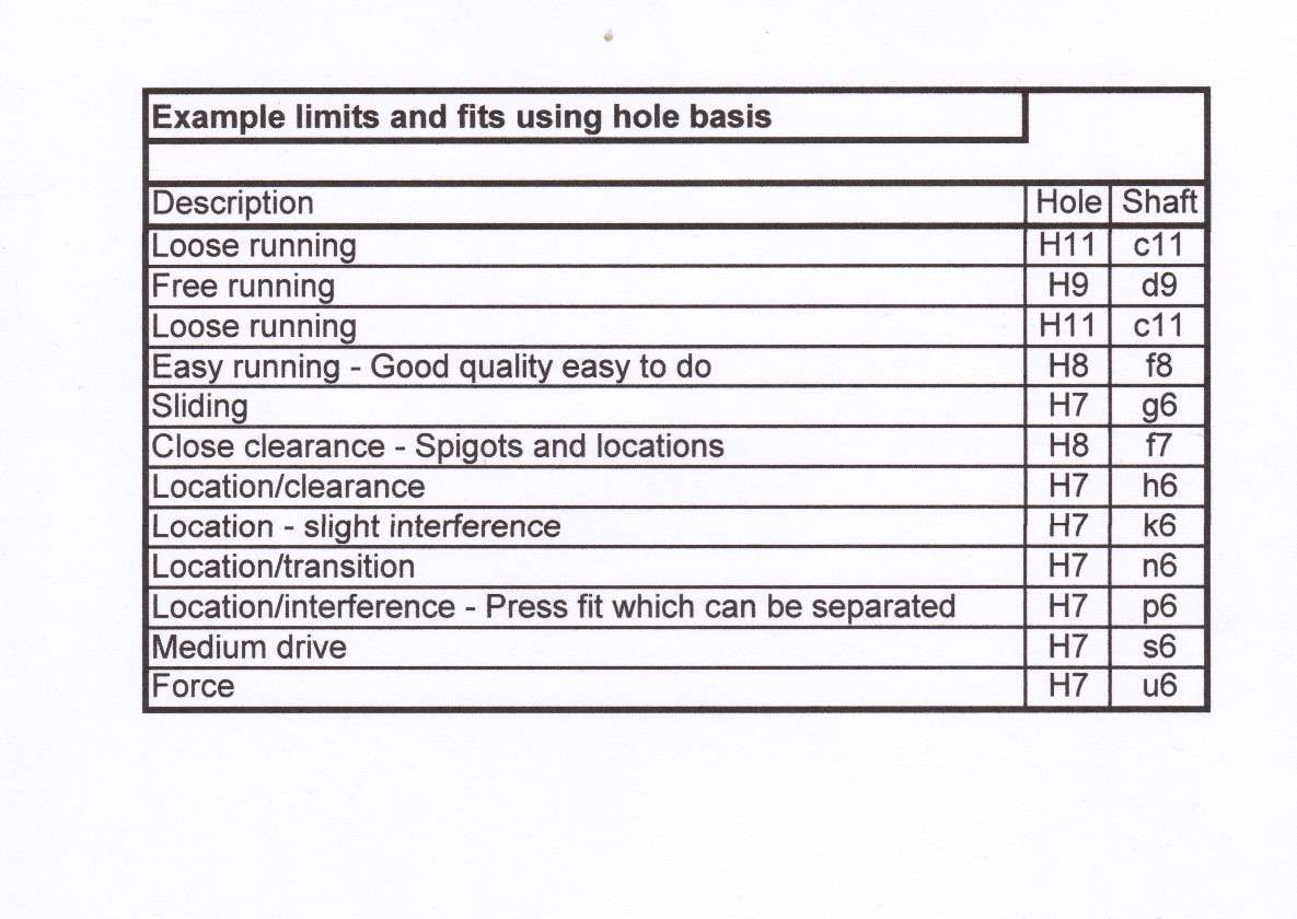

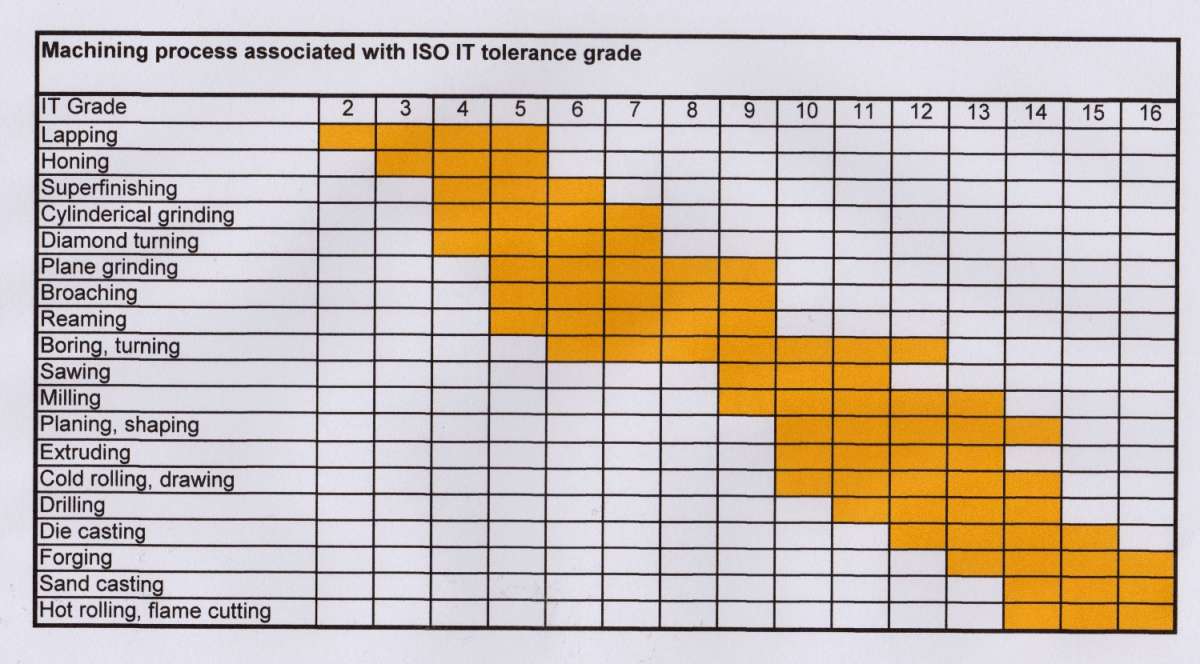

                        Some years ago I found these charts/plots on the internet. I think they came from an ISO standard.
                        Machining processes
                        Chart 1 ranks “machining” operations in terms of accuracy. The lower the IT Grade the better the inherent accuracy (and finish etc).
                        Fits and limits
                        Chart 2 suggests what is required for a particular fit. It is up to you to decided what you want (sorry for the double entry).
                        Note that a hole has a upper case letter and shaft lower case. The number is the expected IT Grade. If you have ever wondered what H7 stamped on a reamer meant, it will become apparent.

                        Chart 3 gives dimensions (metric). It looks complex but is quite simple. Taking an example:
                        For a 20mm diameter shaft with a slight interference fit we can chose H7 and k6 from Chart 2. We have chosen H7 because we have an H7 reamer. This should give a bore diameter between 19.979mm and 20.000mm from Chart 3. Again using Chart 3, k6 gives a shaft diameter between 20.002mm and 20.015mm. In other words an interference of between 0.002mm and 0.036mm. This should be achievable by turning.
                        There are a lot of questions here. The main one is “What relevance has this to model engineering? Surely it is only of use where interchangability of parts is requireded”. My reply is anything that is a useful guide is worth understanding. Also one can frequently meeting repeat operations such as fitting crankpins into the six wheels of a model locomotive. I am surprised that Tubal Cain never included this in his “Model Engineer’s Handbook”. I have a vision of Walshaw wondering if his half page on fits was adaquate.
