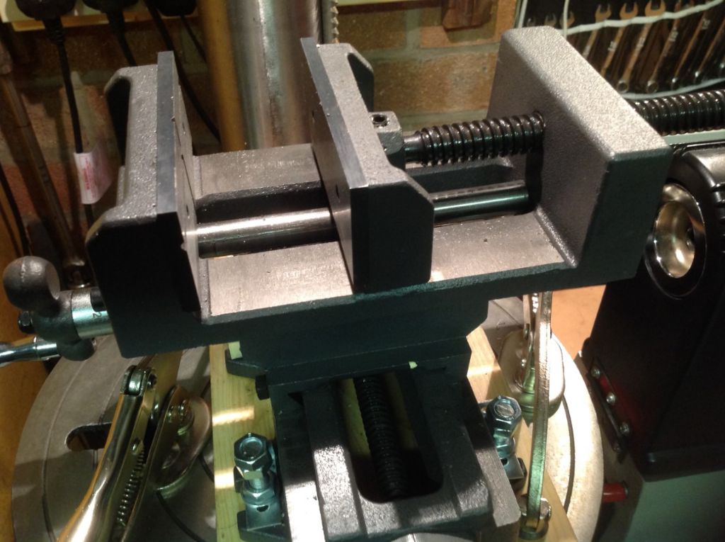

      I recently bought a cross slide vice for my bench drill from a certain Devon-based tool retailer.
      One of the selling points was that in addition to having “adjustable gibs” it had “lockable slides” (these two features were individually highlighted in separate bullet points in the item’s description).
      I was disappointed when the vice arrived to see that it didn’t have lockable slides though it did have adjustable gibs. When I queried the absence of lockable slides with the retailer, I was told “in order to lock the slides you tighten down the gibs”.
      It had taken me some time to do the adjustment of the six gib screws in order to end up with both an absence of any slop and very smooth travel along the full length of both axes. Do I really want to be messing with the spot-on adjustment of even one or two gib screws virtually every time I use the drill?
      I’d be interested to know what others make of the retailer suggesting that gib screws are a routine way of locking slideways, and also the retailer’s apparent claim that, in spite of “adjustable gibs” and “lockable slides” being mentioned in separate bullet points, what the buyer should understand this to mean is that firstly the gib screws can be adjusted, and secondly they can be adjusted all the way down on to the gib strip!

          Posted by Bill Phinn on 17/01/2019 18:47:01:
          I’d be interested to know what others make of the retailer suggesting that gib screws are a routine way of locking slideways, and also the retailer’s apparent claim that, in spite of “adjustable gibs” and “lockable slides” being mentioned in separate bullet points, what the buyer should understand this to mean is that firstly the gib screws be adjusted, and secondly they can be adjusted all the way down on to the gib strip!
          Bovine manure

            I think I would drill and tap for one or two Kip type locking handles so you don’t lose the setup of the gib strip. Depends how far you feel you should go to put right the sellers misselling.

              Any self respecting cross vice needs axis lock screws. Rule 1 when drilling is line up and lock the axes so the job stays put when cutting. Even my ancient and distinctly Early Chinee Sloppy 6" version bought from a Model Engineer exhibition many, many years ago shortly after they first hit the market has locks. Not good locks but they work just well enough that there has never been quite enough impetus to translate the desire to make better into action. Currently sitting on my Fredr'k Pollard 15AY drill. A seriously industrial MT 3 machine which definitely tests their effectiveness with big drills.
              Having lived with my sloppy one for mumble mumble years I'd say good locks are more important than good gib adjustment or tight feed screws. Attempting to runa big drill on mine without locks is a bit scary as things go every which way quite significantly until the drill reaches full diameter.
              Using an over tight gib screw to lock the slide is a good way to distort the gib. Especially if ordinary pointed screws are used. Proper locks should operate via a relatively large diameter pusher to apply force over a reasonable flat area.
              Frankly trade descriptions act applies.

                Mike, I emailed the retailer yesterday afternoon and said exactly what you suggest: that if I keep the vice I would probably want to drill and tap for two locking screws. I also said I wasn't too happy at the somewhat misleading description.
                I haven't had a reply yet.

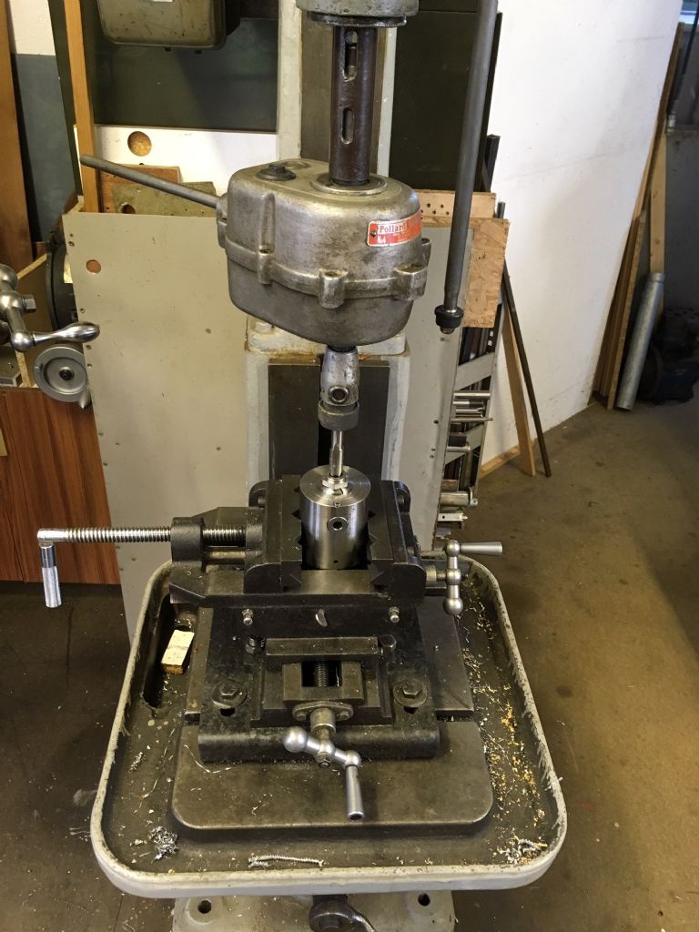

                                              Here is a job we did this afternoon.
                                              Hollow stainless steel oil union around 25 mm long with 27 mm AF hex and M23 x 1.5 external threads held in a 5C collet about to receive an M16 x 1.5 through tap. Pollard No 4 tapping head driven by Fredr'k Pollard 15 AY drill put the tap through "just like that". Two done in a couple or three minutes. Cross vice locked up by thumb screws in both axes didn't even blink.
                                              The vice pretty much never comes off the big 15 AY drill. Maybe one or twice a year. Normal configuration is with a flat "improved wood" table held on via a wide batten underneath.

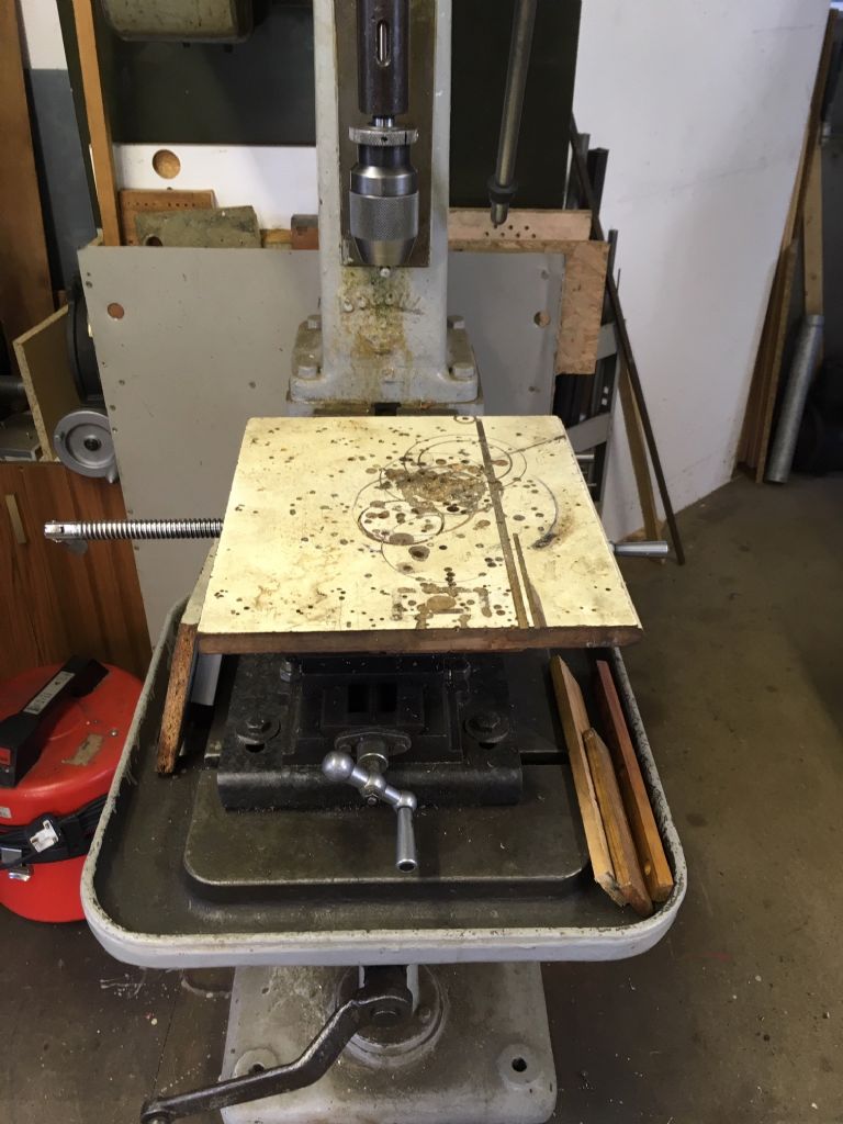

                                              Ideal for sheet or many smaller components that can be held down by a few strategically placed twin thread screws zapped in with a battery drill. Or clamp to the overhanging sides with G, tool or friction type trigger clamp. Have a smaller one too for similar work. Easily removed when I want to use the naked vice.
                                              The plate shown is probably past its best but I have a stack of old kitchen furnishing panels up in the shop attic to make a new one from.

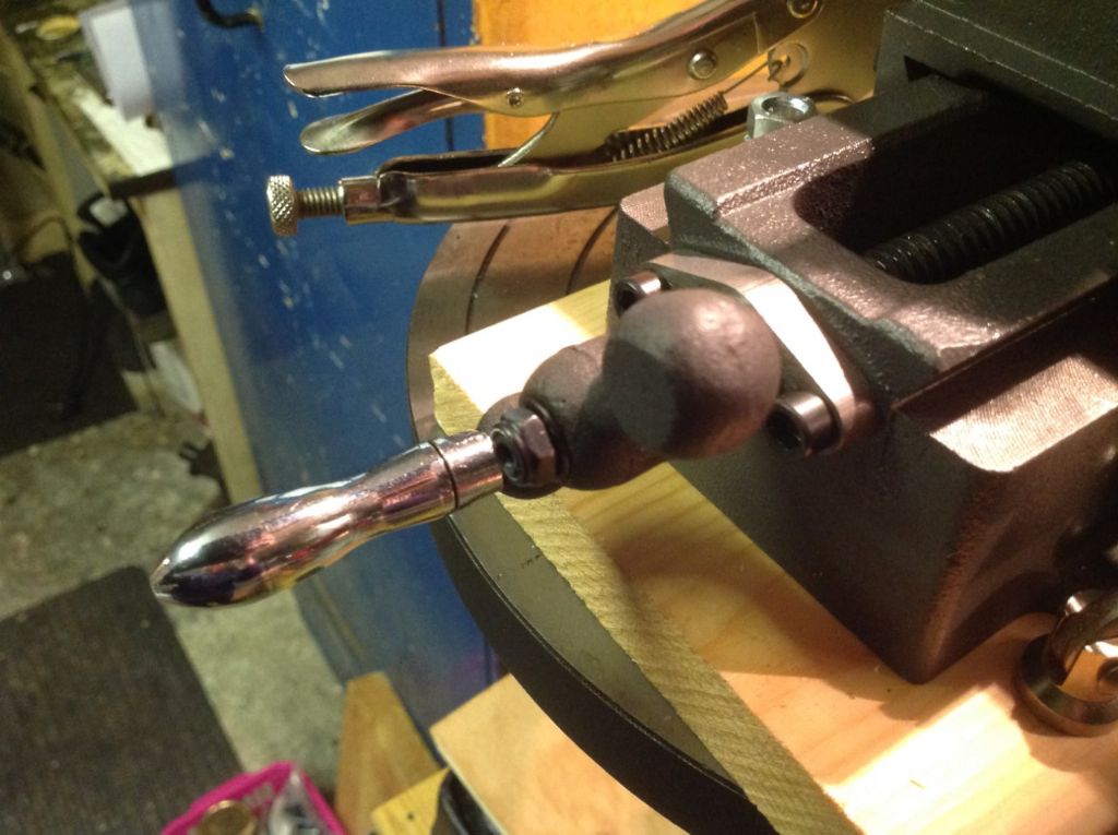

                                                I've bolted mine to a piece of wood and have it clamped to the drill table with hold-down clamps.
                                                I did some experimental drilling and tapping on a piece of 1/4 inch mild steel bar. The set-up is solid and would, I think, be perfectly acceptable for the workaday kind of tapping my crude engineering skills currently limit me to doing – if only I could lock the slides!
                                                As it is, virtually every time I changed over from drill bit to tap the whole plot had contrived to move a fractional amount meaning that the tap was not entering the drill hole perfectly centrally.
                                                In desperation I decided to have a go locking the slides by tightening down the Nyloc nuts holding the handles on (pictured). This seemed to secure the two axes ok, but, however gently I wielded the spanner, by the time I had tightened the nuts the necessary two revolutions to lock things up I found that invariably one or both axes had shifted slightly out of position. Without an effective way of locking the slides I'm reduced to a lot of trial and error in order to get back exactly into the hole I'm working on.
