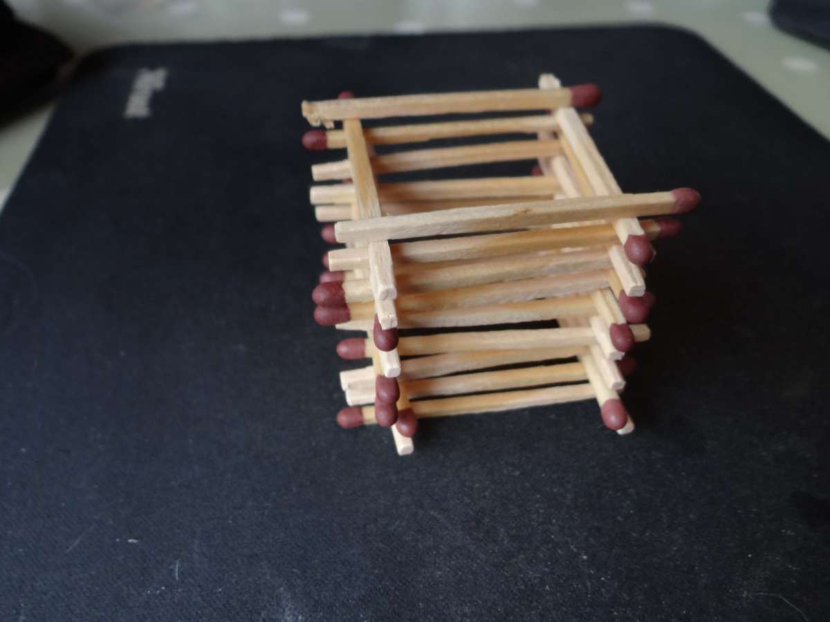

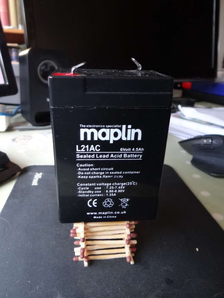

                  Just in case a literal minded friend thinks I’m suggesting lifting a mill on a stack of matchsticks, this is only an example:
                  DSC06895
                  6 grams of matchsticks easily support a 720g battery:
                  DSC06896
                  And if it’s not obvious, the stack doesn’t cope well with sideways forces.  Take care!   Even if it doesn’t crush Sonic, a falling mill will probably damage the floor, alarming the neighbours and annoying the landlord.

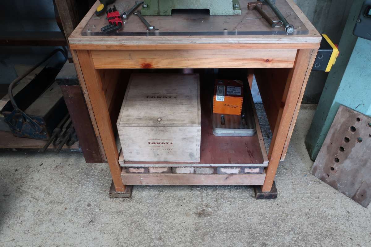

                          About the table. I don’t have one strong enough. Normally I would build a workbench myself but here I don’t have any tools yet. And anyway playing with angle grinder or welding in the apartment is out of the question. So I’ll have to buy one. But a solid workbench could be quite expensive. Even a used one.
                          I found this model that has a more decent price. But I’m not sure how solid it is. In the specs it says it should hold up to 900kg. But how about the rigidity? Afterall the legs seems to be attached only with two screws each. And I can’t see one before buying it. Anybody had any experience with this kind of workbenches?
                          #789727

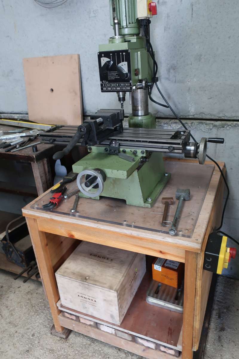

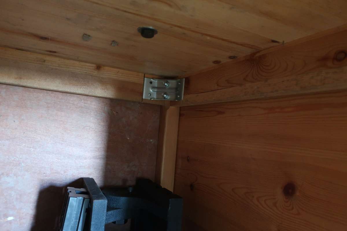

                          Diogenes
                            @diogenes
                            I’ve just had to build a bench to stand a smallish mill on – I used a really flimsy small pine table (because I had one) and boxed in the sides and supplemented the top with ply – it’s very rigid.
                            How about Ikea.?
                            #789800
                            Diogenes
                              @diogenes
                              IMG_2590
                              IMG_2591IMG_2589

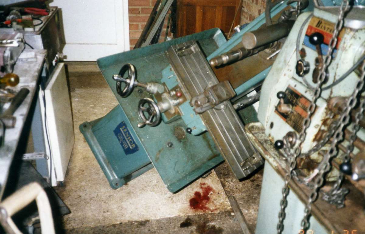

                                Chris Gunn
                                  @chrisgunn36534
                                  Beware of cribbing, this is what can happen when it goes wrong. The blood is mine. KILLER MILLER FEB 88-0002
