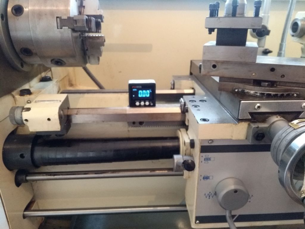

        Levelling is a vastly over discussed subject.
        For folk like us its most relevant to the lighter range of machines, Myford, Boxford, Southbend and smaller, where careless bolting onto a strong but un flat bench can distort the bed.
        Similar considerations apply to larger machines with the old fashioned pedestal at the headstock end, legs at the tailstock end and unsupported bed between. Maybe with a chip tray bolted in place. If the floor is insufficiently flat you end up with it sat on three points with one leg, almost invariably at the tailstock end, hanging in the air. Packing the hanging leg to equalise the loads side to side on the feet is sufficient to take out the stress on the bed. The machine mass won't bend a bed that big. Users choice how level you want it.
        Lathes solidly bolted to sturdy cabinets, whether sheet and angle frame like yours, or fully cast boxes like my Smart & Brown 1024, are essentially unbendable and untwistable by any forces folks like us can apply. So assuming the maker hasn't had a Friday afternoon moment and twisted things by making the mounting points out of parallel the machine will be quite happy so long as the mounting points are shimmed to equalise loads as mentioned above. Being close to level is nice on a lathe but frankly carpenters level or wixley type digital is good enough.
        Taking the time to get a mill table really level is worth it as being properly level makes many set ups easier.
        I've always found it quite sufficient to use a thin metal sheet, preferably shim, between two lubricated plates in conjunction with a screw jack to judge loads on the mounting points. Basically settle the machine down on the plate stack and judge how much of a turn on the jackscrew it takes to lift one or the other corner enough so the ship plate is stiff to move. I reckon around 1/10 turn between fully loaded and slides when testing alternately is close enough. Change the stack for proper solid shim once you have the adjustments sorted.
        Did both my P&W model B, pedestal-leg type, and S&B 1024, cast box underneath, that way. Both within a few seconds of level when checked afterwards with my favourite WW 2 gunners clinometer.
        30 seconds of arc per division. Small so you can turn it end for end to test. Calibrated tilt adjustment so you can work your way down.
        Super precision levels are a pain to use because the bubble is slow to settle and mostly parks itself at one end so little help until really close. Carpenters and wixley style digitals are, objectively insufficiently accurate if you really want level.
        But with a lathe so long as the bed is unstressed out of level, within reason, matters little.

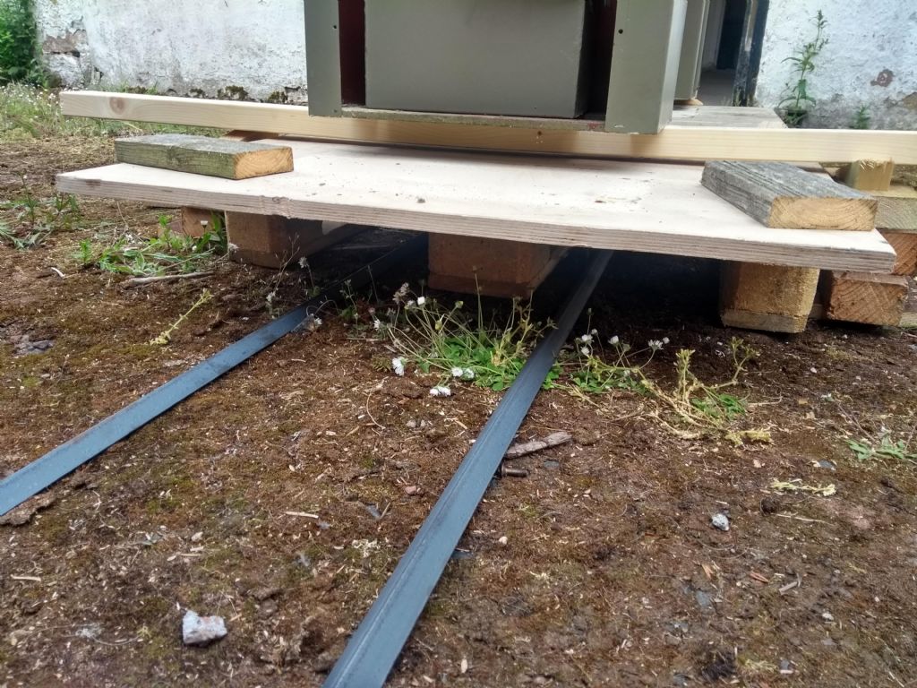

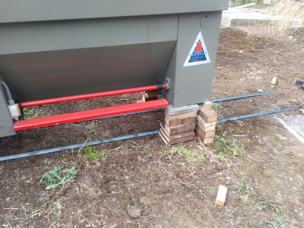

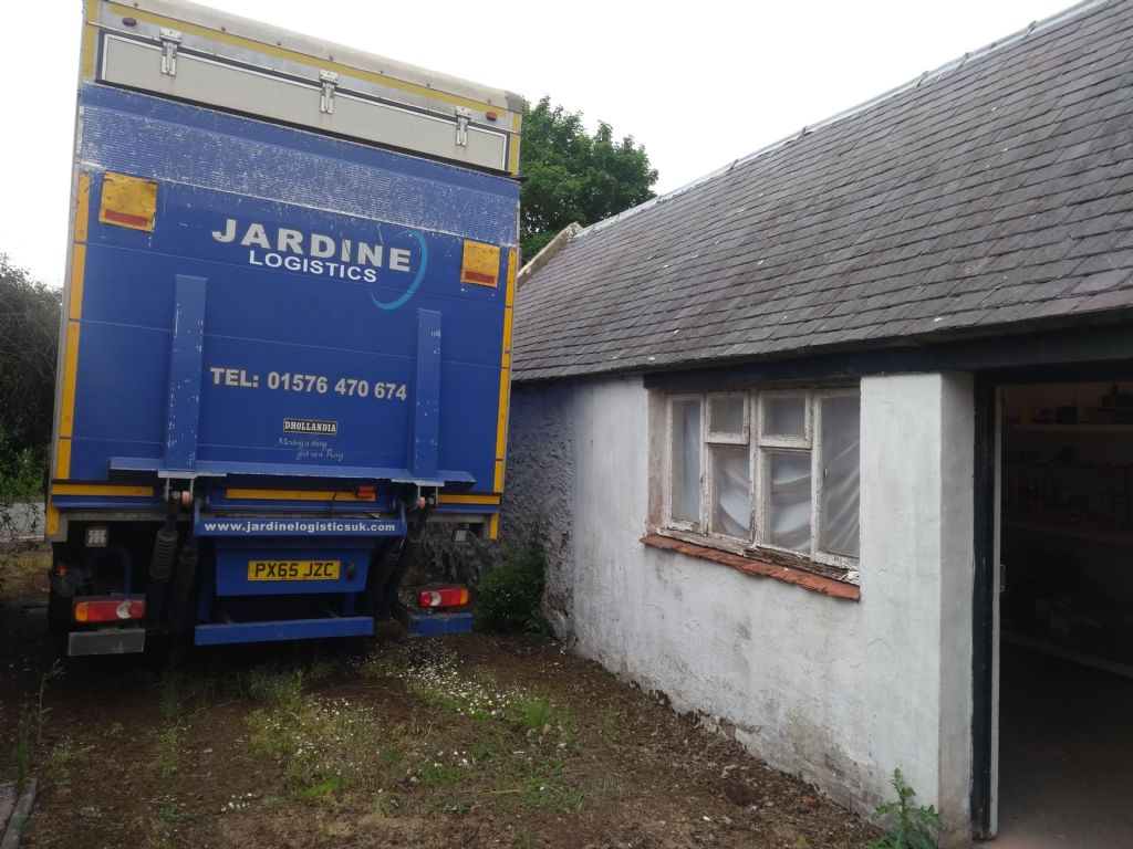

              Well, after much twiddling of thumbs, last Thursday I got a call asking when I would like to take delivery: well, no point owning a lathe sitting several hundred miles away, so on Monday I got another call from a jovial delivery driver intimating he was fifteen minutes away and would I put the kettle on. Gladly.
              He took one look at the narrow space between my workshop and the garden wall: "aye, nae bother", and proceeded to reverse a 12-tonne truck in as if it were a Mini into the Bay of Biscay.
              He drank his tea, apologised for not having anything to lift the lathe off the pallet "or I'd get that in there nae bother", jumped in his truck and zoomed off, leaving this:

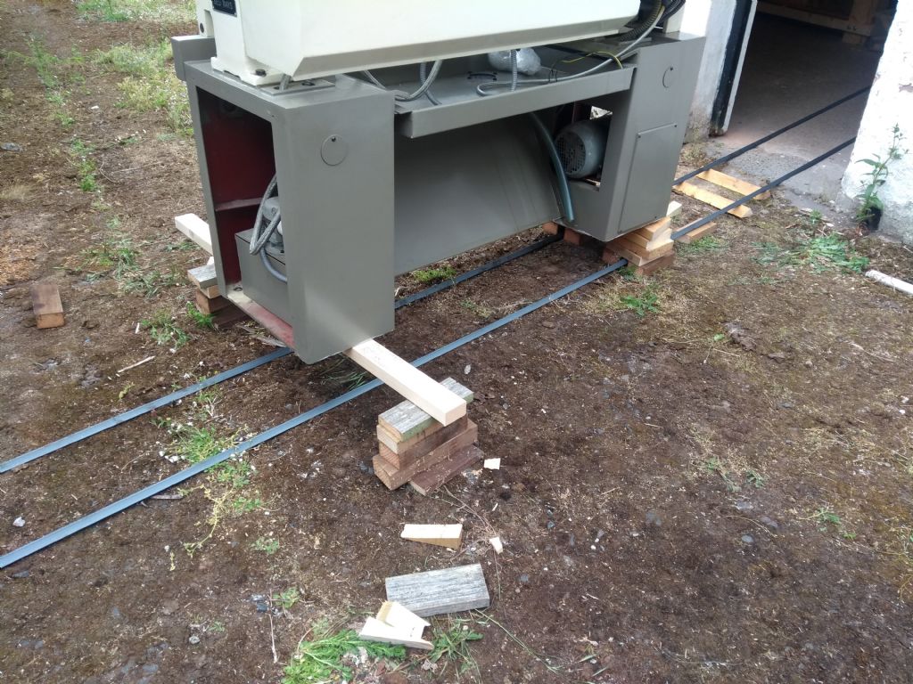

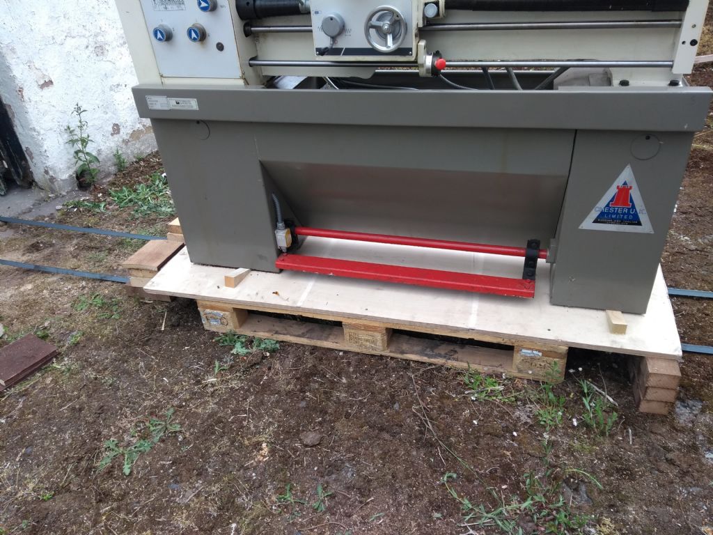

              Gulp. I finished my tea and set to work. I hadn't planned on that big ol' sheet of ply being in the way of getting the cabinet jacked up, so plan B was hastily developed.
              I laid down the rails for the machine to slide on (ominous foreshadowing alert), plaved blocks for the headstock end to repose on, and began jacking the machine up. I had made a lot of wedges from goodness knows what bit of 6×2 construction lumber, and this was the first thing I learnt: it's worth making wedges out of a decent hardwood, and making them a decent size. Wedges twice the size would have made life so much easier.
              The machine rolled forward using a bit of random aluminium tubing. Now the tailstock end was a problem: how to support it so I could get the pallet out? After some guesstimation, I was fairly confident a bit of C16 timber would take the weight. It didn't look so scary like this:

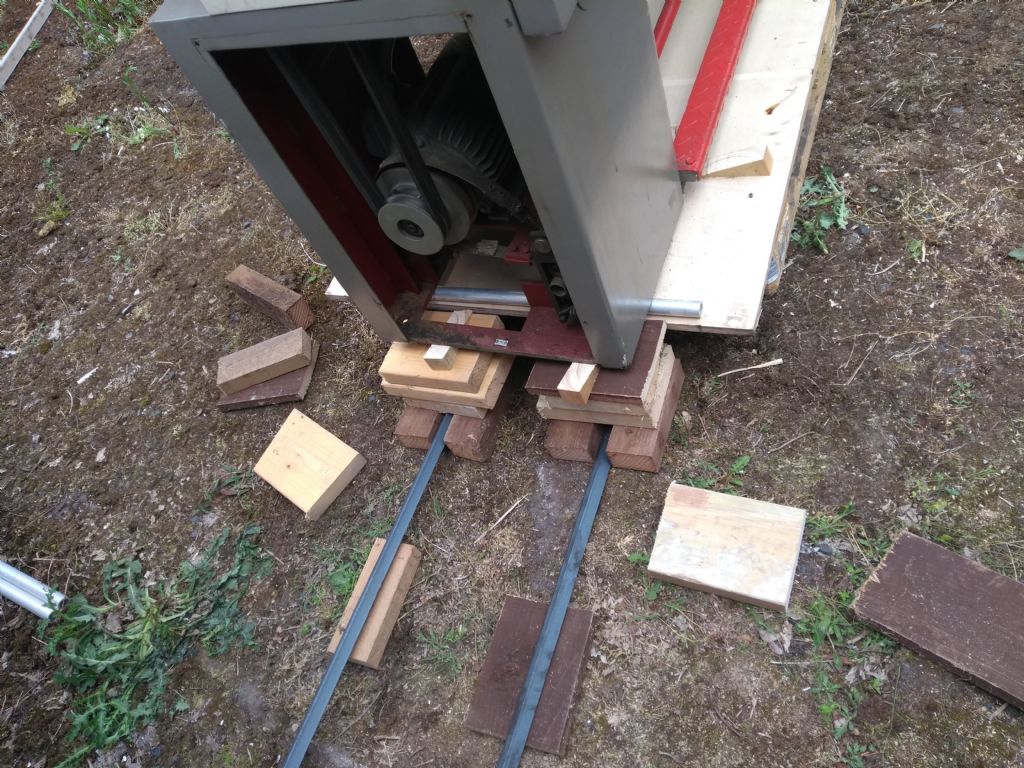

              But after carefully dragging the pallet out and seeing this:
              Well, to my simple mind, lathes should be on the ground, not levitating up in the air. (By the way, Clive mention a removable suds tray. It can indeed be removed, but only from the back. It was only just before I finally parked it for good I realised it had been put back in the wrong way round, explaining why the drain hose is attempting to cool the motor rather than draining to the suds pump visible on the left).

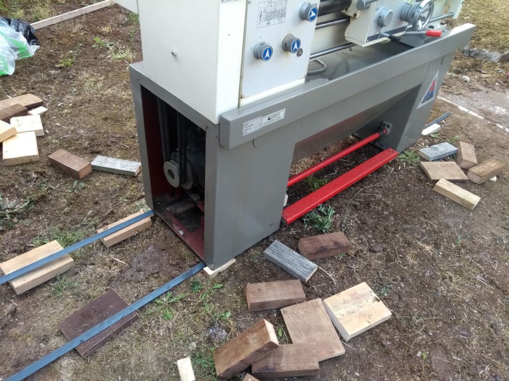

              Getting it back down was precarious. I should have been a lot more careful about blocking it up, as you can see here:
              As we worked down, that pile of blocks next to the footbrake ended up getting pushed over as the lathe tried to move sideways from the repeated lifting and setting down. About half way down, the pile gave way – fortunately it moved all of a centimetre before landing on my pry-bar blocks. It wasn't until I saw this photo in retrospect that I realised quite how careless I was being with the height I had raised the lathe. Incidentally, another thing I learnt doing this was that saving a tenner on a pry bar seems like a false economy when halfway through a move you reflect that if it breaks, it has 500kg of lathe on one end and a bag of flesh (mine) on the other. That said, the adjustable pry-bar was really helpful, and I'm glad I didn't just have a plain one. FInally, however, I had it down on the rails:
              At this point, I had somewhat optimistically expected that the lathe might glide upon the rails as a swan upon the lake, perhaps with me providing a gentle hand to steer it. Nope. I put my shoulder down and pushed. Nope. I roped in my mother, more in hope than expectation given that she weighs about the same as a dormouse and could do with two new hips and a lung transplant. Our combined efforts moved it a good half inch before we called a halt. Plans C, D, E, and F were quickly drawn up and discarded before we returned to the wisdom of the ancients, specifically Archimedes. If one inserts a pry-bar between the base and the ground, and then lifts up, the lathe moves forwards 2-3cm each time. As a form of locomotion it leaves much to be desired, but a few hours later, it was inside the workshop, the door could be locked, and I retreated inside for a most necessary libation.

                The next morning's work was rather easier: I neglected to take pictures, but I had put together some dollies that I was confident could carry the weight safely, and while blocking it up, moving it, and dropping it down again was frankly a pest – it's been a while since I've had to work so hard! – the process was much less of a struggle. For now it's sitting on some bits of timber which have got it surprisingly close to level:

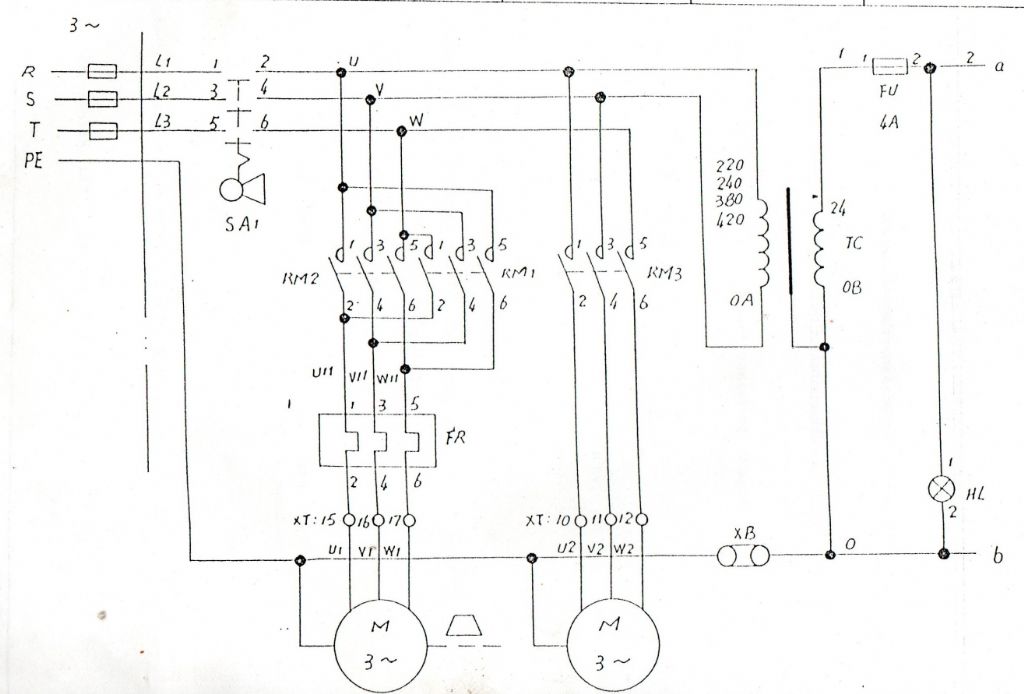

                      2. The electric lead into the machine has four cores, for three phase and earth. But…all three conductors are black, and I can't trace where the incoming conductors go in the electrics panel without undoing screws. Am I risking magic smoke if the machine ends up getting fed the wrong rotation? Or will it just go backwards? I have a very basic schematic of the electrics, which suggests nothing should go bang:

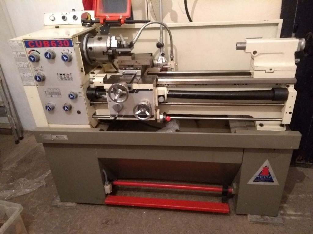

                        Well your newly acquired lathe looks like a really good buy. From your photos it appears to have had very little use, does it look like it's ever done any work at all?
                        Anyway, as soon as you can, let's have a vid of it running with the various knobs and levers being twiddled with. Very interested to see how it goes.

                          If connecting a true 3 phase supply you are right to believe if phases not correct it will turn in reverse if fwd selected, no damage should occur.

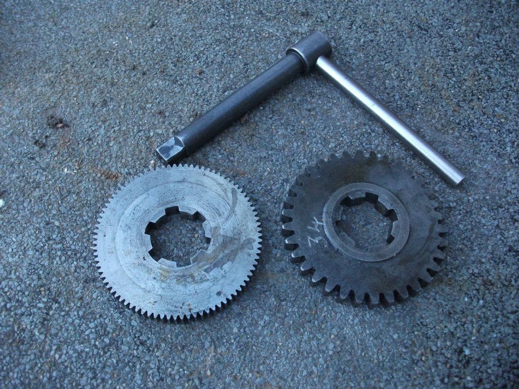

                                Hi Calum,

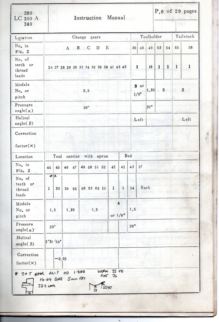

                                You should have the changewheels listed here as a set in the second line
                                down ,there is unlikely to be a 26 tooth i think is is a printing error as there
                                no listing in the changewheel setup for a 26 gear .
                                There are some differences between the Warco machines and the Chester
                                supplied ones , i see the motor is mounted now in the lower plinth ,mine
                                sits on the back of the lathe bed , the Warco machines have some small
                                tool lockers in the front and rear plinths.
                                I guess the lathe itself will be very similar the changewheels have a six
                                spline hub as in the photo .the gear alongside is one of a set for a true
                                metric to imperial conversion and has a fabricated spline.
                                The key here is for the D1 5 socket ends the square is 11 mm and 13.5 mm
                                long the stem length is 130 mm ,unfortunately there are no markings to indicate
                                the closed positions of the cams as on some British machines and no detents
                                either to hold in the open position so you need to ensure the scribed lines
                                are in alignment before trying to remove the chuck.
                                They are clockwise to tighten i suppose you already know this ,it is just
                                possible that they may have been tightened up in the other direction they
                                will hold just not very well so just check as you will never get them off
                                if this is so.

                                  Well, the electrics are now hooked up, but the machine does not go brrrrr. I have gotten the multimeter out and checked there is indeed the vital electric juice running as far as the socket. I haven't tried the plug yet as I can't figure out how to dismantle it: it clearly requires a bit of force but I'm not sure where to apply it, and even I can't screw up wiring a plug that badly…
                                  This light, helpfully labelled "HL" on the panel: am I right in thinking that should illuminate when the machine is turned on?
                                  There is an isolator switch on the side of the machine, which I have remembered to turn on!
                                  I have looked at the microswitches on the guards and all seem to be in their working positions: have I missed any? I know about the chuck guard, change wheel cover, and footbrake. Are there any other ones I should check?
                                  Next step, I guess, is to open the electrics panel do a visual inspection, and start testing for the presence of electric juice within the box. I suppose there is a fair chance something has rattled loose in transit, though I hope not. I am hoping there is something daft I am overlooking, as opening the panel means moving the b***** thing again!

                                    But first to start tracing how far the current goes through the circuitry. Multimeter to the fore.
                                      One microswitch you may already have checked but haven't mentioned is the 'e-stop' the big red button to the right of your circled 'hl' switch.
                                      Push it in to break the circuit and twist it until it comes out.

                                        Thanks Dave, I did check that but that's entirely the level of suggestion that I'm looking for, as I'm hoping it's something that simple! Warco did assure me it was running, so hopefully it's nowt tricky.

                                          Callum
                                          The control circuit is transformer fed 24volts and as you say with power on 3 phases with the isolator ON and the 4A fuse is good the indicator should be illuminated, any other switch in the control cct would not prevent it coming on, unfortunately the total control cct is not shown on the drawing posted.
                                          Emgee

                                          Calum
                                            @calumgalleitch87969
                                            Thanks Emgee, I do have a couple more wiring diagrams though the quality is quite poor, so I'll hold off posting them for now, I don't want to cause anyone to try and pore through them with a magnifying glass unless I have to!
                                            #552470
                                            Calum
                                              Well, turns out it was indeed simple. Once I got it away from the wall and the panel open, I noticed a couple of breakers inside, one for the main circuit and one for the control circuit. The control circuit was on but the main circuit was not. Pressed the button, turned the isolator switch on and we have life!
                                              Having pressed all the buttons and turned all the knobs everything seems to be there that should be. The gearbox is a bit fussy, requiring a bit of pushing or prodding or working out you need to come from the left or right to successfully engage a particular gear. I can't seem to find all the screwcutting gears, but that's not a major priority right now.
                                              I got the changewheels off, and I've got a 26, 27, 28, 30, and a 36, so I'll need to acquire the rest at some point. Again, not a major issue. Odd thing is that doesn't seem to be a listed combination for anything on the front panel charts!

                                                  Once you have the changewheels, probably find a chart listed for the machine, on Google, (Grizzly perhaps? ) can be found., to give the feed rates and standard thread pitches that are available.

                                                    Sorry Howard, I was a bit vague – I've got the charts on the front of the lathe – what puzzles me slightly is that the combination of wheels I have isn't actually one of the listed combinations.
                                                    For new changewheels, are Warco/Chester likely to stock stuff like this as parts? Or is it a case of buying a module cutter and dividing head and getting on with it?!

                                                      Hopefully, Warco, or Chester may still stock any gear that is missing.
                                                      Having a Norton box, you won't need as many changewheels.
                                                      My lathe has a Norton box giving 48 possibilities and the changed from Imperial to Metric usually requires just a 120 /127T idler to be moved. For some metric pitches the normal 40T input gear has to be changed to a 32T.
                                                      If you take the measurements of some of your changewheels, you MAY find some from another machinje that can be adapted, possibly by boring out or bushing the centre or modifying the keyway, (Either widening and deepening the current one, or cutting a second, narrower and shallower keyway on the opposite side of the bore.
                                                      (See below, to find the Module, and what Arc Euro, or Axminster could offer as spares for say, a Sieg C6 lathe.
                                                      My lathe also came with a spare 30T gear, which when used to replace, fortunately, the standard 40T as the first driver in the train, allowed a 4 mm pitch to be cut..
                                                      Wanting to halve the standard finest feed rate.0.0047" (0.120 mm) and having a Rotary Table and Dividing plates, I bought a 1.25 Mod cutter and made a 80T for the input gear to the Norton box, In my case, this required relocating the fastening for the gear cover. A 20T first driver would have been too small over the shaft.
                                                      Presumably you already know how to find the Module of the gears?
                                                      If not: Measure OD, Count teeth, Add 2, and divide that number by the OD.
                                                      Thus a 1 Module 60T gear will be 62 mm diameter. A 1.5 Module 60T gear would be 93 mm diameter.
                                                      Ivan Law's book "Gears and Gear Cutting", No.17 in the Workshop Practice Series is a useful aid when you start cutting gears.
