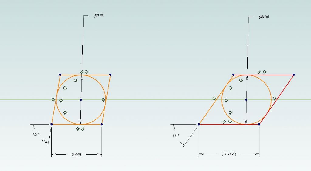

                          Slight error on my earlier post, an 06 insert has a 6.35IC not a 6mm one
                          in most cases these code numbers bear little resemblance to the actual edge length (triangles are close) as a quick sketch will show.
                          On the left a typical C shaped insert eg CCMT size 06 and on the right a typical D shaped inset eg DCMT size 07, both have an IC of 6.53 but the edge length is neither 6mm or 6.35mm so best way to see what you have is to hold a bit of rod or a drill shank of the right IC ontop of the insert and see how it fits. On 4 sided inserts you can measure between two opposite parallel faces which will also give the IC. Click for larger image

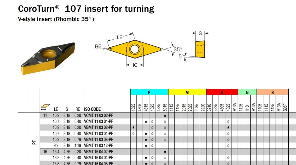

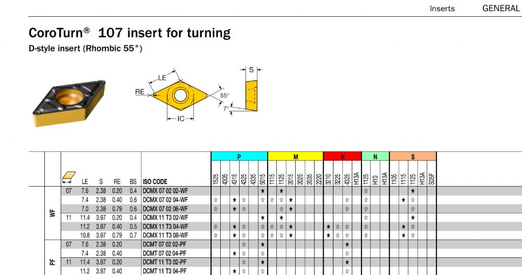

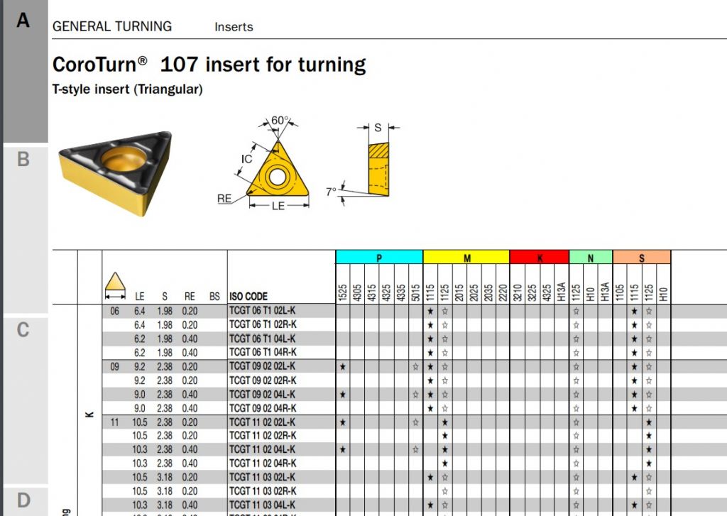

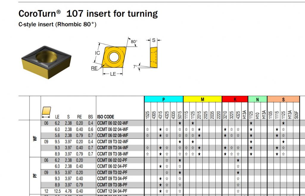

                            To further explain Sanvik inserts information below, it is easier to see on the 35 deg VC type it is LE+RE, so is the projected length of the cutting edge from the centre of the insert to the tip.
                            Although the IC of the enclosed circle is mentioned no dimension is given so doesn't assist in identifying the insert size.
                            Emgee

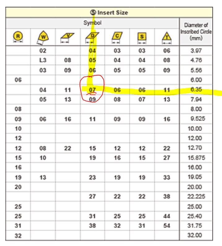

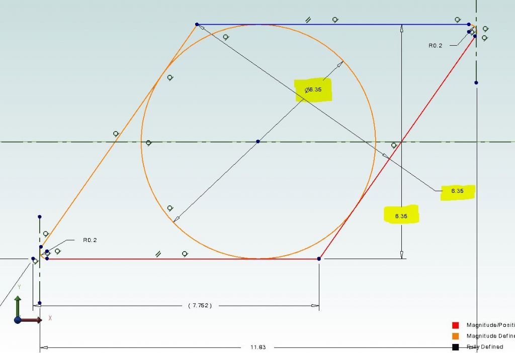

                                This is the simple way based on IC size:

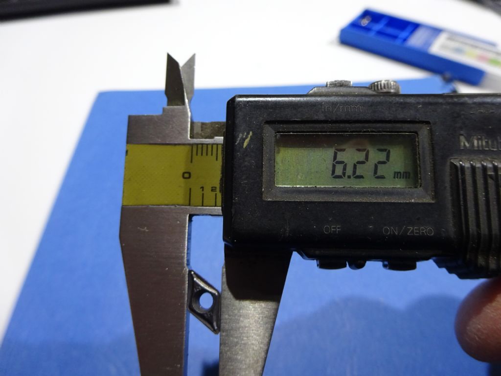

                                I've added a tip radius of 0.2 to that D shaped insert and highlighted the 6.35mm IC (1/4inch) I have also highlighted the two easy options to measure distance between opposite faces and highlighted those also at 6.35mm which can easily be measured with digital callipers.
                                Note there will be a tolerance of this size so could be 0.15mm difference but as the common IC sizes jump by 3.175mm (1/8inch) should be easy enough to tell which IC you have.
                                All you then have to do is pick a chart both the MSC virtual catalogue I posted earlier or the Mitsubishi link in the post above will do. Along the top pick the shape code that you have already identified in stage 1 and then come across for the IC size just measured and that will give you the size code (not actual size)
