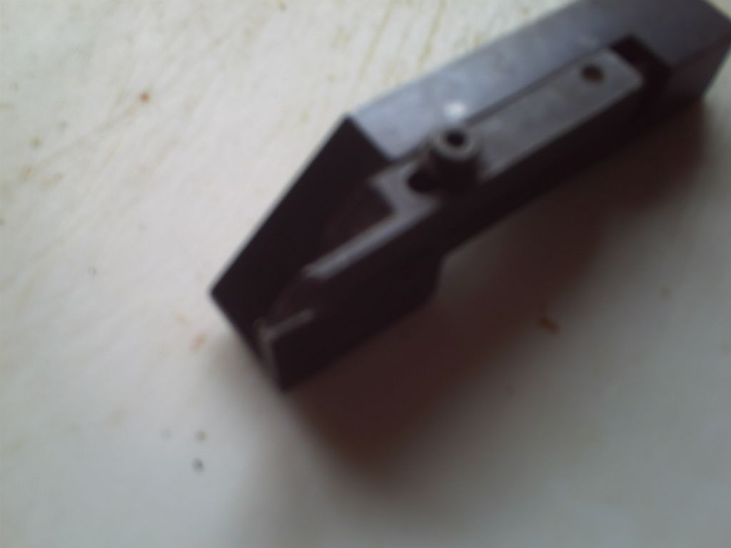

      Can anyone identify this holder which I picked up many moons ago and for which I cannot seem to find tips ?
      The tips in question are about 12mm x 3x 2 and have a raised vee section on the underside which mates up with a vee groove on the holder.
      I have checked all the ones on Ali Express and none of them seem to suit.

          Try a search for MGMN15 type inserts, the width are the numerals at the end, 15 = 1.5mm.

                I would be very wary of this type of toolholder. The common types of MGMN— types do not tend to have a bolt on end, and I suspect it is from one of the many makers who do similar double ended inserts. The trouble is that their sizes which initially look the same are proprietry. However, if you do get some MGMN's and they don't fit, a holder for them will be easily and cheaply available on ebay.
