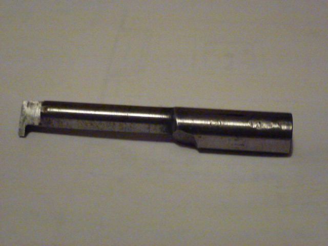

              Clive Brown 1
                @clivebrown1
                You could make a screwcutting tool from silver steel which can be machined or hand filed before hardening. Photo shows one made from 3/8" dia. ss. that I used to cut a 5/8" dia. x 8tpi square thread for a feed nut for my Raglan mill.p1020854.jpg

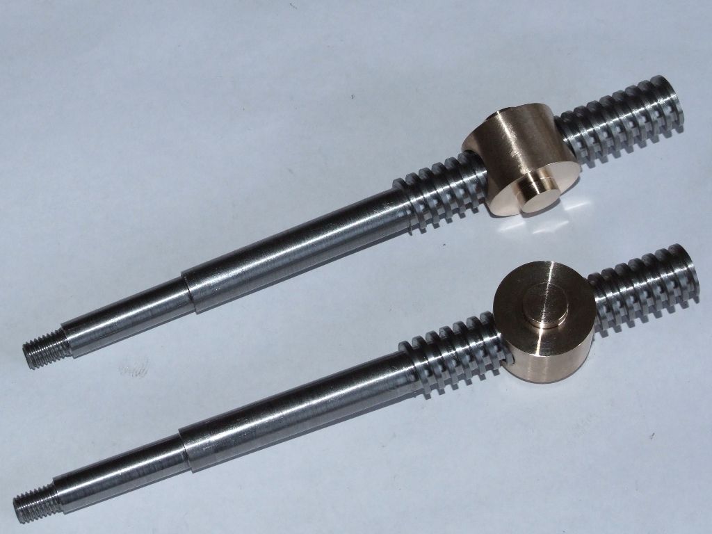

                    Square threads are not difficult to cut, but are a pain to get the fit correct. These are 1/2" x 8tpi:
                    I made a set of serial taps to cut the nut:
                    But it would be simple enough to grind a tool as shown by Clive. I chose to make taps just to prove that I could, and a 1/2" OD means the ID is 3/8" which I thought was a tad small for single pointing.
