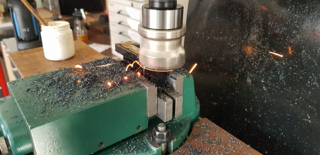

        I recently took delivery of some milling cutters that had been stuck in a closed Argos store for over a month. One such item is a used 6 insert 50mm facemill. I used it last night. Not sure if I was using it correctly. I think it originally came from Arc euro tools. I fitted new inserts & checked each insert was touching off & they were. I ran the machine at 1000 rpm at 1st. Then slowed to 800. The material I have mentioned in previous post & is steel. I have no idea of what steel it is other than it is blooming hard. They are Chinese quick change toolholders that I need to take 4mm from the lower face. I have done 4 others in the lathe with a 4 jaw chuck & that was hard going. I tried with a HSS flycutter & it just took the edge off pretty quick.
        So now I have the mill I did some work on one. It did cut the material , I took 0.1mm depth per pass. ??? I took a total of 1mm before retiring. The main question is & the inserts were carbide. Is it ok for sparks to come from the cutter. It looked pretty but not sure if this is ok or not. After use I removed & inspected the inserts, which were all perfect. No burrs or chips on any of the 6. The finish was like a mirror. Nearly but very good. I tried it dry & with cutting oil. Either way it was the same. Bonfire night.
        Any input please. Do I need to run faster deeper , ???. I did get 2- 63mm mills too, which looking up are pretty expensive items. One is a 6 cutter one which I believe is marketed by Sandvic. The inserts alone cost an arm. But some members have already said my machine may not be able to handle them. From using the 50mm one I think they may be right.

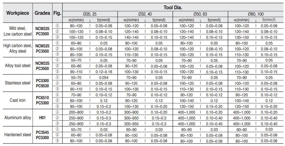

                        This is the chart I have been using for the face mill inserts, they do give speeds for hardened steels but as I said it needs a specific insert grade. Several of the other makers don't give cutting data for hardened steels for these style of inserts but do as Andrew says for traditional milling cutters

                          Posted by JasonB on 08/05/2020 08:14:12:
                          Posted by not done it yet on 08/05/2020 07:51:29:
                          Little point in having six inserts, if only one is doing any work.🙂
                          In this case it may have been an advantage as Stevie will only have blunted one out of the six insertssmiley
                          No I have not blunted any of the inserts. I made sure each one scratched the surface. Also watching one of your video's as the cutter works it's way across the work it re-marks the surface the other way. Proving the tram is ok. ??
                          So from your remarks about origin. I went out into the sun to see if I could make out which inserts are in. I noticed some faint writing on the side of the cutter body. Mag glasses on. It says Iscar, HM90-FP0AP-10. HELI2000.
                          The inserts maybe wrong as you say. They only say M9. Dark in colour.???. However I do have quite a lot of ones that came with the other stuff I bought. Which maybe correct. HM90 APKT 1003 PDR. If that makes any sense to anyone. I think it maybe Steel & Stainless. See pictures.I also have some Kennametal ones which I cannot identify. The Iscar site shows the cutter but too many settings for my grey cells. I think reading between the lines it was saying 1200rpm & 0.8mm depth of cut. Does that sound right.
                          From memory of cutting down the holders when the lathe was used. The 1st 2mm of cut was terrible but once below that it was not as bad. So does that indicate they are case hardened. Also do I do as Andrew advises & have a go with the carbide cutters which I do have.
                          Steve.
                          Edited By Steviegtr on 08/05/2020 11:50:16

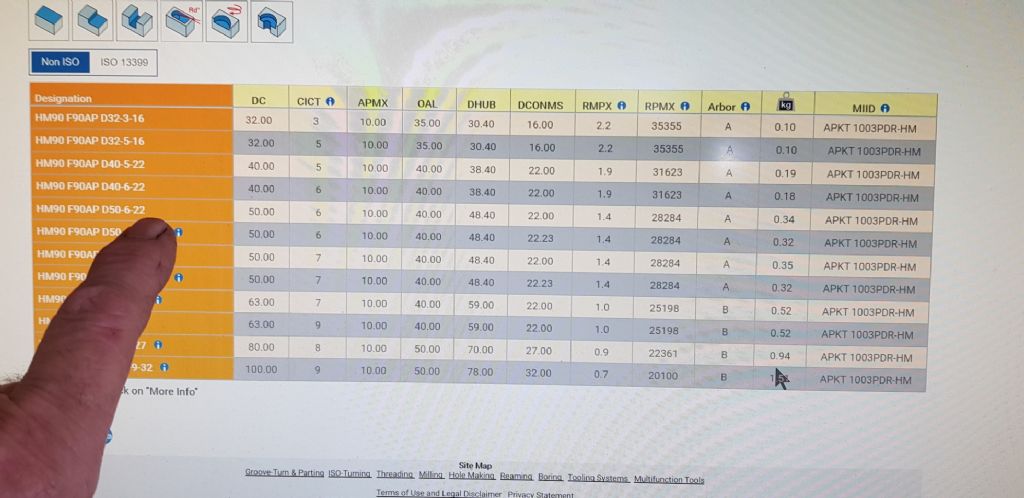

                                Nice cutter, but the spec shows it's good for up to 25,198 rpm and 10mm depth of cut (with internal coolant). It's a metal muncher designed for a heavy fast rigid machine with tens of horsepower behind it. Tom Senior never designed a mill for a cutter like that beast. Probably still useful though.
                                As it won't be possible to drive the cutter as the manufacturer intended, experiment for best results. Which combinations of material, rpm, doc and feed-rate work with a 1/2HP motor and a decently rigid small machine? I doubt anyone knows – it's a suck it and see job.

                                  Thanks for that Dave. Yes best just to try various speeds & cuts. One thing I have taken from this is the speed for carbide is best high. Might not reach the 28,000 though. I will change the inserts for the Iscar ones as I think they are for steel & not sure about the ones in there at present other than it says M9. In JasonB's chart for a 50mm cutter, what is the Fz mm/t for. It says 0.05- 0.08

                                    Posted by Steviegtr on 08/05/2020 12:34:06:
                                    …..what is the Fz mm/t for. It says 0.05- 0.08
                                    Chip load; the amount, in millimetres, a tooth cuts per revolution. To get the feedrate multiply the chip load by the number of teeth, 6 in this case.
                                    Andrew

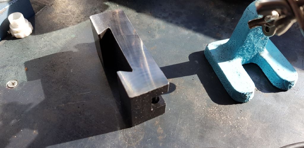

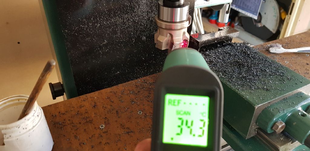

                                                    OK guys. Back on track. Having spoken to a mate on this subject, who does a lot of machining of things like brake discs etc.. Something was explained to me that I tried out. he asked if I had a digital temp gauge, which I have.
                                                    He said do a cut across the face at around 0.25mm per pass. Do not go too fast. Shield yourself from the sparks. Carbide tooling on hard steel sparks like hell. Get your temp gauge ready & as soon as you stop take the temp of the part & the cutter inserts. Which I have done. To my surprise the part was cool & so was the cutter inserts. I did this through to 3mm of cut with no noticeable increase in temperature. The chips were around 5mm long & blue of course. I ran the spindle at 1250 rpm.
                                                    I then removed the cutter & inspected each insert. There is no wear on any of them. He said mild steel should not spark but hardened steel does & this is quite normal. I of course have no idea but everything has turned out so far as SOD says suck it & see. Pretty pleased with the results so far. The finish is like chrome . Pictures & also one of my makeshift shield which worked just. I did not push the feed rate but the machine seemed to stay stable & no drop in rpm.
                                                    Steve.
