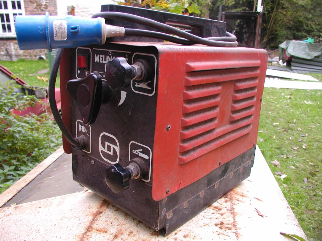

                        Hi, it's not just the welder you need to consider, most of the DIY welders will do what they are basically designed for, which is usually light work and short duty cycles. The other important thing to consider is the power supply feeding it and they very often need a large inrush of amps to get them started, so therefore a 13A plug in one won't always live up to expectations and will probably work better off a dedicated 16 or 30 amp supply either wired in or plugged into a 30A industrial type socket. My stick inverter welder is a brilliant thing and will weld quite thick steel, it's a 110V / 230V, supply but it has to have a 30A supply rating on 230V to even strike up a arc successfully on it's lowest setting with even a small welding electrode and it's duty cycle is; 35% @ 130A, 60% @ 115a and 100% @ 105A welding current. My old transformer SIP MIG welder worked better from a 16A supply but it was still a bit limiting as to metal thickness that it could weld as it is more or less designed for car bodywork. I did however, extend the duty cycle on my really old transformer stick welder, by adding a fan beneath the air vents in the bottom of the casing, but I don't really use that one much now although it can come in useful for a bit of light TIG work on aluminium but even that is better on a 16A supply.
                        SIP welder
                        Underside
                        One thing to remember is the thicker and/or heavier you want to weld, the higher the power supply will be needed.
                        Regards Nick.

                            I have an identical SIP welder which I used to build car transporter trailer. It would cut out after around 10 mins heavy welding. I fitted an aluminium cowling on the rear and fitted a Expelair fan. Could then run well over half an hour before having to let it cool for a few minutes.
                            Colin

                              Hi Andrew, used a few of the 300A 3 phase ones in my day jobs, I think it was a small 240V single phase one that I borrowed from my brother once many moons ago.
                              Regards Nick.

                                  Hi Colin, I think your times are about the same as I get with mine with the fan and the fan will cool it down faster as well, after it cuts out. I actually bought mine after winning £50.00 from my National Bonds, never got anything from them since though.
