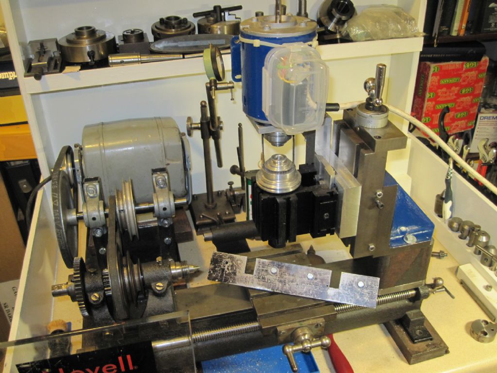

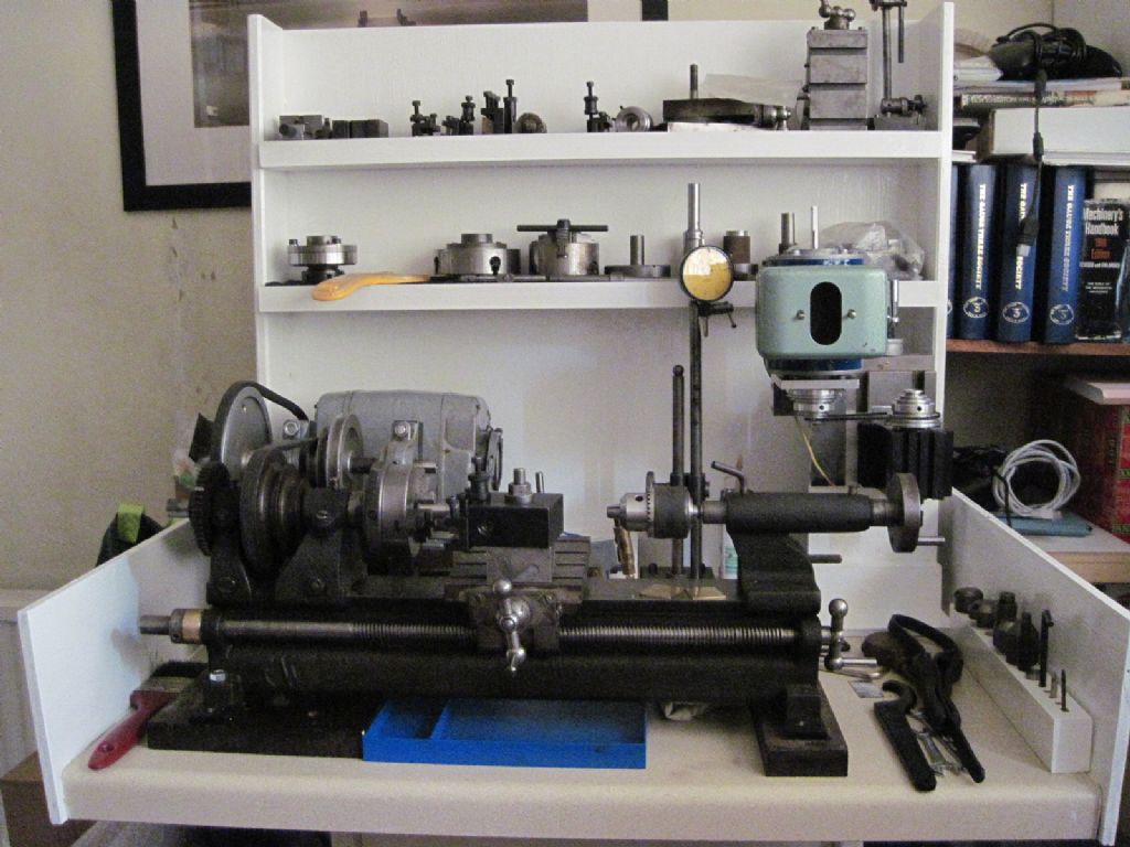

            I would think any small lathe would do Dominic – either one of the new Chinese mini's or something a little older – Unimat, Cowells or similar. As always it somewhat depends on what you want to make with it.
            I have a small EW lathe (2.5in) that is gradually evolving over time and it is very useful for smaller inside work during the Winter, although I have the benefit of a Super 7 and Lorch in the Shed. With a little bit of ingenuity you can do a lot of work on a small lathe – just don't expect it to remove metal fast….
            Mine is mounted on an old printer table and has recently grown some shelving and a small milling attachment.

                IanT thanks for the pics. Food for thought! I have been looking at the Chester conquest, as it would fit in the space I have. Although an automatic/powered feed would great for better finishes. I shall look at those you mention.

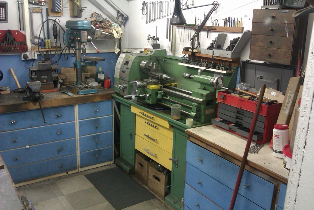

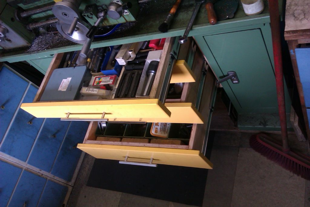

                          #164496
                            Its not to hard to make more use of one of those stands by removing the central panel and filling with something more useful.
                            Though for the cost of the Chester/Warco stands you could get two 2nd hand Bisley draw units and an offcut of kitchen worktop or old fire door which would make useful storage and bench.
                            Edited By JasonB on 24/09/2014 11:08:40

                              I'm a big fan of mini-lathes, but I really think that squeezing one in such a space, though possible, could make many things so awkward it could limit the use and pleasure you get out of it.
                              I would consider a smaller machine that you can lift out of the way and store on a shelf or cupboard, so you can also use the space for other purposes.
