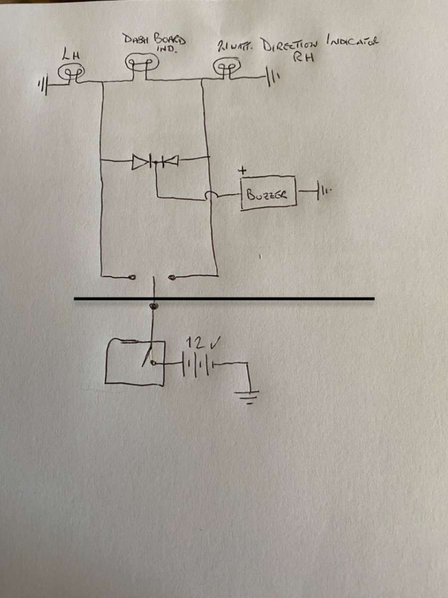

      Electronic help please.  I have a 1979 Mini, simple wiring, no MCU etc.  I need to add a BUZZER to the indicator circuit.  Currently when a direction is chosen, the dashboard indicator is energised by the +12 volt supply from that circuit with the earth return via the lamps of the opposite circuit.  I assume this works as the indicator lamp is very low wattage compared to the 2 x 18watt bulbs and a 5watt repeater bulb.
      The flasher unit is a simple 2 terminal unit (Made complicated as the replacement I use requires an earth [not shown] because the internal gubbins is some sort of electronic thing).  It does not have a terminal for a repeater lamp.
      I need to add a buzzer to the circuit which happens to be a polarised device.  Can I simply add a couple of back to back diodes to give me a positive feed to the buzzer irrespective of the chosen direction.
      I can’t add it to the flasher unit as there is about a constant 6.5 volt on the delivery side of the unit and the buzzer sounds all the time !.

        Not worth the hassle of making, just buy one, But Ah why do you need it ? Not for a trailer then ? Put 2 buzzers one in each indicator circuit. or even buy a trailer device and use it as a bulb failure warning even. Noel.

          I need it as the self cancelling does not self cancel on moderate turns and I need a reminder. Some day Noel, you may need one !
          Anyway, where is the spirit of discovery ?

            I did exactly this in a Caterham about 15 years ago, memory is not great but I’m pretty sure I did exactly what you have drawn above.

              What you have drawn will work perfectly.
              Just about any diode will be OK. I’d suggest a 1N4001 (or any froom 4001 to 4007)
