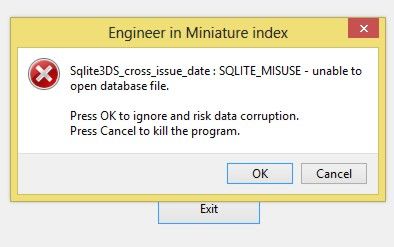

                    Thanks for the info, I have down loaded it for all three magazines two of which open successfully and are very useful, the third however won't open, I get the following message; SQLite 3DS cross issue date SQLITE MISUSE unable to open database file.
                    Haven't a clue what it means or how to get over it, was hoping Dias Costa or any one else
                    John for that matter might see the query and point me in the right direction.

                              The Index in question is E.I.M. I have downloaded all three sets of Files and placed them in a separate folder. M.E. and M.E.W. both open O.K. and work well, but when I try the E.I.M index I get the message;
                              Sqlite 3DS cross_issue_date : SQLITE_ MISUSE_unable to open database file.
                              Press o.k.to ignore & risk data corruption.
                              Press cancel to close.
                              #161036
                                Hello Dias,
                                I updated a couple of days ago, and only tried the EiM index when John reported the problem.
                                I get exactly the same error message and clicking OK just closes the window.
                                ME and MEW both work OK, so perhaps a data corruption issue?
                                I'm using W8 and I have all the files in the same folder.

                                          dcosta
                                            @dcosta
                                            Hello John and Neil.
                                            I have made ​​small attempts to find the cause of the problem but have not had success so far.
                                            There is, however, one thing that I remembered: during the construction of the program, in testing, that message was presented to me a few times and at that time I found that the problem was a result of the data structure used which is more complex than those used by MEW_Index and also by ME_Index.
                                            I hope to during the next week-end to solve the problem and release a new version of the program.
                                            Almost forgot to say that here, at home, the program works without sending the message.
                                            Thanks for your patience.
                                            Dias Costa

                                              dcosta
                                                @dcosta
                                                Neil: it's hard to track down a fault you can't see.
                                                DC: Yes you are right. And a long time passed since I made the programm.
                                                Haved you by any chance made some change on the data in the form "Cross issue by date (Maintenance)" or used the option "Import from an Excel file"?
                                                Couldn't find, yet, the cause of the problem.
                                                Meanwhile I've put in my site a EiM_Index ziped file with new data base file.
                                                Please download it, try it, and let me know what happens.
                                                Thanks in advance
                                                Dias Costa
                                                #162605
                                                  Hello Dias,
                                                  I haven't made any changes.
                                                  I overwrote the old files with the new ones, and got a different error:
                                                  Still working for ME and MEW. I'm on W8 by the way.
                                                  Good luck!

                                                    John Weight
                                                      @johnweight34532
                                                      Hello Dias,
                                                      Thanks for the update,I haven't made any changes either. Have downloaded the new zipped File, 20140903164937 regret to say the result is the same. I get the same message as Neil.
                                                      Regards,
