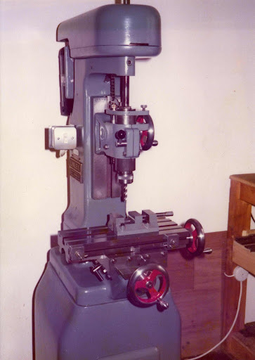

      I bought this small machine in 1977 for the sum of £114 plus a Rodney milling attachment in part exchange. It had no motor and no collets but despite it’s tatty paintwork and the score down one side of the tee slot the bedways were sound without a scrap of wear movement. The seller – GW Machine tools in Norfolk told me it was originally sold as a jig borer but at the time I put this down to sales talk but apparently this is true. When I initially stripped it down I was surpised to find that the leadscrews were ground – perhaps he was right. Last year when considering another machine I was told by someone at Warco -consulting from a book on milling machines that this was indeed so. – he also confirmed after all this time that the collets required were Schaublin.
      This is the only pic I have of it as purchased but stripped ready to clean up – it’s sitting in my third bedroom which was my workshop for many years – yes a bungalow in case you’re wondering.
      This shows it after that initial strip and repaint. You will notice it has a very small table -just 16″ long with only 9″ of travel but a good 6″ travel in the Y axis. Its a very substantial piece of kitvery heavy and quite rigid. The early attempt to make a collet and nose piece was not that successful and it was not long before the first modification began.

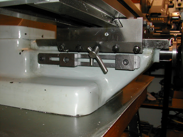

          The increase in versatility that the draw bar gave was soon realised but the mill had one big short coming in that it was too short! That cast iron base it sat on was very substantial but far too low. The cross slide handle was at mid thigh level and I’m not tall!
          At some stage a decision was made to move it to a welded steel bench previously made and incorporate a drip tray too. At the same time I decided to strip it again and replace the bearings in the headstock. This time the paint was stripped off to the bare metal and repainted with some twenty coats of primer – one in the morn, one at night – house had the faint whiff of cellulose for a few days! Two coats of polyurethane grey top coat gave a finish that, the odd chip aside lasts to this day.
          When that new Bridgeport arrived in 1986 I had to ask, well you would wouldn’t you?. So a pattern was made and a new table and handwheel bracket cast at the local founders – now gone and sadly missed. After taking the skin off it sat outside for well over six months before a succession of Friday afternoons saw it milled. A leadscrew was cut too and a new nut made but it would be well into the late nineties before it was finally fitted.
          I found this photo today – it shows the small table still in use and the part is off the
          BR2 which was worked on from ’92 -’96 – I think the table was finally changed around 98-99. It’s also now in the outside workshop. As you can see that table really is quite small. Also note this is pre modification to the R/T. Completely jury rigged stops using clamps but it worked.
          The new table was made in proportion to the saddle roughly the same as the Bridgeport
          and gave a 24″ table with 16″ of travel. The original leadscrew is still on the saddle and has 6 thou of backlash which is not bad for something well over half a century old.
          An Ortec DRO was fitted about 2002 and this latest improvement in fitting a VSD brings it nearly but not quite to staisfaction – A DRO is required for the quill and I reallymust replace that old bolt with a neat handle on the down feed stop bar.
