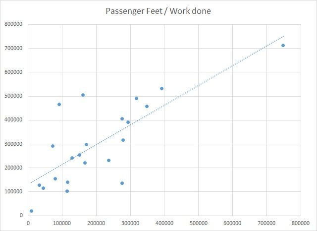

                        #253860
                          This is even sadder…
                          The trouble with looking at outliers is that they can be given excessive weight, we need to look at the whole dataset so it's graph time!
                          I also did a slightly different calculation that gives two comparable interpretations of the work done, although this doesn't change the relationship between teh two sets of values.
                          Assuming the force required to pull the train is proportional to the number of passengers then as work = force x distance moved, the number of passengers x distance travelled (passenger-feet) should be proportional to the work done – indeed this is the way that the work done was calculated in the halcyon early days of IMLEC).
                          So I plotted work done (Y axis) and Passenger feet (X axis). I assumed that when passengers were dropped this was at the half way point. There's huge scatter which we might expect, (especially if some drivers do 'negative work' holding the train back on downhills), but the r-squared value is 0.6. When I added in the driver and observer (I forgot them so not on this graph) teh fit is even better and has an r-squared of about 0.7 which perhaps isn't bad given the high number of variables and idosyncracies involved?
                          Edited By Neil Wyatt on 03/09/2016 16:09:34
                          #253864
                            Another observation … the two dots furthest to top left above the curve had relatively small numbers of passengers (4 & 7). The outlier furthest off the line to the bottom right had 28 passengers. Clearly some trains with small and large numbers of passengers were on the line, but maybe this is another confounding factor.

                                        #253978
                                          There is at least one glaring oddity in the table:
                                          Paul Pavier ran with 15 passengers for 27 minutes 30s and covered 18,397 feet.
                                          John Cottam ran with 16 passengers for 30 minutes 10s and covered 17,435 feet.
                                          The table says that Pavier only did 136,949 ft/lbs while Cottam did 316,068.
                                          However as the figures also state that Pavier used 1 1/2 times as much coal to do less than half the work of Cottam, but give him a higher efficiency figure, I have to conclude that there are some errors in the table!
