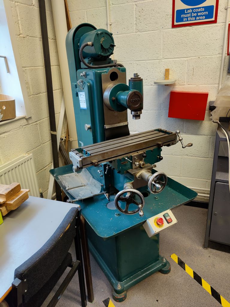

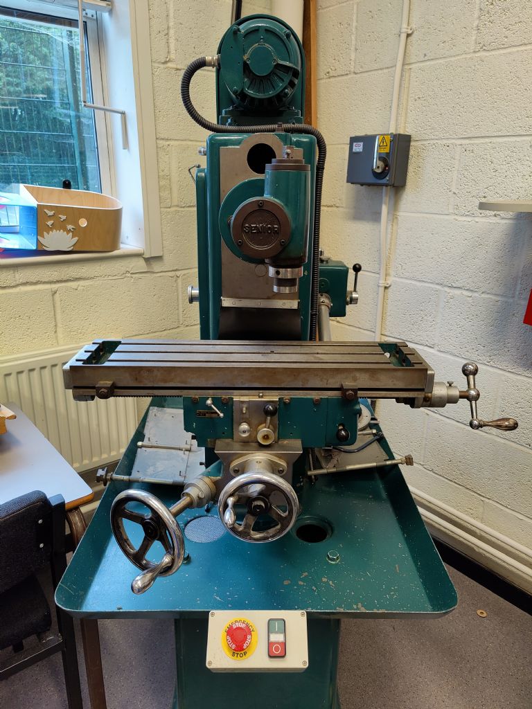

      Hello folks,
      I have recently started working as the technician at a secondary school DT department and I'm trying to get all the machines up to speed (so to speak) as many of them are very elderly and have not been used for many years.
      One such machine is the milling machine. The department head is keen to get it back in to use but I know very little about it and to be honest it's many years since I used a milling machine and the ones I used were very different.
      I know it's a Senior, the serial number is M.I. 1789 and hopefully I'll be able to attach a couple of photos here. Does anyone know about these machines or know a good resource they can point me at?
      Many thanks!

            Welcome to the forum, and you might like to have a look at Tony Griffith's definitive web catalogue of these machines (and many others). Follow the Lathes.co.uk link to the page for the Senior M1.
            As for how to use it, the series by Jason in Model Engineering is a good start, hopefully he'll be along shortly with some advice.
            Have you searched the department cupboards, you need a collet chuck (e.g. Clarkson Autolock) to hold an end mill in the spindle of the vertical head, also a work holding vice. Hopefully they are to be found?
            This machine is actually a horizontal milling machine with a bolt on vertical head, so you can use it as a horizontal machine as well. So (in another cupboard) you can find the overarm and outrigger support bracket, also a milling cutter arbour and some spacers, and maybe a few milling cutters as well.
            Hope this helps
            Best rgds Simon

                Welcome, you've come to the right place – and passed the intelligence test that is getting pictures to display in posts!
                The machine is indeed a Tom Senior M1, and looks to be in unusually good condition. They are simple, good machines, and sought-after, especially with the right-angled vertical head. Tom Senior was taken over by Denford. The machines have been out of production for at least 30 years (give or take), and spares are few and far between. Denford have put up drawings, etc. at **LINK** Go to 'Machines', then 'Senior'.
                It looks like there's a collet chuck in the vertical spindle, almost certainly for Clarkson-type screwed-shank cutters.
                Given what we hear about health and safety worries, I'm a bit surprised that you intend to use such a 'dangerous' machine within a mile of children. If I were you, I'd try to get the school to condemn it on safety grounds, offer a few hundred quid, and whip it off to your own workshop! However, if you can get the little blighters' heads out of their 'phones, and teach them how to do something useful with their hands, all power to you!
                You'll get a (fairly) sensible answer to any question here, so ask away!

                                  Hello Tristan and welcome to this wonderful forum. That a very nice looking machine and should be very useful.
