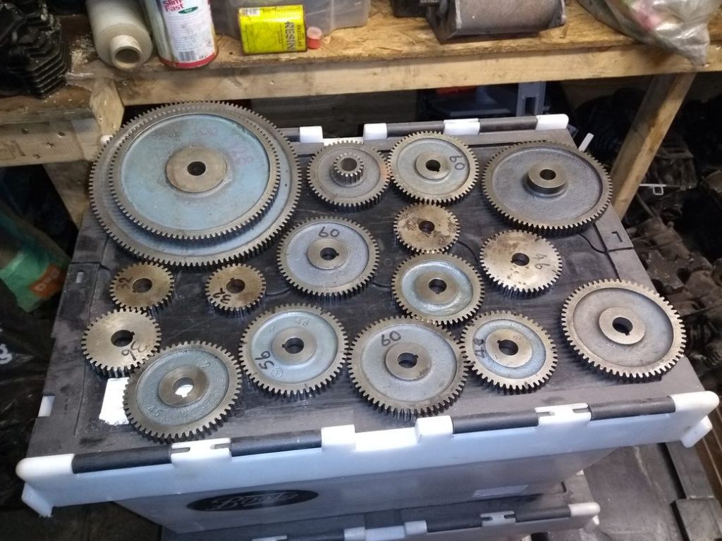

        A friend has asked if I can identify these gears for him. There came with his ML7 but are obviously not for that lathe. He wants to try to sell them, so any help identifying them would be appreciated.
        Hopefully I am attaching a photo, but the gears are as follows:
        100/127 compound with 5/8" bore
        54/18 compound with 5/8" bore
        80 with boss and 5/8" bore.
        The rest are all 9/16" bore with 1/8" keyway – 32 (2 gears), 36, 40, 46, 48, 52, 54, 56, 60 (4 gears) gears 2.jpg

          What is the overall dia in inches of the 100 tooth gear ?
          Regards Eric
          #330236
          wolrikm
            @wolrikm
            5.665" with my Lidl caliper
            #330242
            Eric Arthrell
              @ericarthrell78468
              Hello wolrikm ,
              I make that 18dp ? for the 100 tooth one no good for my Murad.
              Eric
              #330246
              wolrikm
                @wolrikm
                Mystery solved, I think. Looking at the change wheels Tony sells on lathes.co.uk, they are Boxford.

                  Look like Boxford to me

                    will they fit southbend 9" model c?
                    if so could be interested as got one needing restoration when i get new workshop
                    #330483
                    Clive Foster
                      @clivefoster55965
                      mick70
                      Size of Boxford change wheels is fine on a SouthBend C but I'm pretty sure the pressure angle is different so you will need to have a whole set. I think my C actually had Boxford gears. About 35 years to late to check tho'.
                      Clive.
                      #330486
                      Bazyle
                        @bazyle
                        Regular old Boxford gears have a 9/16 bore. It may be the specials like the 127 are different, or it may be that South Bend are 5/8 bore. Both will be 14.5 pressure angle and 20 DP, The new gear head larger Boxfords are possibly metric module gears wit 20 degree angle.
                        But there will be other lathes that are similar. We could do with a cross reference table.
                        #330488
                        Oldiron
                          @oldiron
                          mick70. If you want to fit them on your SB "C" you will also need the 16, 18, 20, 22 & 24 tooth Boxford gears as they are usually first in the drive train on the stud gear. Especially if you want to cut metric gears ( along with the 100/127 conversion gear). Smaller sizes can be picked up on Ebay reasonably priced.

                              The ones with a 5/8″ bore are used on the banjo and are missing their running bushes.
