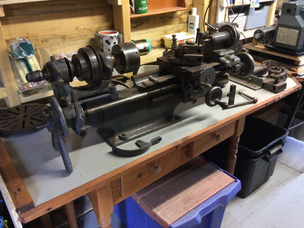

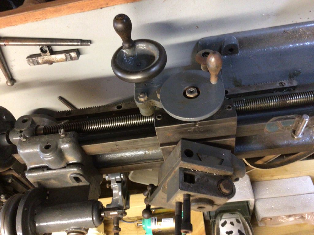

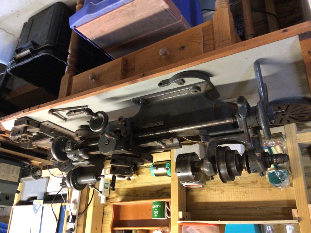

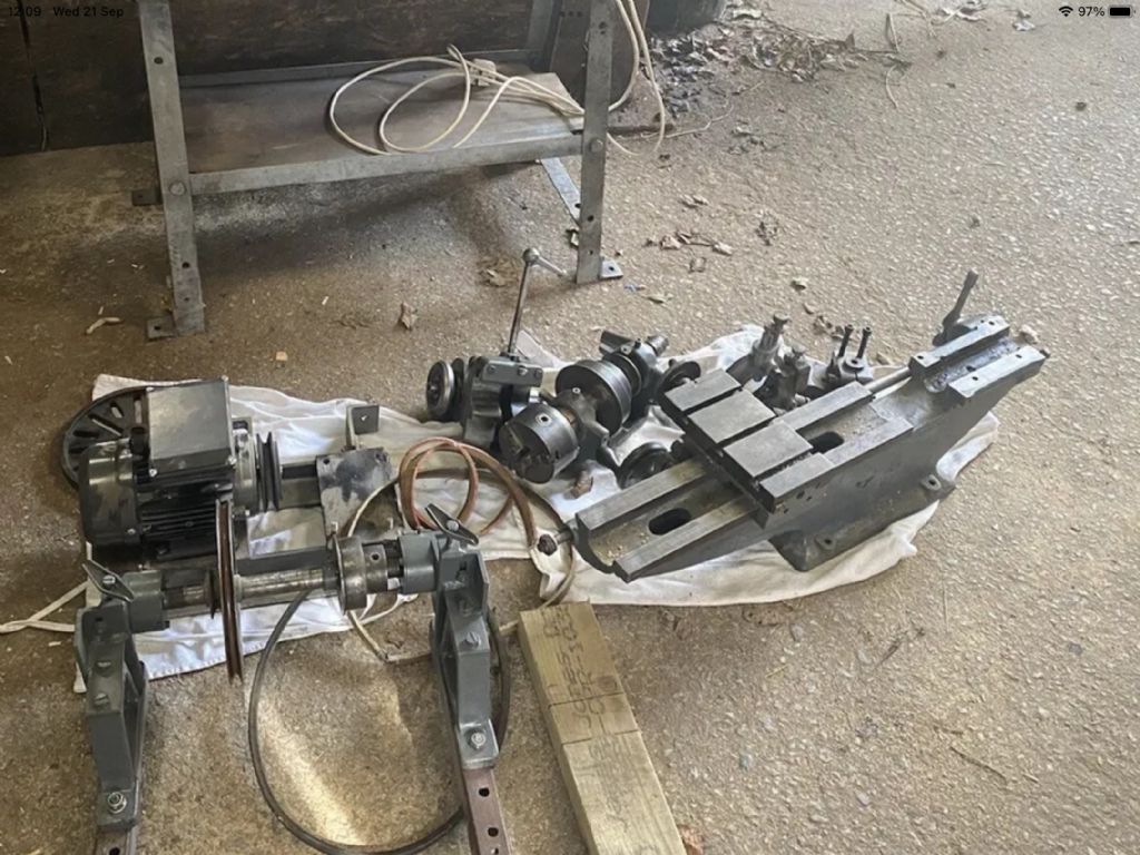

      Hi, can anyone tell me anything about this lathe I have just bought to restore.
      make,
      age.

          It looks in fair condition – at least, not a rust-bucket.
          You may find it helpful to re-photograph the parts arranged logically even if not assembled; and the right way round (headstock to the left). As it is about the only part that may be identifiable by manufacturer in the picture, is the bed!

              Looks like a Drunnond M series from the piccy
              Welcome to the nuthouse
              (keep every teeny grubscrew/washer you can find if anything drops out, it all finds a home eventually)

                Or maybe a Pools? A number of pre-war small British lathes took that general form, a front view with all the bits in the right general place would help. At the moment hard to see many distinguishing features.
                #614391
                Bazyle
                  @bazyle
                  The leadscrew clutch handle is a significant identifying feature.

                    Thanks, yes it does seem to match a Drummond M…..I collect it tomorrow….
                    just hope it’s all there….

                      Then say yes to everything, and scan the floor for bits. Refuse nothing.
                      Look for a box of bits too, nuts, screws, washers, cogs, flat bits, funny looking metal bits, take it all
                      Good luck
                      Edit: The 4 studs for fitting the headstock to the bed? you can see the 4 holes
                      there must be a box somewhere with them in if they are missing
                      And where's the backgear? that's a solid shaft with 2 cogs attached that goes on the back of the headstock
                      The tailstock shaft has been withdrawn, that has parts to tie it to the bed
                      There's a box of bits somewhere and you really really need them
                      Edited By Ady1 on 21/09/2022 19:22:14

                        Hi Haydn it is an M type Drummond Myford lathe. There are a few web sites with help with these.
                        https://m.facebook.com/groups/703113663087249
                        https://groups.io/g/drummondlathe
                        Here is a picture of my lathe.
                        Good luck and collect any bits that may evan may not look like it belongs.

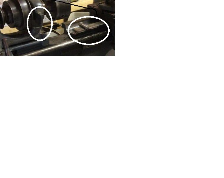

                          How certain is the identification? The reason I guessed it might be a Pools is these wings on the headstock:
                          David's Drummond looks different to me.

                            What I think is the tail-stock looks odd to me – has this photo been flipped left-to-right?
                            Best regards,
                            Swarf, Mostly!
                            #614447
                              Posted by Swarf, Mostly! on 22/09/2022 09:21:59:
                              It’s not sharp enough to check the handedness of the screw threads devil
                              … but there is probably a useful clue on that timber on the floor

                                The headstock may not be a drummond at all, where are the holes for the backgear shaft?
                                Yet the catellated front nut and rear lug are there
                                But the rest of it looks Drummond
                                It looks like the headstock may have been "modified"
                                Edited By Ady1 on 22/09/2022 10:41:55

                                  Hi, it could be like the unusual Myford one shown with serial J1102 dated 1944 Drummond M type on Tony's web site, which may explain the dog clutch lever at the headstock end of the bed shown in Haydn's photo.

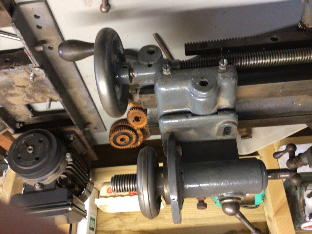

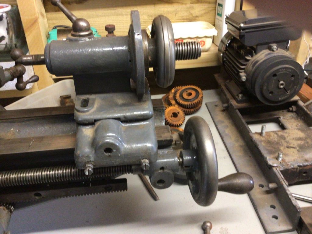

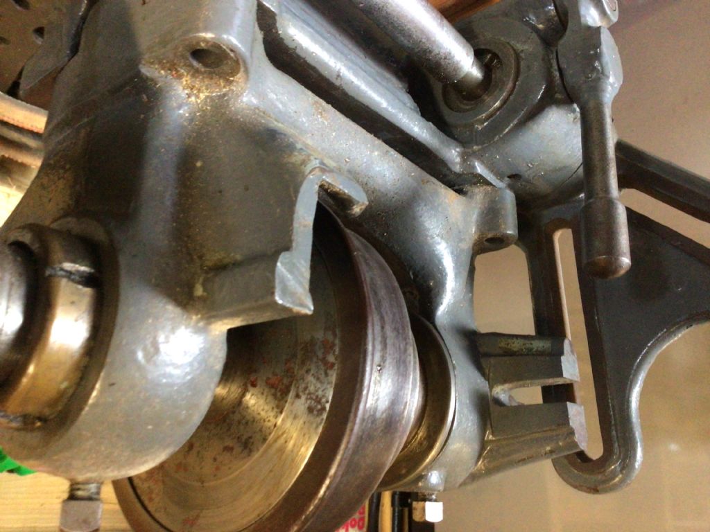

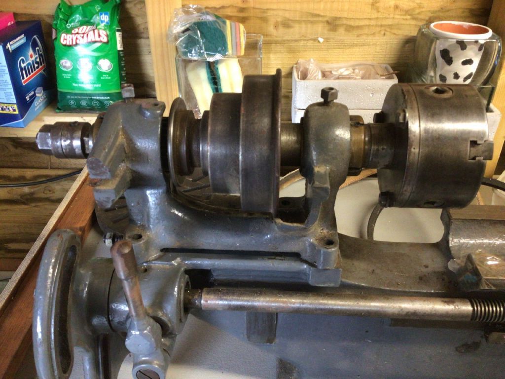

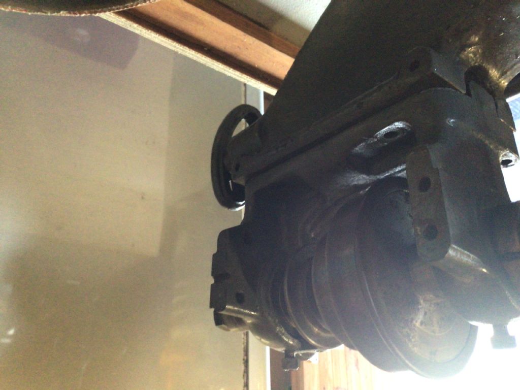

                                    e2d6bc82-d94b-4686-8e7d-bed61f100df8.jpeg013bc752-5051-4cef-af62-9b82cd899b62.jpege2d6bc82-d94b-4686-8e7d-bed61f100df8.jpegf7e712f7-3e29-466b-8001-2a2eb3ba23b7.jpeg3f10df63-be81-43ee-847a-42c279a1d7de.jpegProblems :-
                                    Mod edit: rotated photos.
                                    Edited By SillyOldDuffer on 23/09/2022 08:52:36

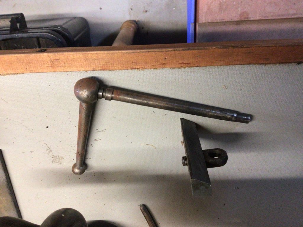

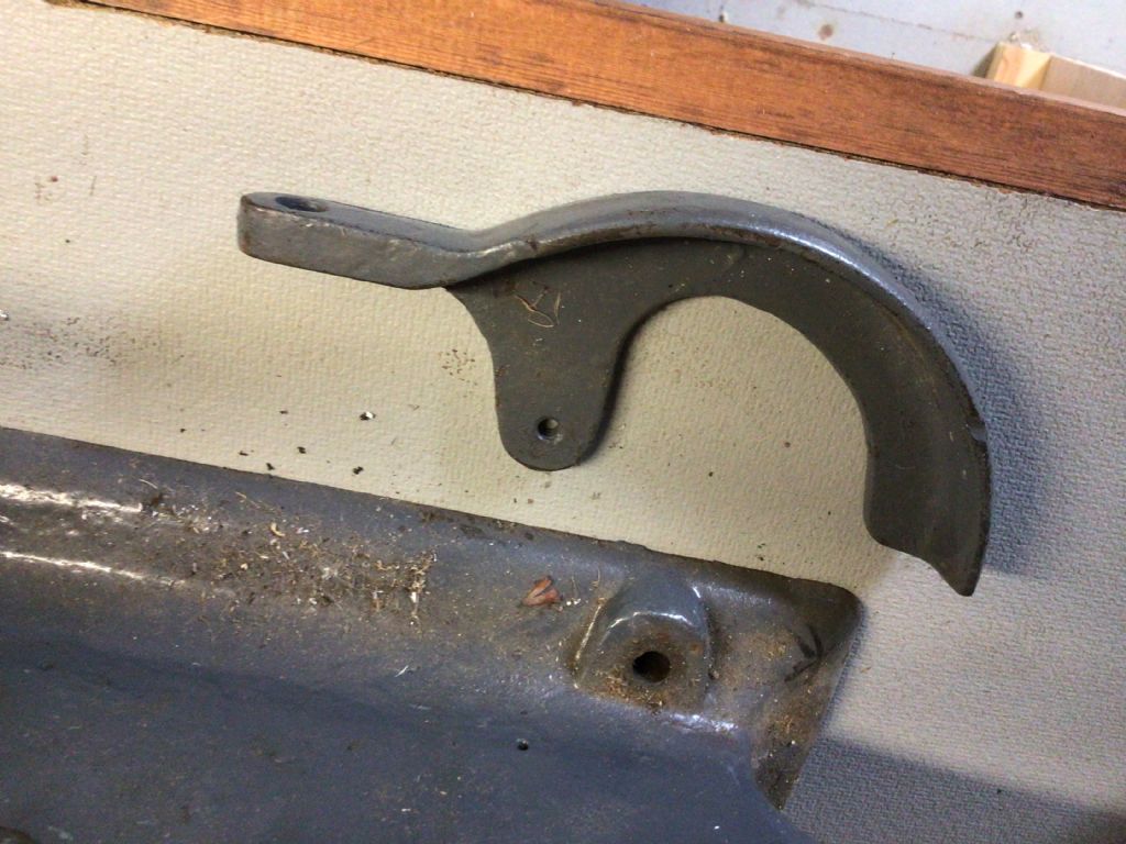

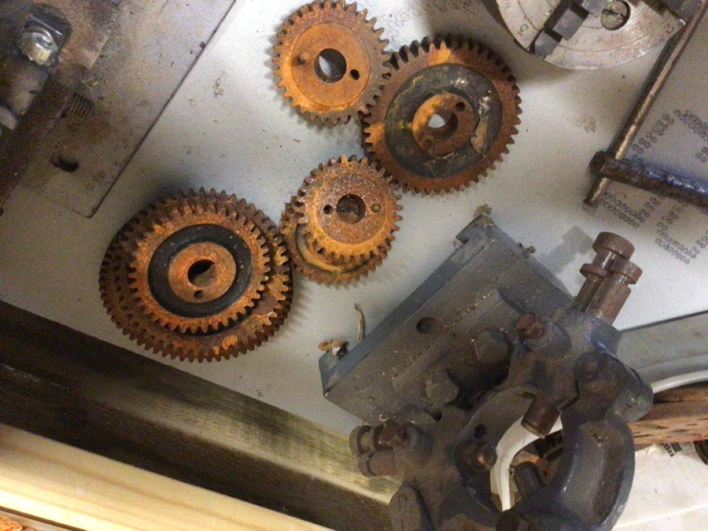

                                      Problems :- if you look at the photo that started this post you will see a plastic tub containing bits and bobs, bolts etc…this has gone missing. Does anyone know the bolt size to bolt the headstock to the base.. I will try and post pictures of other bits. In particular the rusty ( surface) cogs……how will I know if they belong to this machine ? Does it have loads of cogs….what drives the lead screw?

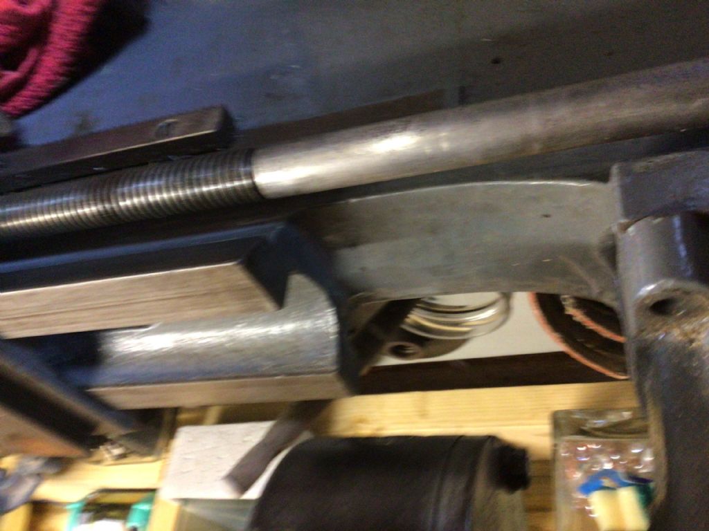

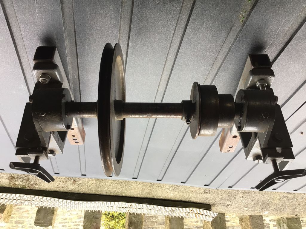

                                        fbeae4a5-e893-4584-8bea-dfdd7fe44a7b.jpegeb8f6b2b-2ab7-4a82-93cc-be339135dd66.jpega3da6f35-0f33-4d4a-a815-2b3076635403.jpeg668a4c72-69a9-48f7-81fe-16e4ca586c77.jpeg1b6bf43c-a5cc-4d0a-9ba5-bf5c527cd8fb.jpeg

                                            You've got quite severe headstock damage AND bed damage, this unit is not-looking-good
                                            If you haven't paid yet I'd walk away
                                            There's a few bits and bobs that will be useful but it's basically knackered
                                            100 quid for spares tops kinda thing, but only if you already had a working Drummond
                                            a lot of the parts you really need are missing
                                            You can zoom into the picture using ctrl +
                                            Edited By Ady1 on 22/09/2022 19:41:08

                                              The rusty cogs ("cogs" ?) do look like the lathe's change-wheels, well some of them anyway. I think there should be more of them to complete the set.
                                              The fasteners, including the studs and nuts or machine-screws holding the headstock to the bed, are most likely of BSW and BSF threads, depending on their size and purpose on the machine. It may be possible to obtain new ones of appropriate size, though possibly not cheaply.

                                                The bed is unmistakable Drummond , as for the rest of it a better pic would help.

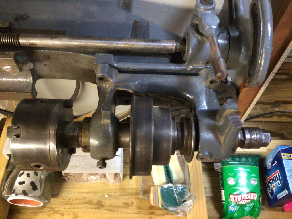

                                                  Hi, if you compare these two photos of Haydn's, which I've turned round, they look just like the headstock and tailstock of the picture of the unusual Myford lathe J1102 one that I mentioned in my previous post, even to the saddle rack just extending past the tapered shape of the bed at the tailstock end.
                                                  Haydn, the leadscrew is driven by change wheels between the leadscrew end to the left of the clutch lever and the headstock end at the left, the change gears being mounted on pins that fix onto the banjo that swings round at the left of the clutch lever, the change wheels you have do seem to be the correct ones for your machine, but you will probably need a few smaller and larger ones.
                                                  Regards Nick.
                                                  P.S. It does look like a Drummond type, but it's not a M type.
                                                  Edited By Nicholas Farr on 23/09/2022 08:31:05

                                                    I think its an M series headstock with parts of the casting hacked/chiselled off
                                                    and we'll probably have the same sort of damage on the other side where the backgear should be
                                                    Edited By Ady1 on 23/09/2022 09:29:39

                                                      e1ca26d7-f4fa-4b5b-bca0-fce1f2608957.jpegAdy1….hummm ! I see what you mean….the bed is not damaged, in fact most of this lathe seems in very good condition, all bearings/slides are nice.
                                                      sorry about the inverted photos…working on it.ac21780c-3659-4b6a-a431-8a7d94dd501f.jpeg
                                                      Edited By SillyOldDuffer on 23/09/2022 12:59:08
