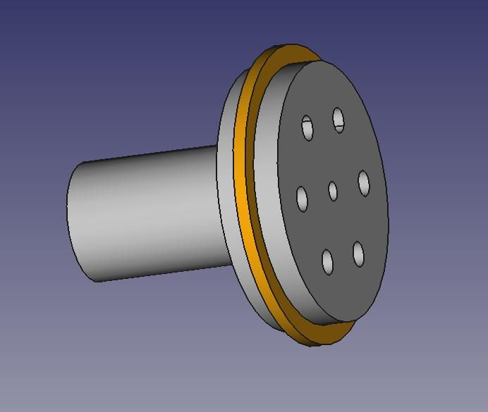

            Posted by Chris TickTock on 18/03/2020 15:48:14:
            Posted by JasonB on 18/03/2020 15:42:39:
            … Will wood cause issues in any way when used as a backer that I may not be aware of?
            Chris
            Unlike metals, plastics and most other engineering materials, wood isn't equally strong in all directions. It's likely to split along the grain.
            I'm not convinced providing a solid sacrificial back will stop burring especially if the back support is soft – like Aluminium, plastic or wood. I'd be inclined to only support the gearwheel near the edge, leaving the teeth to their own devices.
            Note I've shown the arbour with a central gripping hole plus six holes on an PCD. The axle hole on some gears is too small to allow them to be bolted down firmly. Instead, the gear blank can be held by 3 or more nuts and bolts passed through the outer holes. They're arranged to pass through the gears quartering (which might be cut later). Use the most convenient method. It's not unusual to make arbours to suit the task – 3 holes 4 holes, axle only, whatever is needed to get the job done.
            Cut teeth from front to back and de-burr the gear's back side by rubbing it on flat emery paper after the teeth have been cut.
            It's often a good idea to experiment to find what works best for you and your equipment. Please report back!
            #458012
            John Haine
              @johnhaine32865
              **GT insert or an HSS tool with plenty of top rake would be best for wood and used just like you were turning metal.
              Endmill is just as likely to get tip build up as the gear cutter in aluminium without lubrication.
              Thanks Jason,
              So I could grind a 1/4 right hand cutter with more top rake and use it in the standard tool post. If so seems the way to go. Will wood cause issues in any way when used as a backer that I may not be aware of?
              Chris
              When you reply to a post and click "quote", put your cursor right at the bottom of the window below the end of the vertical bar at the left before you start typing – then it will be quite clear what is your text and what you are replying to.
              You have two things to do.
              1. Cut the teeth, which needs the wheel blank on an arbor to fit the dividing head so the cutter can reach the periphery of the blank For this a nut and small washer on the outside, and a backing plate made of whatever you lies as long as it's reasonably rigid, is needed. If you like you can add a pin through the blank into the backing or use superglue, but if you do the nut up tight you shouldn't need anything else as long as you're cutting symmetrical teeth because the cutting force is along the wheel axis.
              2. Cross out to create the spokes. The usual approach is to drill a small hole in the area of each space and use a piercing saw. Frankly I think it's fiddly and quite hard to do without practice. You just hold the wheel (after the teeth are cut) in your fingers and use a "vee" cut-out saw table to support it, the cutting action being on the downstroke so it pulls the blank onto the table. There's another Clickspring video showing this, though he has a power fretsaw and filer.
                For milling (very non traditional!) the blank needs to be stuck down to a table, e.g. a rotary table. This needs a separate backing. For this sort of job on my mill (admittedly using CNC) I stick the work down on a sacrificial plate with a small screw (M4?) through the centre hole, using superglue. The plate could be aluminium, or I tend to use Valchromat which is an engineered wood. Getting it off can be done by heating, e.g. putting the whole thing in a saucepan and boiling it. Or use blue masking tape on both surfaces with the superglue in between – doesn't hold so well but easier to part. Use a small mill, say 1 or 2 mm for a wheel the size you're making. Make the max DOC only just enough to get through the material – if you're backing with ali there'll then be the minimum amount of ali swarf to gum up the cutter and anyway only on the last cut.

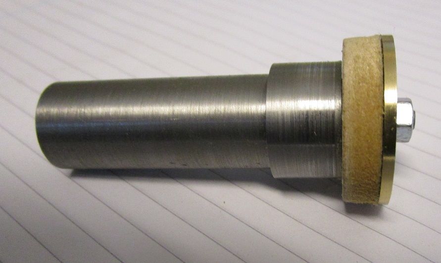

                  #458217
                  Chris TickTock
                    @christicktock
                    update:
                    Whilst waiting for my delrin 9plastic0 to arrive I got bored and tried making the backer from wood.
                    Results ply not easily machined as breaks off but mdf worked a treat. If only used in small amounts I think acceptable (dust). chris

                          Amazing some of the stuff on this site!…….personally, I use hardboard for backing wheel blanks and always cut at least two together then select the best looking one….

                              Posted by Bob Stevenson on 21/03/2020 16:27:40:
                              Thanks Bob, Hardboard comes in the right sort of thickness and is cheap enough so will grab a bit next time I dare enter B&Q.

                                I'm not a clock-maker but treating this purely as metal-working, would it be worth making the washer – which can be of almost any reasonably rigid plastic or metal – to dedendum diameter as John Haine suggests, but dishing it slightly so the pressure is applied close to the cut?
