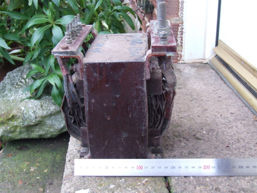

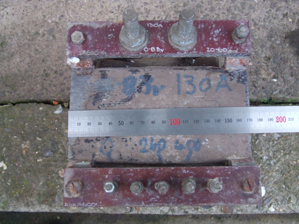

        Gentlemen, For some time a large transormer has been waiting to be used for something ! The primary winding is marked 0-240-400-? this is unreadable and the secondary is 0.83V at 130A. There are numbers on the top,20-60,and 4600-16.The identification markings are in a white ink hand written It is very heavy and seems very well made, the sec connections are a pair of 1/2" studs ! A) Who made it ? B any ideas as to what it's original purpose was ? C) what purpose can I best put it to ? Noel
        One thought is that the 4600- 16 is the turn ratio.
        Edited By noel shelley on 17/01/2021 13:12:34

          A few pictures will probably get you some decent responses

                With the high amps and low volts at the secondary I'd guess it was for welding purposes, but apart from that no idea. Have not come across one with numbers just like that. Pics might help get responses.

                  As John H says the output voltage indicates a resistance / spot welder is the most likely application. A phot with something for scale (CD is good) would be helpful.

                                Still think a small resistance welder. The sort of thing used for thermocouples or electrical connection e.g nichrome heting element to copper terminal. The size implies a conservative rating for the core so a high duty cycle application. The 240 / 400V primary imples industral use. I did wonder about a filament transformer but most valves are fussy about current and 0.83V at 130A is 0.063 ohms total circuit resistance so very little tolerance for connection resistance etc. I'd expect to see a few primary voltage fine adjustment taps if it was a filament transformer.

                                  Spot or resistance welding was my first thought. The 240v & 400v tappings are clear to read but there are 2 other tappings, that could be 110v or 200v and the other 415v. It is 4 times the size of a microwave transformer running at 900w, the primary posts are 2Ba, if it's rating is only 100VA it is all very over kill. Something this big drawing .5A at 240V and 2Ba posts ? Kicking off a big mercury rectifier ? 240v /.83v =289.1 4600/16 =287.5 it may be a coincidence but 4600-16 may well be the turn ratio and would tally with the 240v to .83v
                                  Keep the ideas coming – please. Noel

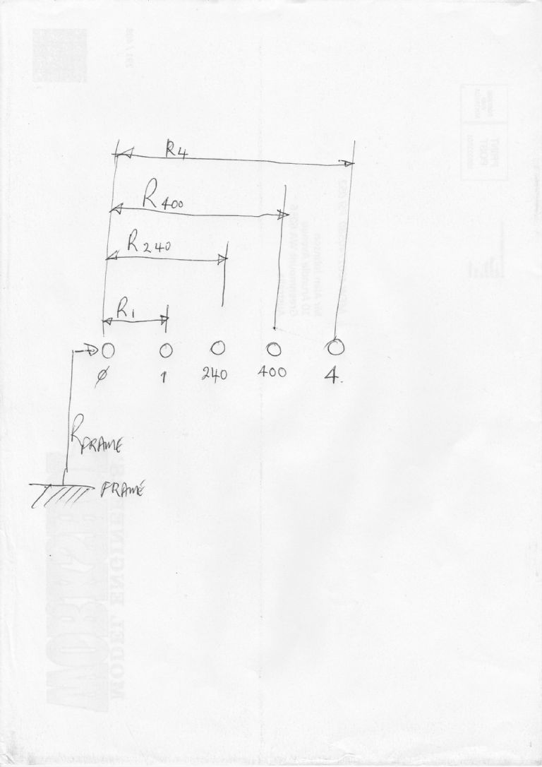

                                        With your multimeter measure the winding resistances and draw a diagram with the connection points and the resistance between them, and the iron core, then publish it here.
                                        If you have one, an insulation tester set at 400 volts between the 240/400 side and the iron core.
                                        I would suspect the 240 / 400 etc. side terminals are connected to each other, and not the 1/2" stud side and DEFINITELY NOT THE iron core!
                                        #520623
                                        Alan Johnson 7
                                          @alanjohnson7
                                          If you test the transformer windings as per this test it would help.

                                              Right ! Leakage to ground better than 100meg. Resistance, 0 to tapping 1 – 0.17, 0 to2(240) 0.24, 0 to 3(400) 0.78 and 0 to4 1.18 all values in Ohms. The resistance on the secondary is so low as to be difficult to measure, less than 0.1
                                              any help ? Noel.

                                                1st. Observation: the insulation resistance appears good, all be it at a very low test voltage from the multimeter.
                                                2nd. Observation: as the ratio of resistance between windings is not the same, I suspect smaller diameter wire was used as the voltages get higher. This is a common practice in transformer manufacturing when costs count. As an example, the 240V winding has a resistance of 0.24R (a nice convenient number), so I would expect (if the wire was the same size) for the 400V winding to have a resistance of about 0.4R, but it does not.

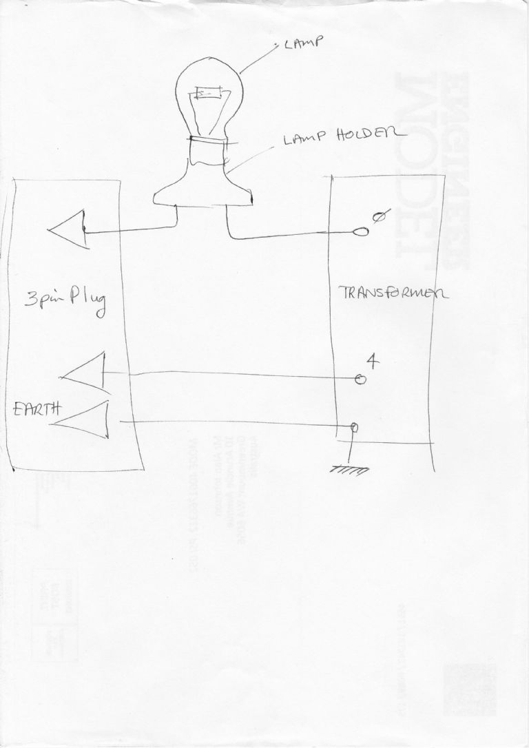

                                                Now to apply some voltage to it! You will need an incandescent lamp. Old fashioned 100W lamps are good, but a modern halogen lamp will work. This is connected in series with the supply to the transformer. The purpose of the lamp is to limit the current flow in the transformer. If it had shorted turns current flow would be large, so the lamp limits this.
                                                Connect initially to terminals 0 and 4, and connect the supply earth wire to the frame of the transformer.
                                                You are now dealing with MAINS VOLTAGE THAT CAN KILL YOU. Don’t proceed if you are not confident with what you are doing! Wear safety glasses and gloves.
                                                Energise and wait for smoke, or a burning smell. No smoke or smell the transformer is probably OK. If there is an earth leakage, your household supply earth leakage circuit breaker will trip. If it doesn’t trip you can proceed. If it does, you are the owner of a piece of scrap metal!
                                                Measure some voltages – same as you did with the resistance tests, and report back. Remember to use the AC voltage setting on the multimeter, and remember these are MAINS VOLTAGES, SO DON’T TOUCH!

                                                  The insulation was tested at 500v using an insulation tester. And the other readings were taken with a very good multimeter. I have 100w incandesant bulbs. will see what happens. Many thanks. Noel
