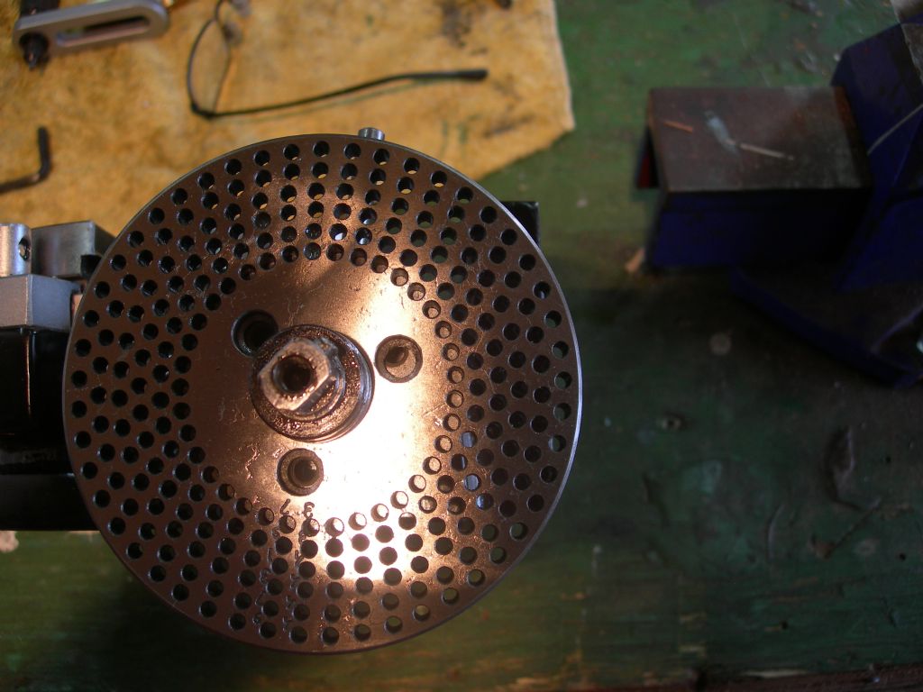

      hi chaps
      Just got my nice new rotary table with dividing plates from one of the big suppliers (who shall remain anonymous until they reply to my e-mail ) attempted to fit the dividing plates and found the holes out of line see the piccy below.
      Kind of ironic really wink

        a dividing head

        Brian Wood
          @brianwood45127
          Now the question arises, is it the boss they screw to or the plates that are wrong?.
          I would return it , no argument.
          Brian

          Dismaldunc
            @dismaldunc
            I think its the boss, not measured anything but it just looks wrong!

            Les Jones 1
              @lesjones1
              Is it possible that the holes are not spaced at exactly 120 Deg. on purpose so that it only fits in one position ?
              Les.

              Dismaldunc
                @dismaldunc
                hi Les,
                I thought that might be the case so gave it a twiddle but tis the same in all three positions ( i also tried the other 2 disks) Dunc

                    I bet they have two similar Products available, and you've ended up with parts from each.
                    Rotary Table from one, Plates from t'other. … neither is wrong, they're just not a set.

                          My point was that "Rotary Table" and "Dividing Plates" could both be [seperately] correct.
                          The Dividing Plates tend to be sold as Accessories, and presumably are in seperate packing.
                          To me … it looks like simple error in the Dealer's StockRoom.

                                  Posted by Michael Gilligan on 13/05/2013 08:51:45
                                  Just by way of illustration … have a look at this page, and compare the spacing of the three mounting holes.

                                        I think foklks are missing Michael's point. There uis a very good reason why the holes may not be evenly spaced – so you can swap plates and put them back on in the same orientation without needing a key.
                                        Both items could well be to spec, but not matched.
