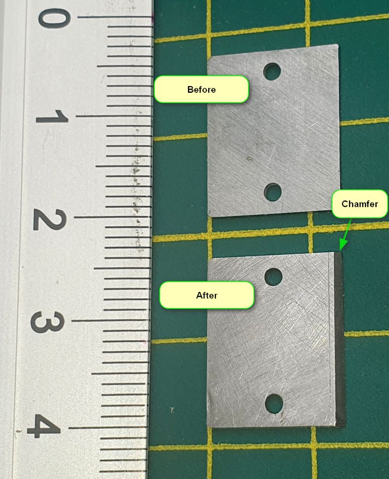

      Hello
      I need to make a 45° chamfer on one edge of each of these small pieces of mild steel – which are 16mm x 8mm x 1mm in size.
      FWIW, the steels have been laser cut.
      Below are two "before and after" photographs.
      Note: I have cut a chamfer on one of the parts by careful filing the steel (by hand) and by then finishing off with a diamond sharpening stone. My problem is that it took me far too long to make just one chamfer and I need to make at least x64 of them!
      [NB Please ignore the scratches!]
      Problems:
      1. I must not change the (8mm) width of the part, so I must not cut too deep in order to leave a small amount of the original face behind
      2. The face of the chamfer needs to be as close to 45° as is reasonably possible (i.e. within say 0.5° to 1°
      3. I have at least 64 of them to make!

        Jeff Dayman
          @jeffdayman43397
          what job is this for?

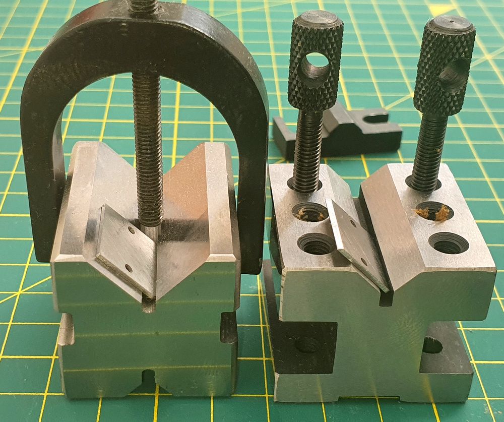

                                1. Since posting that question things have changed quite a lot. For one thing I have bought a diamond hone + a honing guide, and I still intend to finish off using the diamond hone to get required accuracy.
                                2. I have also bought V-blocks.
                                3. I have explicitly specified the degree of accuracy that I need.
                                4. I have stated my budget precisely – which rules out many of the "buy a proper milling machine" suggestions
                                5. The point is that given my new situation/different requirements I specifically DIDN'T want everyone to have to trawl through multiple pages in order to make a sensible contribution.
                                6. Furthermore although I have now worked out how to create a few parts, using diamond hone (and hand file) as suggested, the new requirement is that I need to make them FASTER.
                                7. Furthermore the parts are laser-cut to exactly the correct (8mm) width so it is crucial that I do not cut too deep.
                                8. Furthermore, given the number of parts that I'm going to need to 'manufacture' – at least 64 – I don't want to wear out my diamond sharpening tool.
                                J

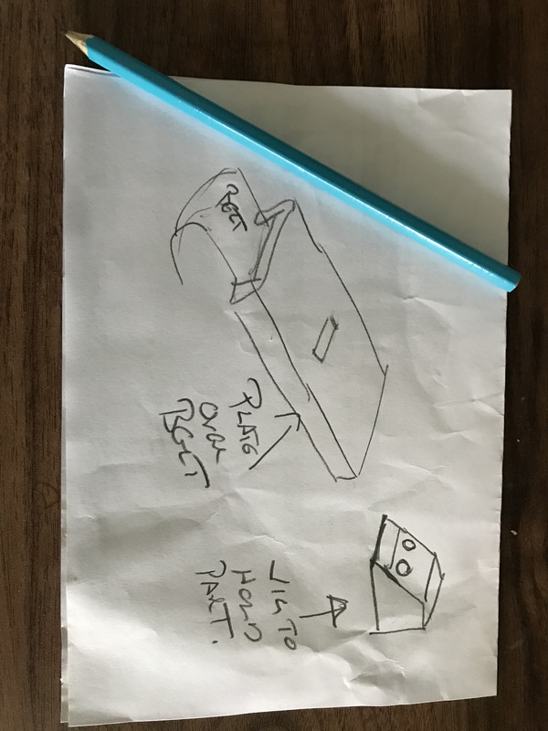

                                      Dave S
                                        @daves59043
                                        Jig is a simple work holding device that allows a quick, repeatable setup.
                                        in this case it probably looks a lot like a block with a 45 degree face and a strap clamp.
                                        Add a plate over the belt with a slot in it – think wood plane sole sort of thing.
                                        poke jigged plate through slot into belt. Large block of jig lands on the plate repeatably.
                                        all you have to do is make sure the jig sets up so the plates to be ground are in the same place each time – assuming the holes are at a known location 2 dowels in the face of the jig will do that.
                                        I do not have that unit, and I would do this sort of thing in my chuffing enormous mill, with a different but similar function jig.

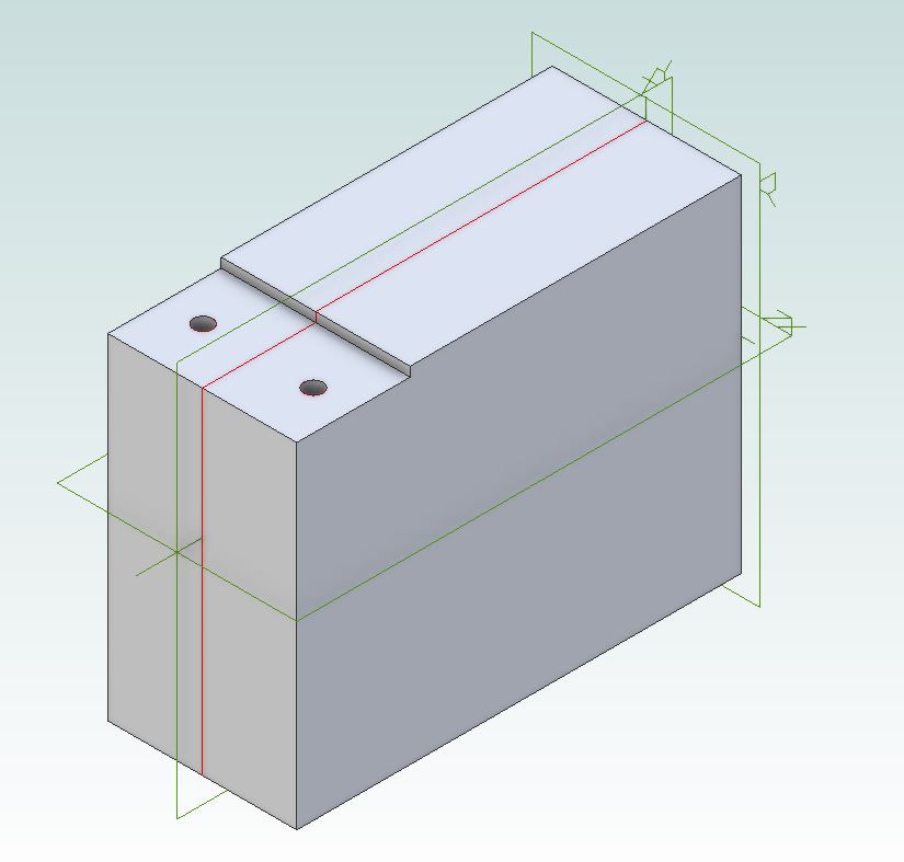

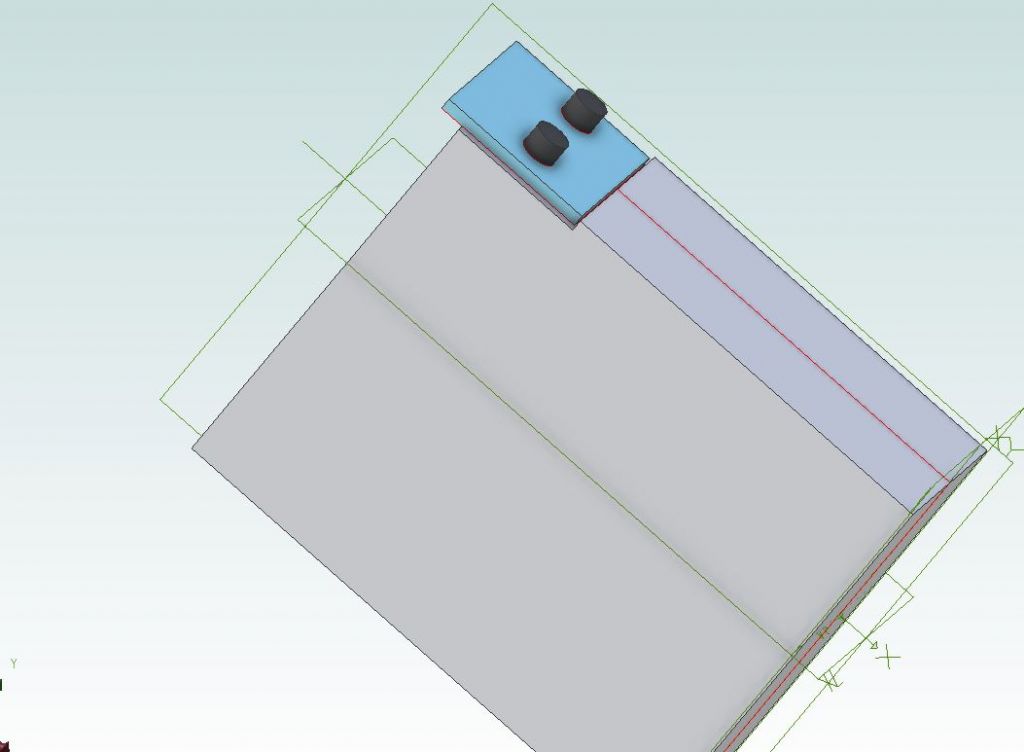

                                          What grade diamond lap did you get, a coarse one first will speed things up before final run on a file one. Or glue some wet & dry or silicon carbide paper to a piece of glass and use that first to remove most of the bulk of the metal.
                                          I'll still stand by my suggestion from the other thread using a simple jig and your proxon even though you say things have changed
                                          So simple jig from a bit of scrap, even the Proxxon will be able to mill the shallow 1mm pocket and drill a couple of holes that can be tapped
                                          Simply hold the jig in a regular vice with the jig tilted at 45deg, screw one of your plates to it and mill or use a grinding bit to machine the upper edge to 45degrees, note the height of the mill or simply lock it in place. remove completed plate and screw on the next one repeat 63 times.
                                          Edited By JasonB on 03/09/2021 17:14:53
                                          Edited By JasonB on 03/09/2021 17:15:47

                                          Dave S
                                            @daves59043
                                            Literally a 5 second design sketch:
