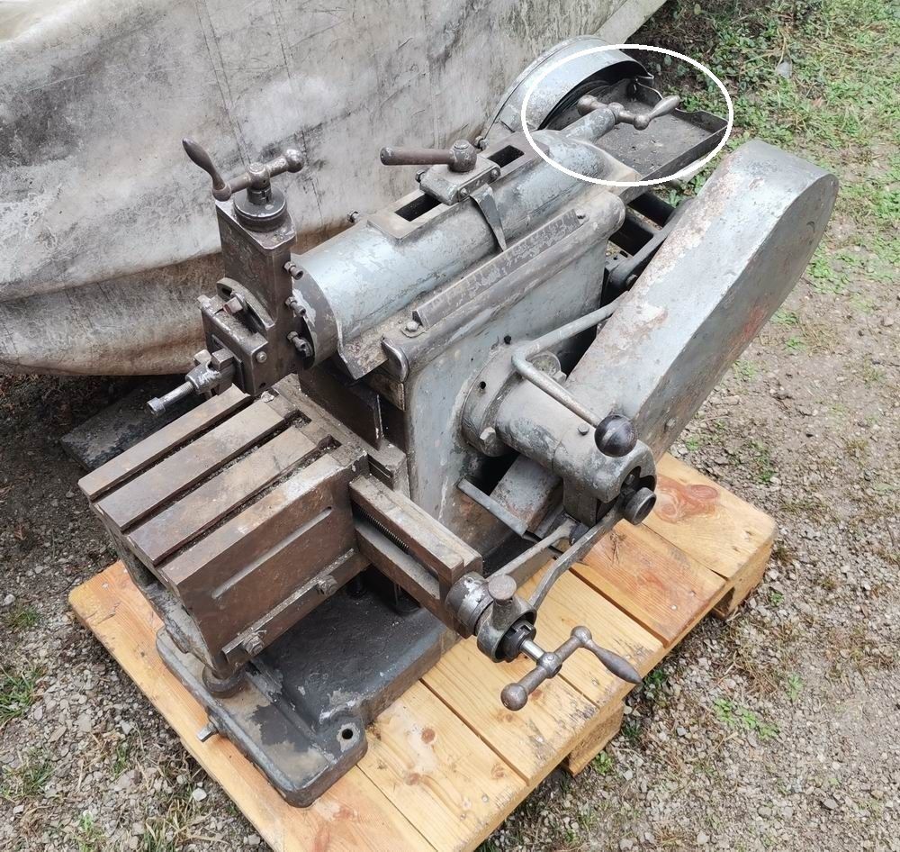

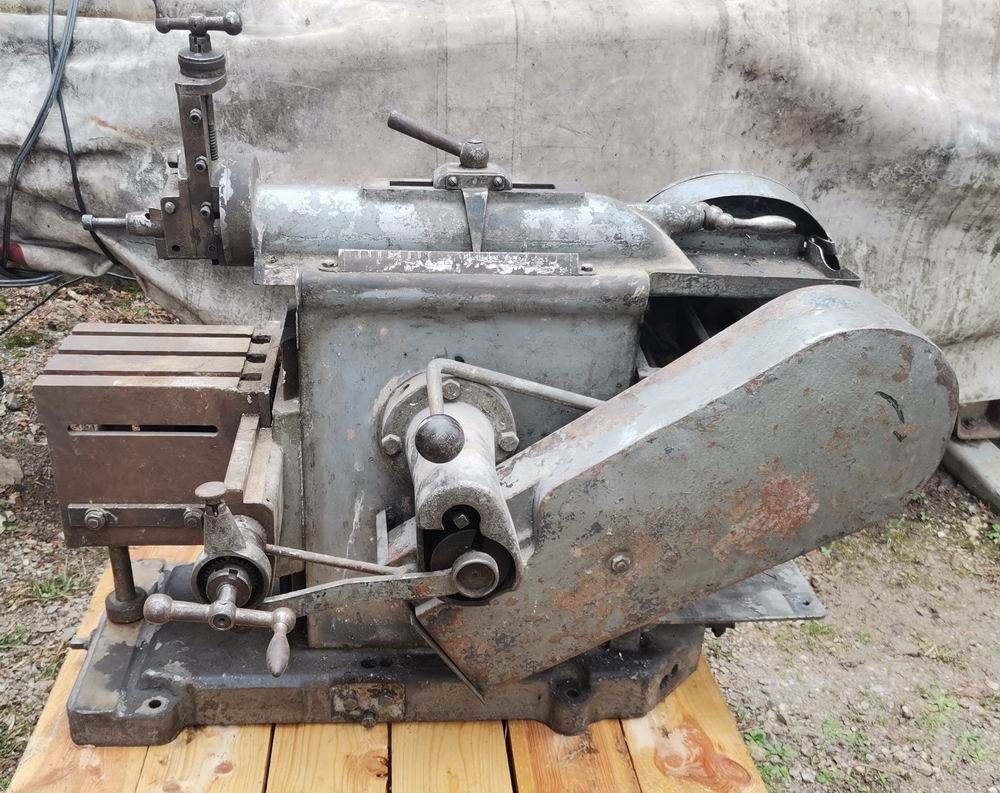

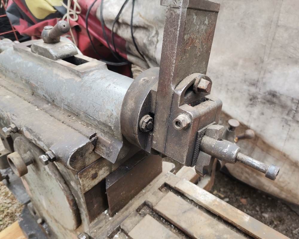

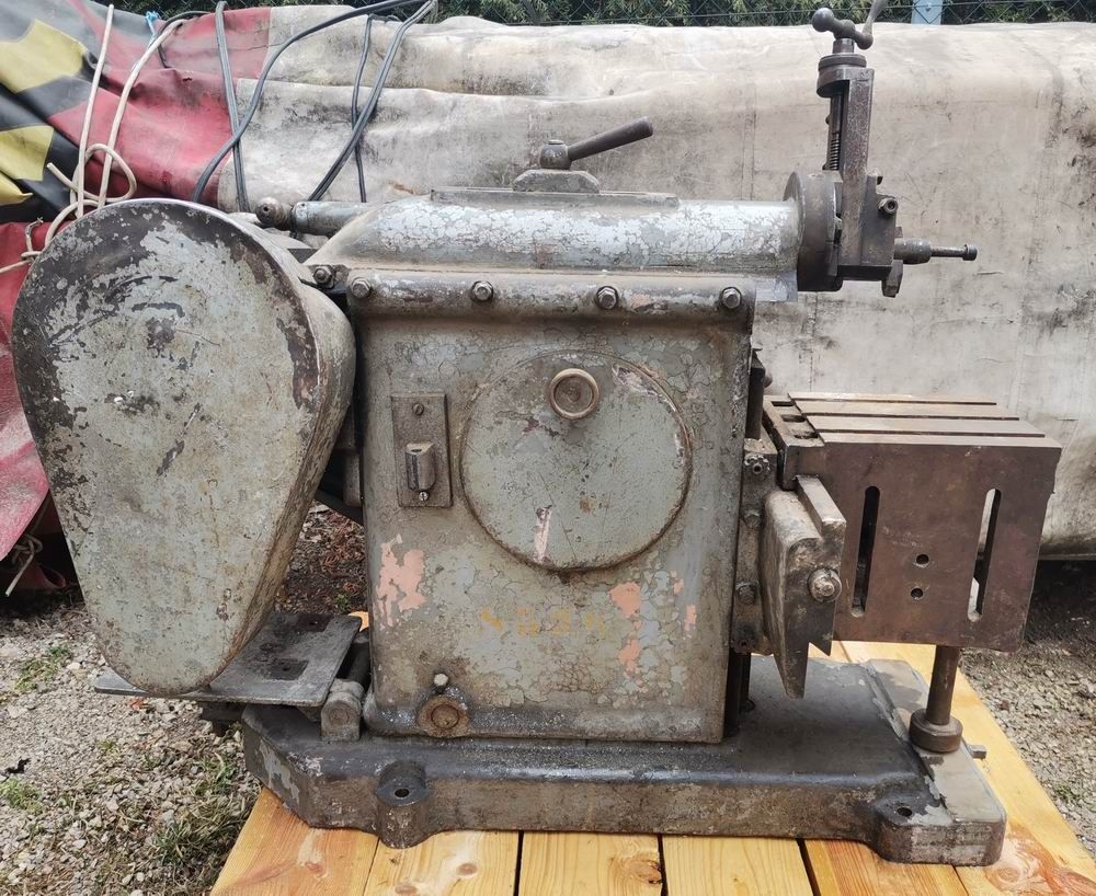

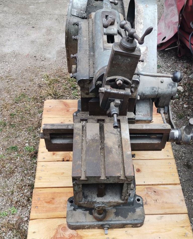

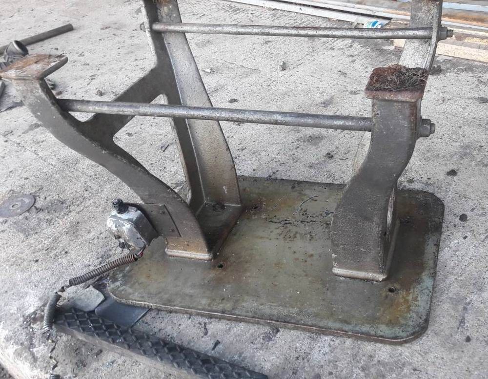

      Does anyone know what brand of this shaper is he came with this table.

          There's a list of shaper types here

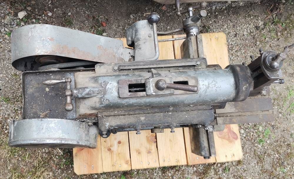

                The screw adjuster at the back of the ram to help accurately set the stroke endpoint is unusual and may well be a unique refinement on such a small shaper.
                Klopp and Heinmann had similar adjusters on some of their large machines but they always cast the name onto the machine. As far as i'm aware they didn't make shapers that small either.

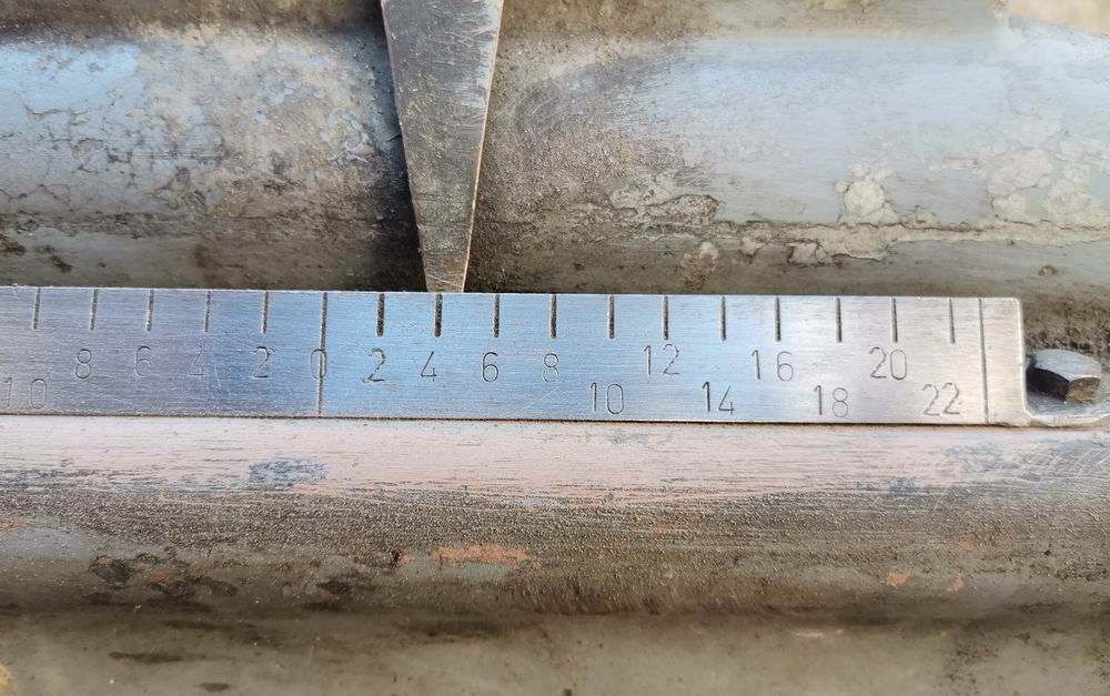

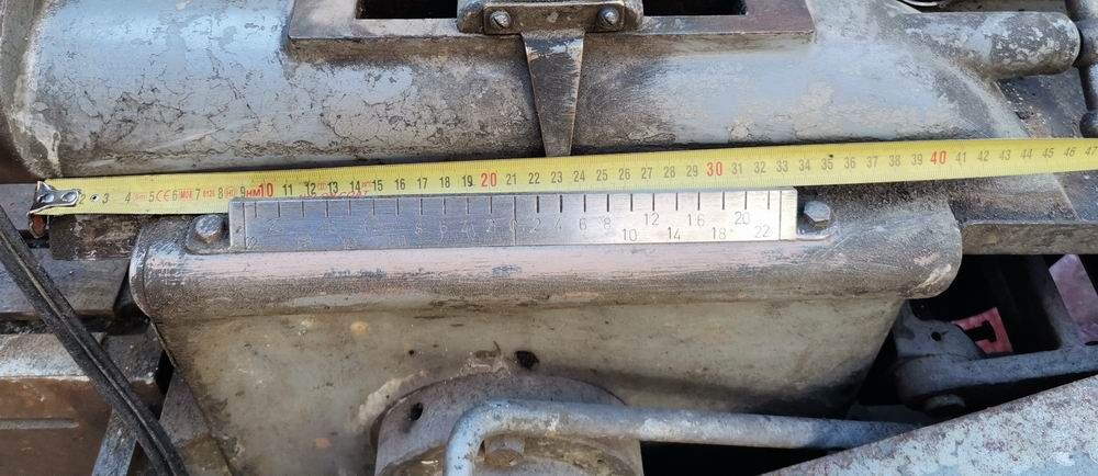

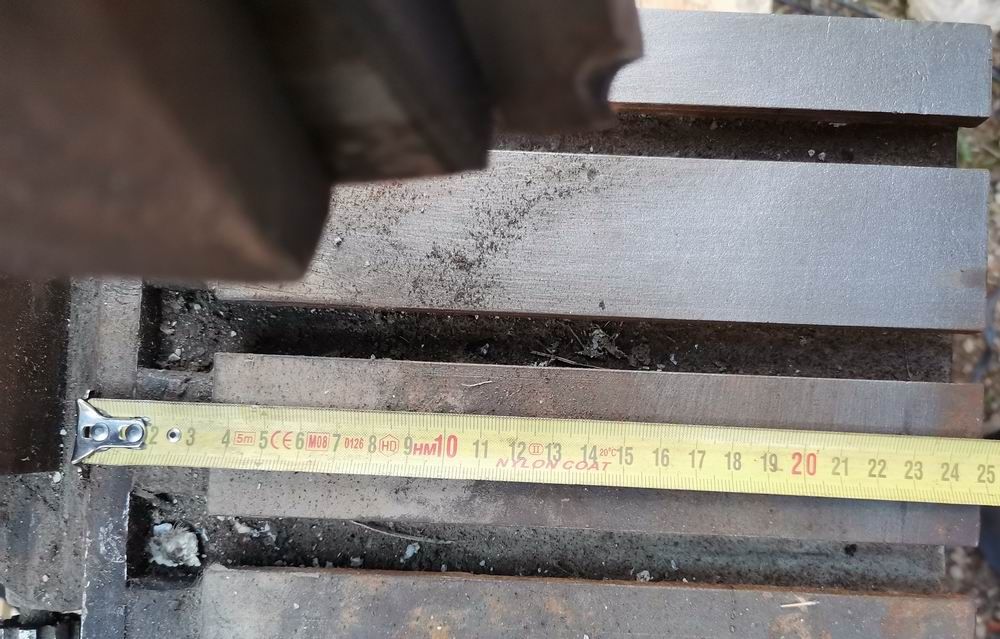

                  The essential dimension of a shaper is the maximum length of the stroke. This dimension is missing!

                      I took more pictures

                        As mentioned you have an offset ram position adjuster, so find this, and you have your answer
                        The front slide gib adjustment nuts are HUGE if they are originals
                        Edited By Ady1 on 22/02/2022 10:49:45

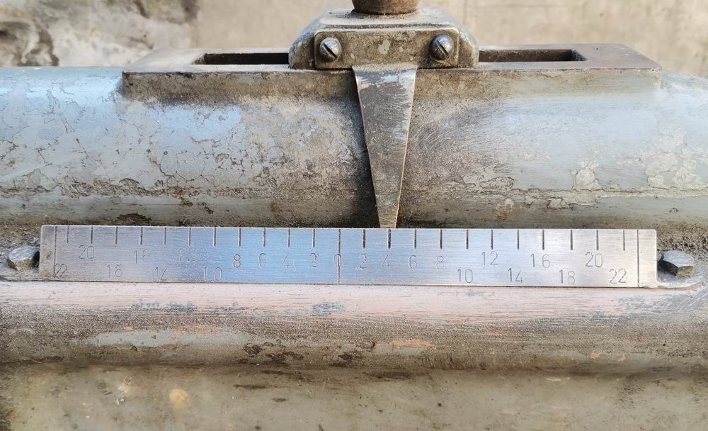

                          From the shape of the guards, the position of the clutch lever and the stroke length indicator, it looks like it's either an Atlas shaper or a clone of one.

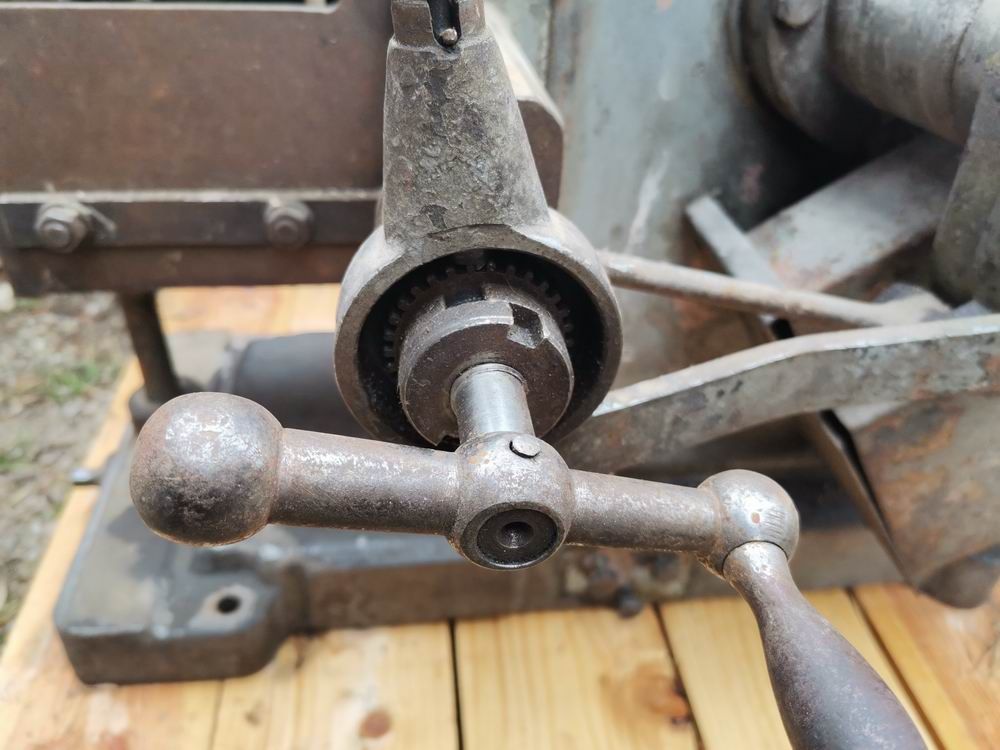

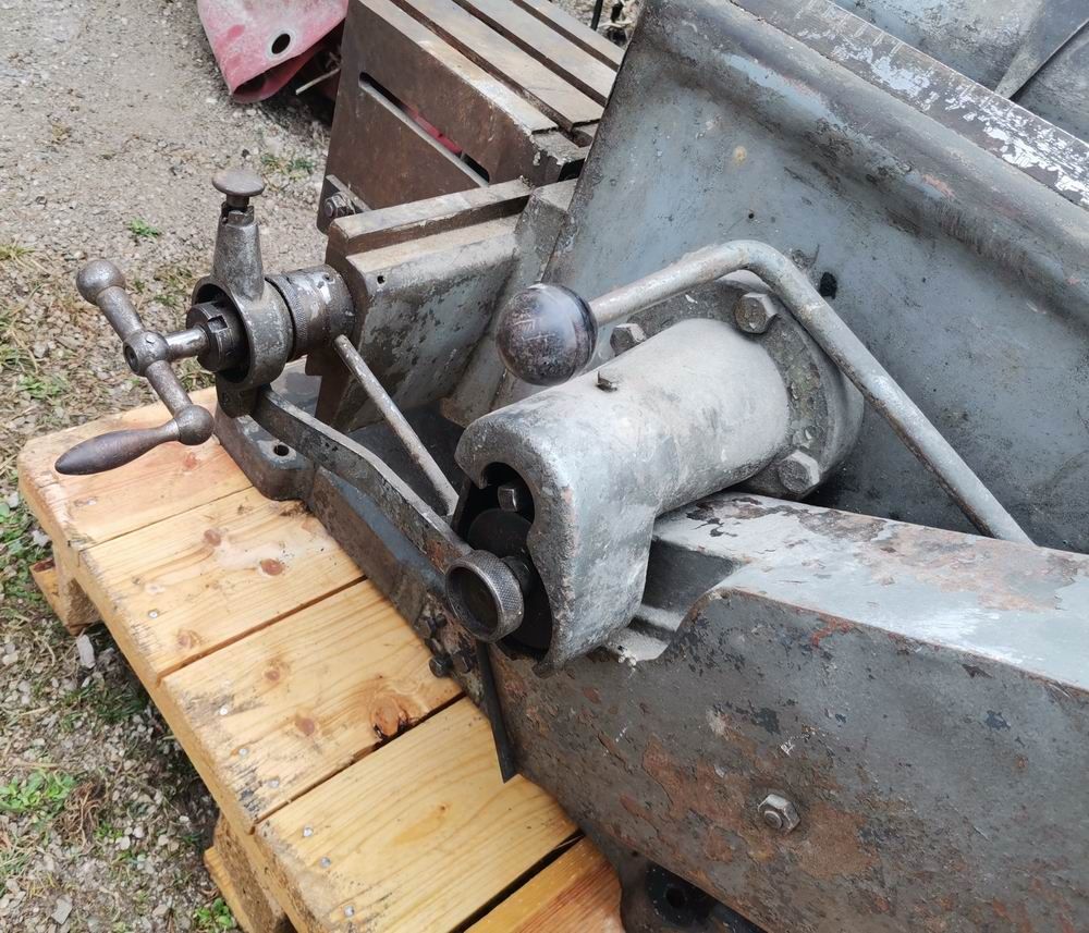

                            The side controls say royal/viceroy to me… but that ram adjustment has to be designed from the ground up to fit into the bullwheel mechanism

                              It's not offset… it was the picture..

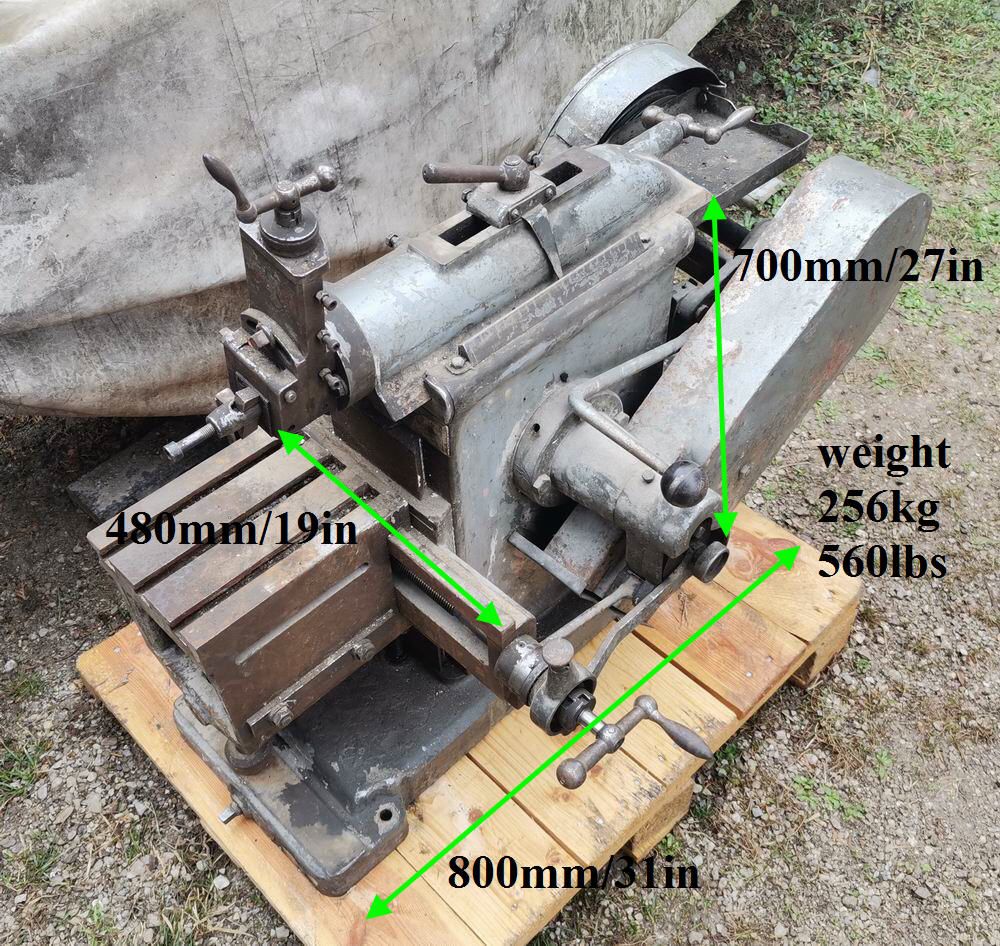

                                What country is the shaper in? And are the nuts and bolts etc in metric or imperial?

                                  I checked the list of shapers again and only Atlas and Heinemann have ram position adjuster behind of machine
                                  I am from Europe, I checked nuts and bolts are in metric
                                  The height adjustment of the table is in front of machine
                                  I always have something weird that I can't figure out what it is
                                  Edited By panjic alojz on 22/02/2022 12:23:20
