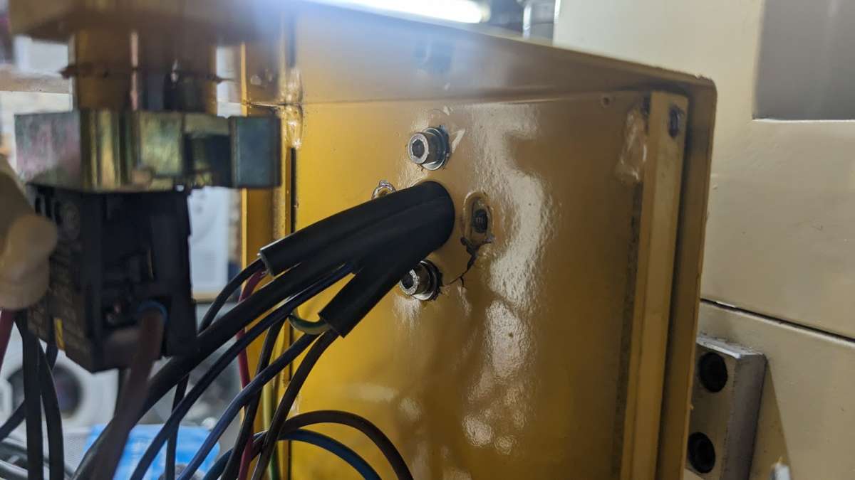

                  catmaster
                    @catmaster
                    I have a box of the old incandescent bulbs so this is not a problem.
                    I guess another substitution for a incandescent bulb would be a speaker or buzzer. No matter how hard we try they will be unobtainable one day but that’s other subject.
                    I’ve removed the control board from the mill, nothing obvious looks blown. I’ve done a resistance test on the MOSFETs and it seems like I have one that gives a very low reading compared to the other 2 so I’m wonder if this is the problem. It seems like this is the common point of failure on these boards so I’ve ordered 3 o these and I’ll just replace them all.
                    I’ve also found 2 loose screws from the electric control box… I doubt they shorted anything but it’s another possible option.

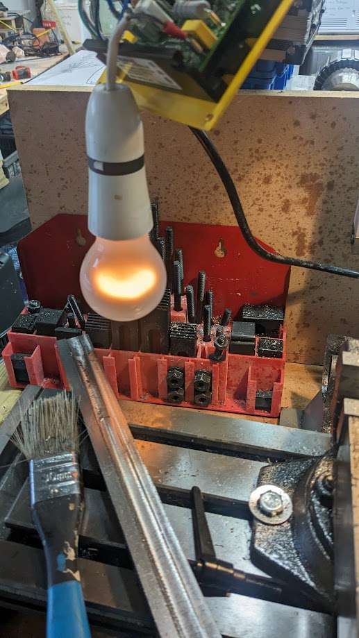

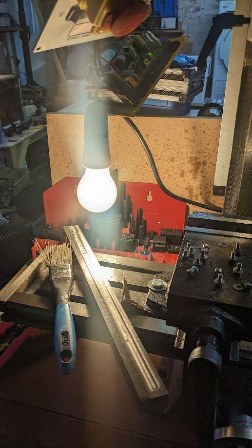

                      catmaster
                        @catmaster
                        Ok so this evening I stuck a 100w bulb onto the controller circuit, it didn’t flip the fusebox
                        It functioned as you guys suggested, with the pot altering brightness.
                        PXL_20240412_184005995
                        PXL_20240412_184016604
                        Does this mean the controller is functioning and the motor is the issue?
                        Thanks

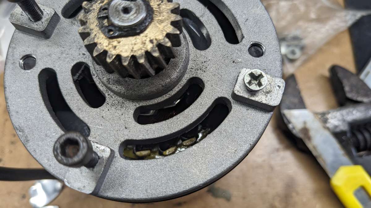

                                  catmaster
                                    @catmaster
                                    Yes we know about LED’s, I never used an LED.
                                    As for the mill it’s bad news again. I went to square up a part this afternoon and as soon as it was under load it tripped the fuse again. I tried the light bulb tester, it worked fine.
                                    I went to move the spindle by hand and noticed it was tight. I took the motor mount off the top and had a look at the gears, they looked fine.
                                    I then tried the motor with no load on it at all just holding it in my hand, fuse popped immediately.
                                    I think the motor is fried, would you chaps concur?

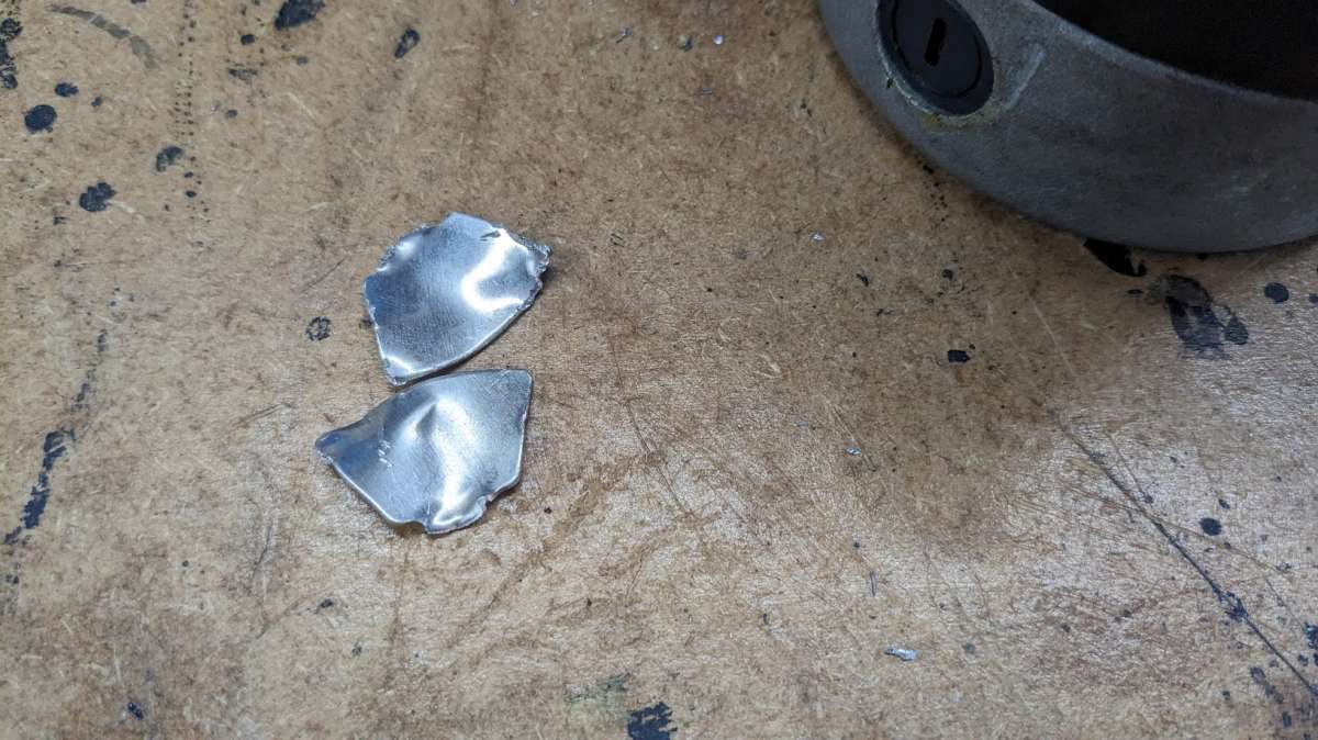

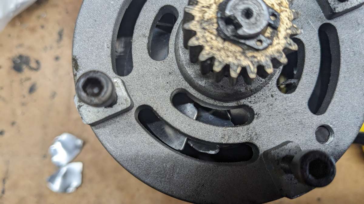

                                    catmaster
                                      @catmaster
                                      Ok I think I’ve answered my own question… I took the motor off to measure it up for a new one and 2 bits of metal dropped out.
                                      It seems like the impellor inside to cool itself has broken down.
                                      2 dropped out but it looks like 4 or 5 have been broken off, I wonder if the previous owner just removed them and sold me the mill or if they are still in there causing the short.
                                      PXL_20240413_131935384PXL_20240413_131918640PXL_20240413_131924894
                                      Either way I’ll just replace the motor, Chester Tools are only an hour away from me so I’ll have a drive up there on Monday. The motor shows as in stock but the picture looks different but if I go in person I’m sure they will help me out and I might have a wonder round to see what else they have.

                                      Werner Schleidt
                                        @wernerschleidt45161
                                        They looks like blades from the cooling fan inside the motor. It is a good idea looking for a new motor

                                        noel shelley
                                          @noelshelley55608
                                          Like Werner says something got in there and took the blades out ! LOOK very closely at the windings and try an insulation test (megger ) may be ok. Good luck. Noel.

                                          catmaster
                                            @catmaster
                                            Nah I’m going for a new motor, even if this one worked again it would run badly due to the imbalance and poor cooling. A new one is £90, it’s a no brainer and it’s problem solved.
