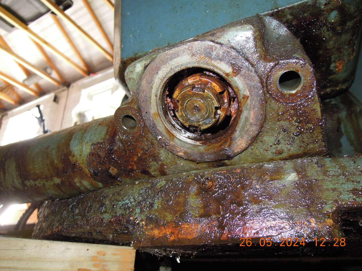

      I need to release a feed-screw shaft so that I can remove the worm-wheel gearbox from my J&S grinder. The shaft is held in end by two ‘hook-spanner’ type nuts as you see in the picture below.
      DSCN0885
      My problem is that only one of the nuts partially protrudes above the face of the casting, so hook-spanners cannot be the solution for unscrewing them. What ‘I think’ I need is a pair of coaxial castellated box spanners !  Are such things made ? Probably not!
      I have tried to unscrew the lower and smaller of the two nuts using flat-ended pin punch and hammer but its doing damage and not moving anything. Its difficult to hold the screw shaft.
      Can anyone suggest a solution?….or a tool ? I would prefer to buy rather than make, as time is of the essence and I have plenty of other tasks to keep me going while it arrives.

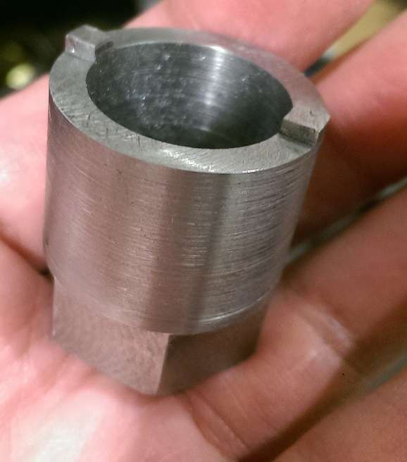

                        I agree with grinding the end of a socket.  I’ve done it for an automotive application.  An angle grinder makes short work of it.  I even made one from bar stock, when I didn’t want to wait for the tool to arrive for my bike.

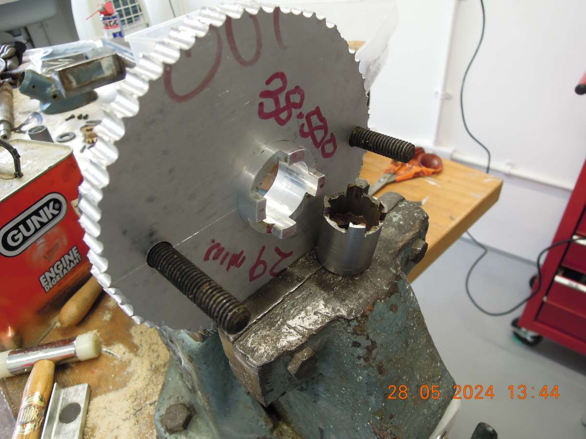

                          Not finding anything on the web with anything like suitable dimensions, I machined up an castellated alloy ring (for the big nut) and pressed this into a hole bored piece of scrap 1/2inch thick plate. I made it about 40 microns (a thou and a half) interference to ensure it didn’t slip. That was probably a bit much as it proved quite difficult to press in. It required about about 5 tons…I suspect that was less to do with the interference and more to do with it ‘cold welding’ itself on the way in.
                          I then machined a surplus 1/2″ drive socket to fit coaxially in the alloy part, to mesh with the small nut. To ensure I could use two hands on the socket ratchet handle, I put two holes in the alloy plate so this could be held positively on the casting using studs and nuts. This would also ensure its castellations would stay in positive engagement. DSCN0890
                          So best part of a day in the making…. but would it work ? Quite honestly I expected something to go wrong, as these things always end up being a development project, but for a change it didn’t. But goodness me, was that small nut tight ! I was convinced I would strip the teeth off the alloy ring, but somehow got away with it this time. Within 30 seconds the job was complete. The shaft was released and this allowed me to take out the gearbox. Its all down hill from here 🙂
