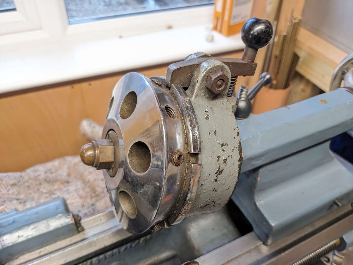

      Does anyone know where I might be able to purchase some 3/4″ straight shank drill chuck arbors?
      I want them for a tailstock turret which I purchased many years ago. I never got around to using it, but I would now like to give it a try.
      The only ones I can find are from RDG tools. (B16). I have lots of different drill chucks I can use but I’m not having much luck finding matching arbors!

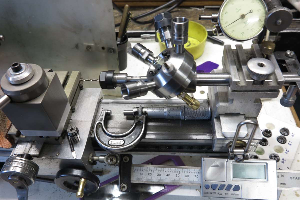

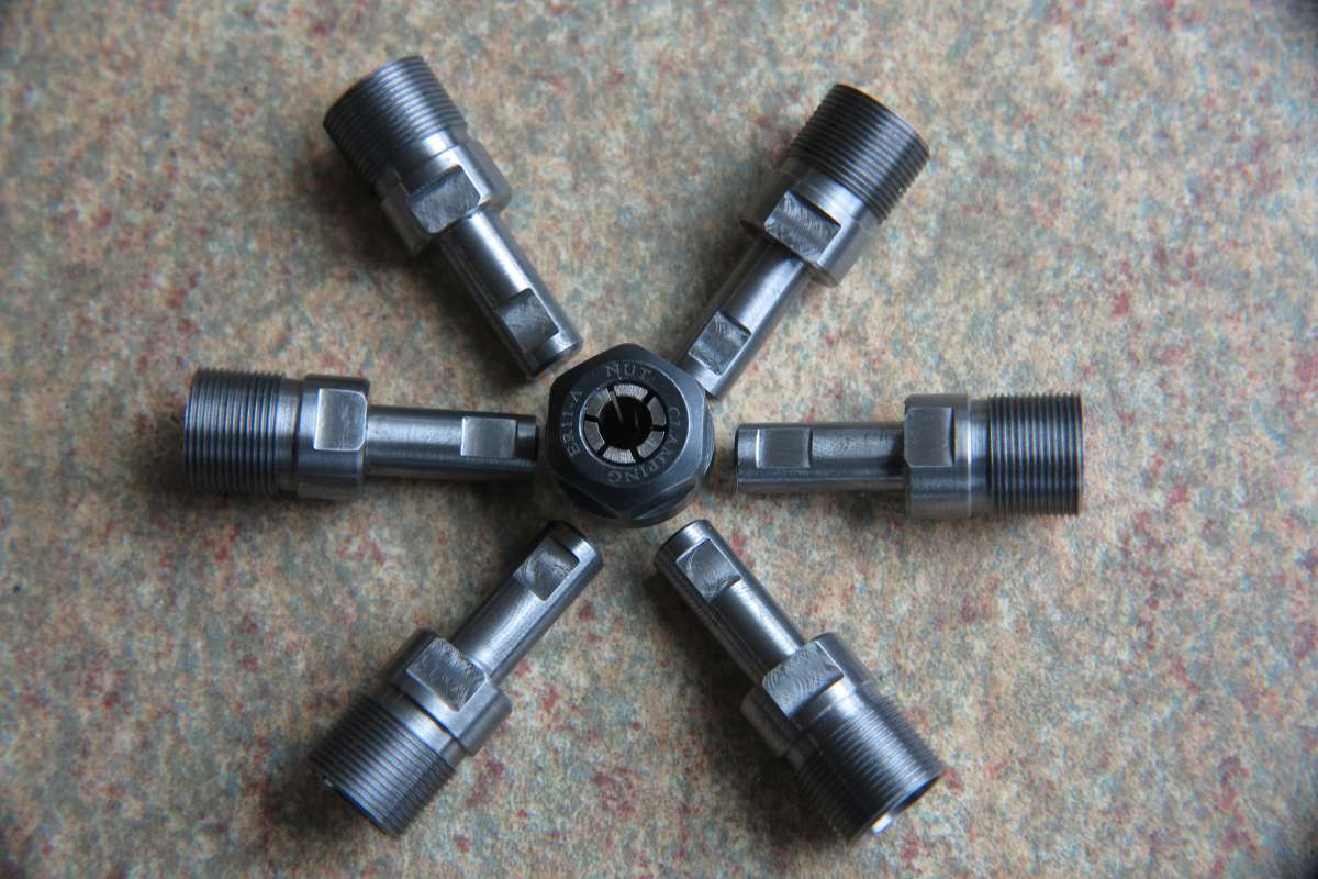

        I have two tailstock turrets and find that drill chucks get in the way a lot of the time. One of mine has ER16 collet chucks instead and gives you a lot more room.IMG_5950IMG_5945

          I like Bernard’s ER collet set up. And they are cheap enough to buy these days, if you don’t want the top-of the-line micron-chaser quality ones.

                Hopper the collet chucks where homemade.
